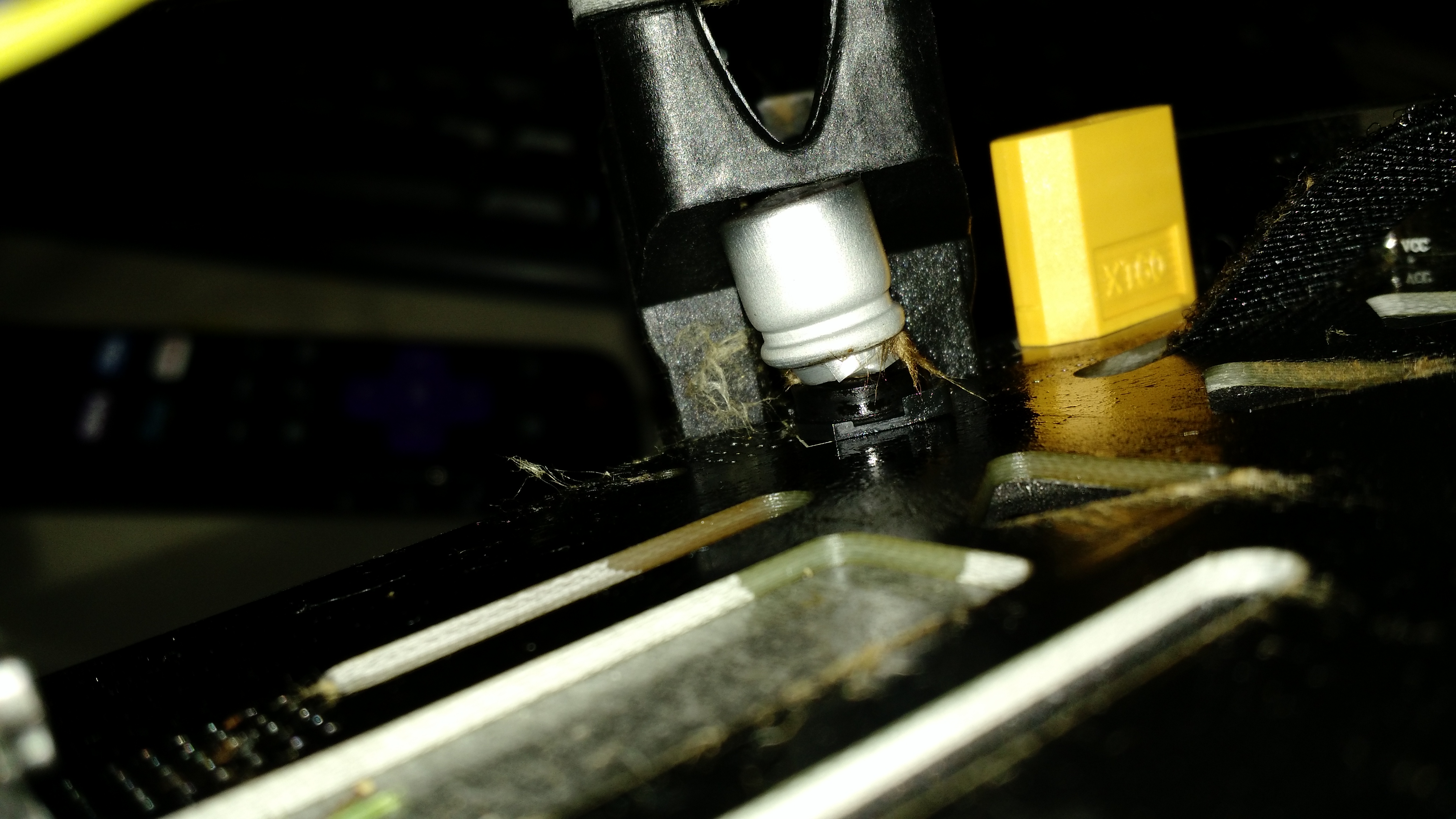

G+_Omega Nine Posted April 4, 2016 Share Posted April 4, 2016 Cap on echine 250 racer exploded mid air. Thought someone shot it out of the sky at first. Body survived the fall quite well though. Link to comment Share on other sites More sharing options...
G+_610GARAGE Posted April 4, 2016 Share Posted April 4, 2016 Thats a new one. They usually vent out the top, like there designed. Ahh, quality control. :) Link to comment Share on other sites More sharing options...

G+_Omega Nine Posted April 4, 2016 Author Share Posted April 4, 2016 Yeah, was not even punching it hard. Just exploded (loudly) then went out on control in a spin. When I cut power its flipped a few times before hitting the ground, seems to be only damage. Might just replace all the caps on it. Link to comment Share on other sites More sharing options...

G+_Brian “Yikesfpv” Gipe Posted April 6, 2016 Share Posted April 6, 2016 Capacitor? Part of the PDB? Link to comment Share on other sites More sharing options...
G+_Omega Nine Posted April 6, 2016 Author Share Posted April 6, 2016 Not sure what a PDB is (Program Database to me) but the bottom half of the main body is a PCB (Printed Circuit Board). It has four capacitors (one for each ESC) soldered to it. I am guessing it was poorly soldered and a leg came free causing it to overload in the air. I picked up another bottom part, after waiting like 5 days for a response to the RMA I just gave up. Link to comment Share on other sites More sharing options...
