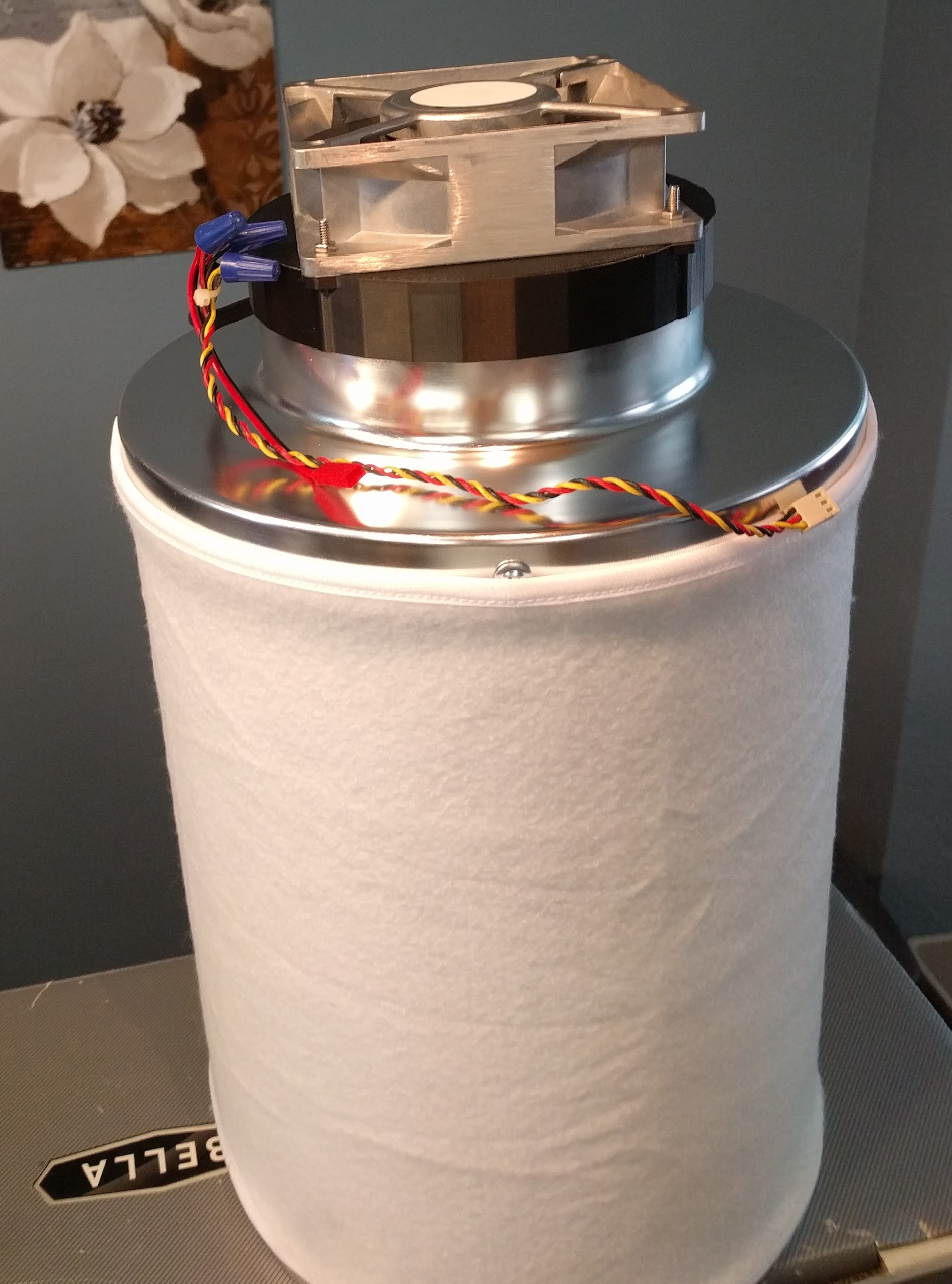

This is a 120mm to 6 " duct fan adapter inspired by the 4 " one from KH224
G+_Stede Bonnett
This is a 120mm to 6" duct fan adapter inspired by the 4" one from KH224.
https://twit.tv/shows/know-how/episodes/224?autostart=false
It fits on the 6" version of the filter linked from the episode. This is actually my first attempt to use tinkercad, and there was one minor alignment issue with the fan holes (they were mysteriously out-of-place by 0.39mm) that is fixed in the file now:
https://tinkercad.com/things/6fEIuDhbPiS
The upper spherical duct can still be used with a second fan, of course. I am also going to make a version for the 140mm Noctua NF-P-style fans (which use the same hole spacing as a 120mm fan) once I figure out how to get a good seal around it.
Shown here with a 120x38mm Panaflo L1A
