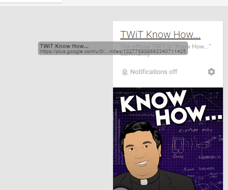

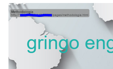

G+_Darryl Gibbs Posted November 10, 2015 Share Posted November 10, 2015 Hi guys! I'm running my website from my Rasp Pi2 at home, and I was wondering if I can get some assistance with hiding my IP. Sorry that I'm not sure exactly how to phrase this question, but hopefully the 2 pictures below would help. I noticed (by accident) that if I tried dragging a web link on my page (see pic1), that it shows the server IP address (i.e. my home IP), but if I did the same on G+, it shows the plus.google domain name (pic2). How could I do that for my own site? Have the doman name in place of the actual IP? Thanks!! Link to comment Share on other sites More sharing options...
G+_610GARAGE Posted November 10, 2015 Share Posted November 10, 2015 If I understand you correctly, you would like to send people to your web server, without giving out the address of your house. If that is correct, then you can't, really. People need to know your address to get to the pi server. Since you are running your pi at your house, there's no real practical way (that I know of anyway) to send people to your pi website without giving out your ip. This is why its generally not a good idea to run public web pages from your house. The g+ url is just for tracking. So if someone goes to my website via g+, I would be able to figure out exactly what the clicked on by viewing the referral link. The g+ link, simply redirects the user to your ip address. Link to comment Share on other sites More sharing options...
G+_Darryl Gibbs Posted November 10, 2015 Author Share Posted November 10, 2015 610bob so the fact that I have an actual www.xxxx.com web address/domain won't help in hiding my IP? I guess in a way its a good thing that the IP changes periodically and that I have to manually update it, should someone want to do something harmful Link to comment Share on other sites More sharing options...
G+_610GARAGE Posted November 10, 2015 Share Posted November 10, 2015 Darryl Gibbs You are correct. Computers go off of ip address (for the most part). A DNS changes a url to an ip address that your computer can use to find the server. If you open up a terminal or command prompt, and ping google.com, it will tell you the ip address that google resolves too. There is also various websites that will do this too. Link to comment Share on other sites More sharing options...
