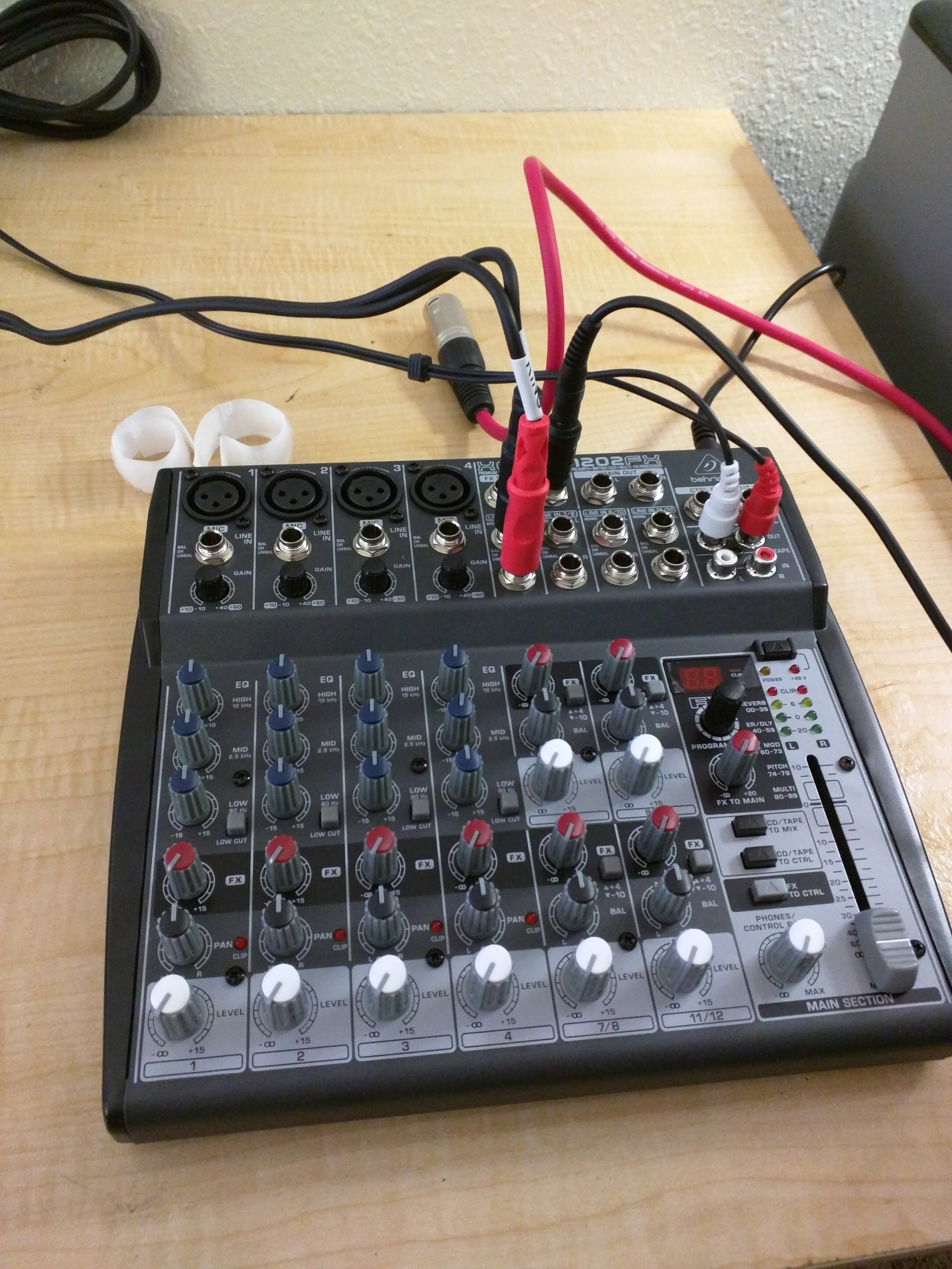

G+_Walker Hymes Posted August 16, 2016 Share Posted August 16, 2016 Hey Know How group. I'm looking at getting into pod casting and have purchased pretty much everything I need. The only issue that I have ran into though is that when I try to record on my mic I have to turn the gain all the way up. Like ALL THE WAY. It will then barely register on lights on the right of my mixer and I have yet to have the clip light light up on my mixer even when I yell or clap right in front of the mic. The main issue is that there is an extremely annoying hiss when the gain is up that high. The hiss only appears when the mic is powered on and gain is high. I got a 6 pack of GLS XLR cables and have tried 3 different ones thinking it might be the cable but it still persists. I have tried plugging it into mic 1 and 2 on my mixer. Same thing. So this leads me to believe that it is the mic (it is a condenser mic and yes it is getting phantom power from the mixer) . It is a cheap mic off of amazon ( https://www.amazon.com/gp/product/B00Q4RGQHY/ref=oh_aui_detailpage_o00_s02?ie=UTF8&psc=1) but before I go buy a more expensive mic I want to make sure that this is what the issue is. Does anyone have any experience with this mic or other cheap mics? If I were to run the mic into a separate preamp, then to the mixer would that work? I also don't believe that it would be room noise...but maybe? Below is my setup. Floureon BM-800 Condenser Sound Studio Recording Broadcasting Microphone + Shock Mount Holder Behringer Xenyx 1202fx Mixer BEHRINGER U-CONTROL UCA222 converter GLS Audio 6ft Patch Cable Cords Link to comment Share on other sites More sharing options...

G+_Stede Bonnett Posted August 16, 2016 Share Posted August 16, 2016 With most condensers the output is really hot - my SP B3's have a low-cut and -10dB pad so they don't overcook the inputs in high SPL. If you are yelling and not overloading the input - something is wrong. After reading Robert Gauld's comment I noticed you can see the mic capsule through the screen in the photo so I found a teardown on YouTube and this is definitely a unidirectional cardioid side-address microphone. As with most of this type you face the side with all the logos toward you. I assume your mixers phantom power was turned on for testing (and that you correctly don't leave it on when you are plugging things in/out of the XLRs; I assume this because it is off in your photo). It could be your cable - if pin 2 (or 3) isn't connected you won't get phantom power and your unpowered gain will also be cut in half. You could poke the cable with a multitester to verify. Link to comment Share on other sites More sharing options...

G+_Walker Hymes Posted August 16, 2016 Author Share Posted August 16, 2016 Phantom power is on. Link to comment Share on other sites More sharing options...
