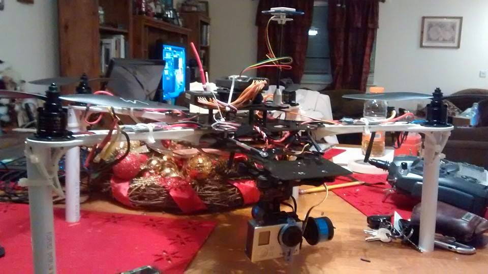

Here is my setup
G+_Conan Mills
10599638_10202301466777879_4539558090012
Here is my setup. HK deadcat 450 with an APM 2.5 running sunnysky 980 Kv motors, swinging 10 X 4.5 props. The gimbal is a Tarot T-2D that I got for Christmas and the thing worked right out of the box. :) Its a bit on the heavy side now at about 2000 grams so I will likely have to upgrade the motors to some lower Kv motors.
