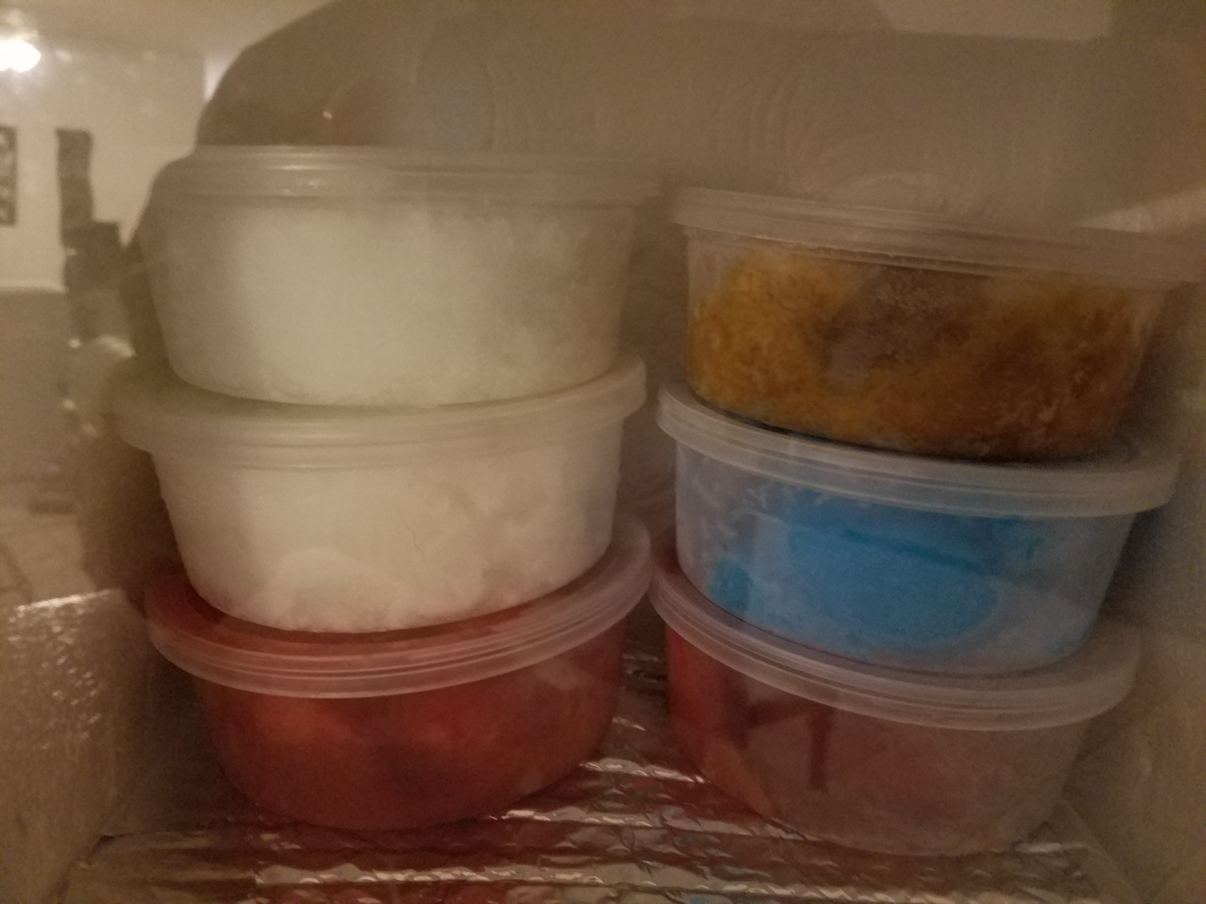

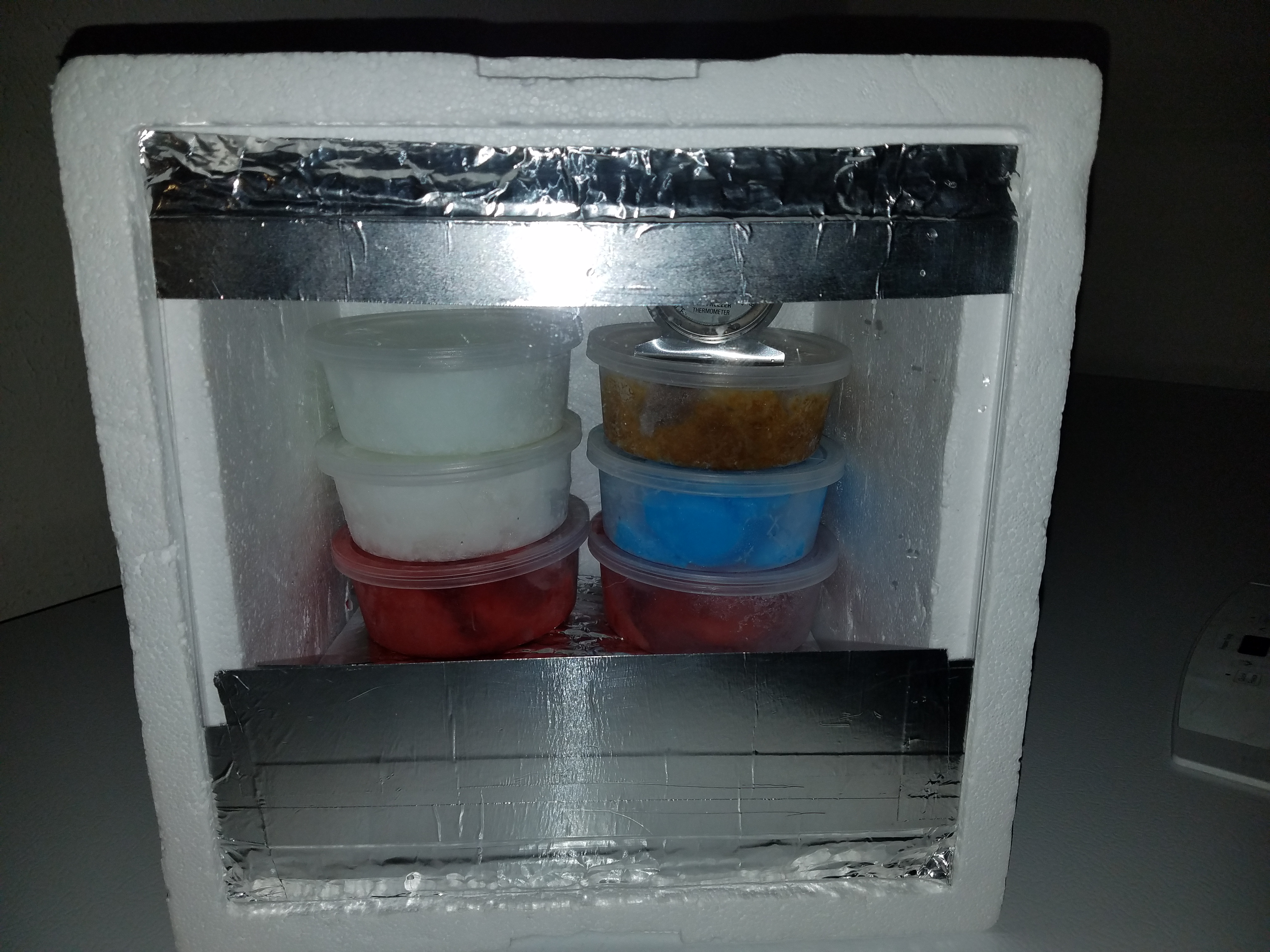

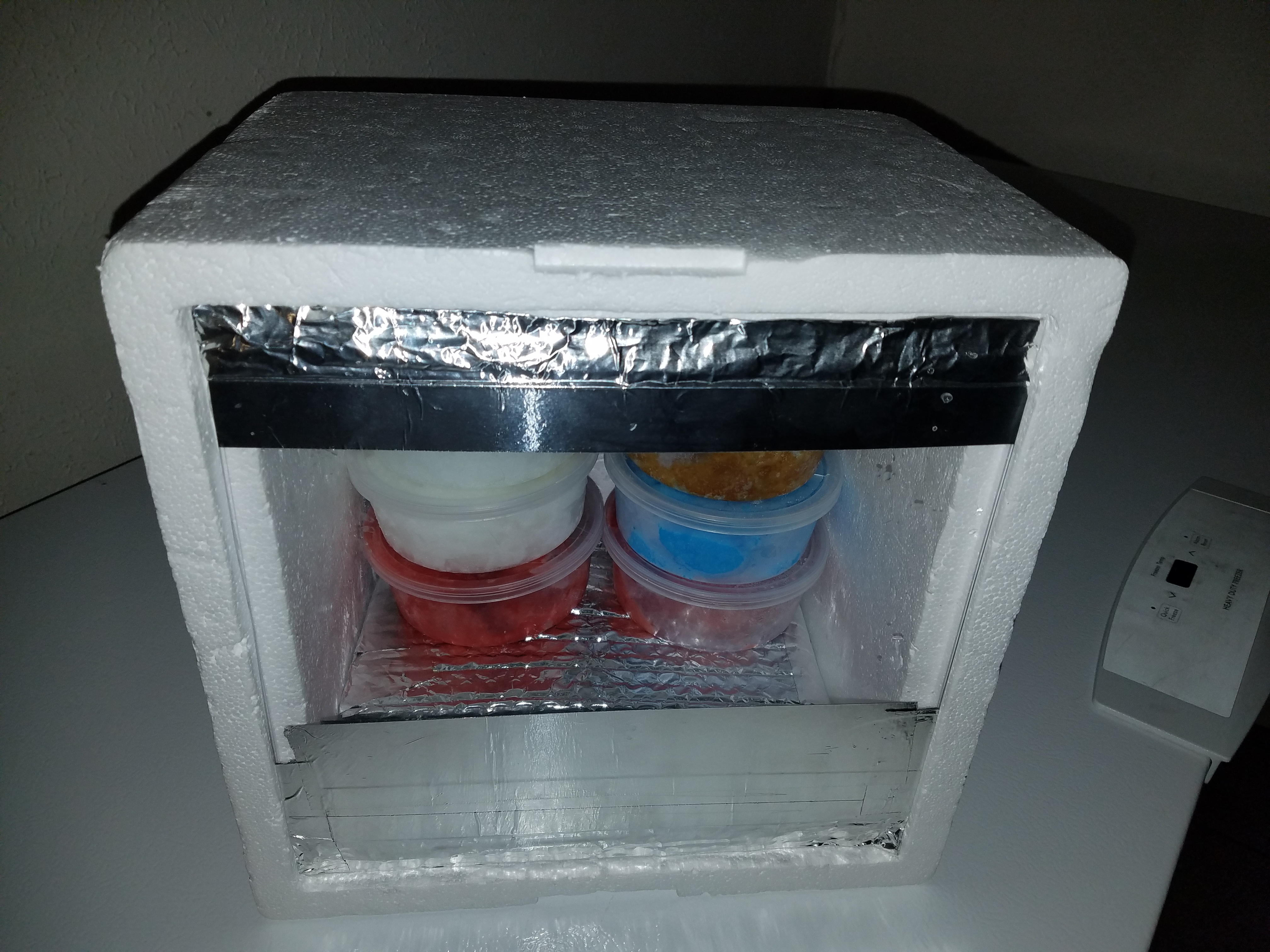

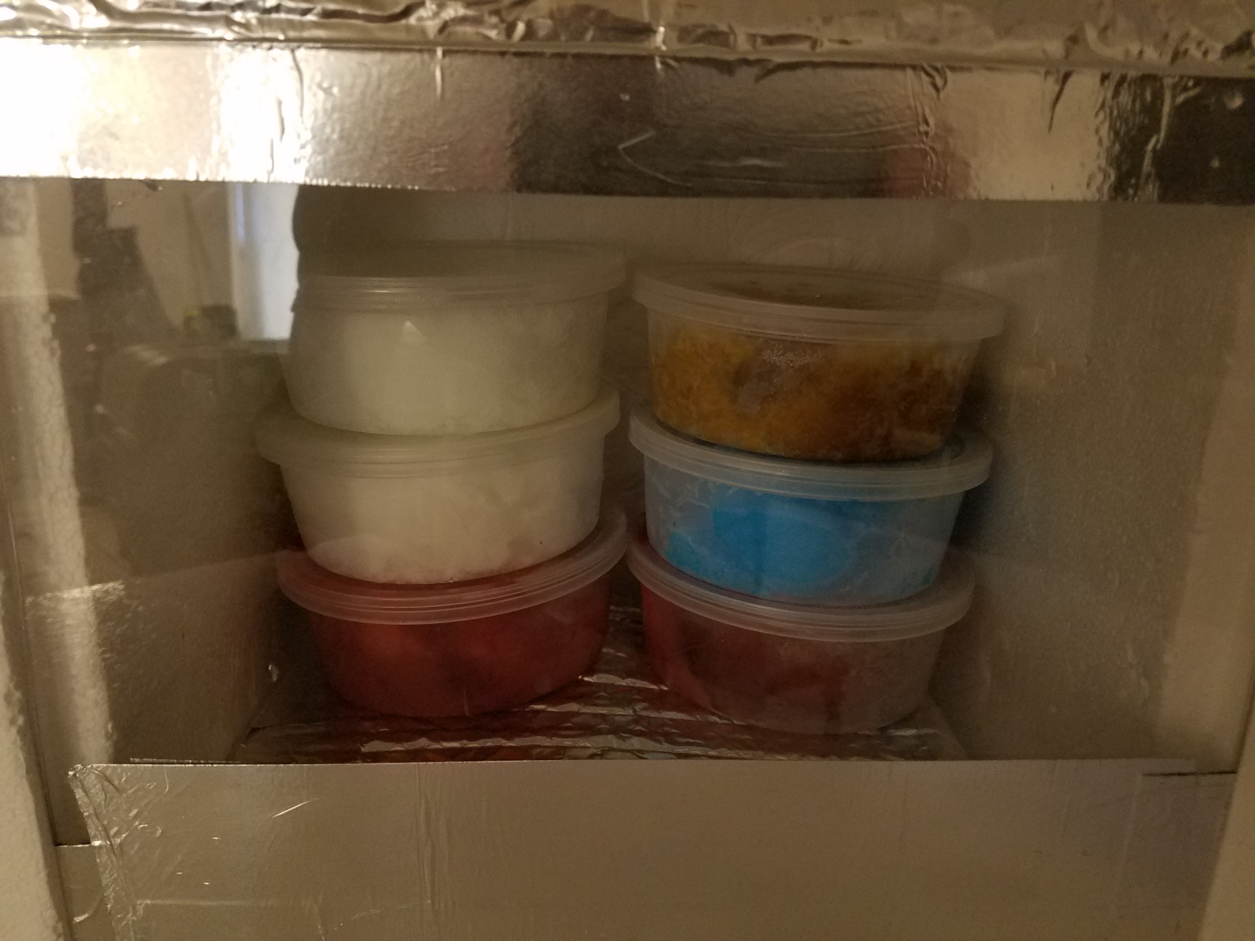

G+_Hector Sotomayor Posted September 19, 2016 Share Posted September 19, 2016 Need tips to improve my homemade cooler. The styrofoam enclosure has dry ice inside with a Plexi door where R 7 insulation around the edges to keep the cold air in. This is my prototype my next one will be a lot prettier Link to comment Share on other sites More sharing options...
G+_Robert Hafer Posted September 19, 2016 Share Posted September 19, 2016 Maybe double pane the plexi door with an air gap for better insulation. How cold does the outside of the door get? Link to comment Share on other sites More sharing options...
G+_Damien Wessling Posted September 19, 2016 Share Posted September 19, 2016 Robert Hafer read my mind, I was thinking the same on the double glazing. Link to comment Share on other sites More sharing options...
G+_Eddie Foy Posted September 19, 2016 Share Posted September 19, 2016 DITCH! the plexi door!!! tape some masking tape that has been colored black via sharpie on different spots and see with a IR temp gun (or thermal cam if ya got on) and see where its lacking. double glazing it won't help that much if its just air between. Link to comment Share on other sites More sharing options...
