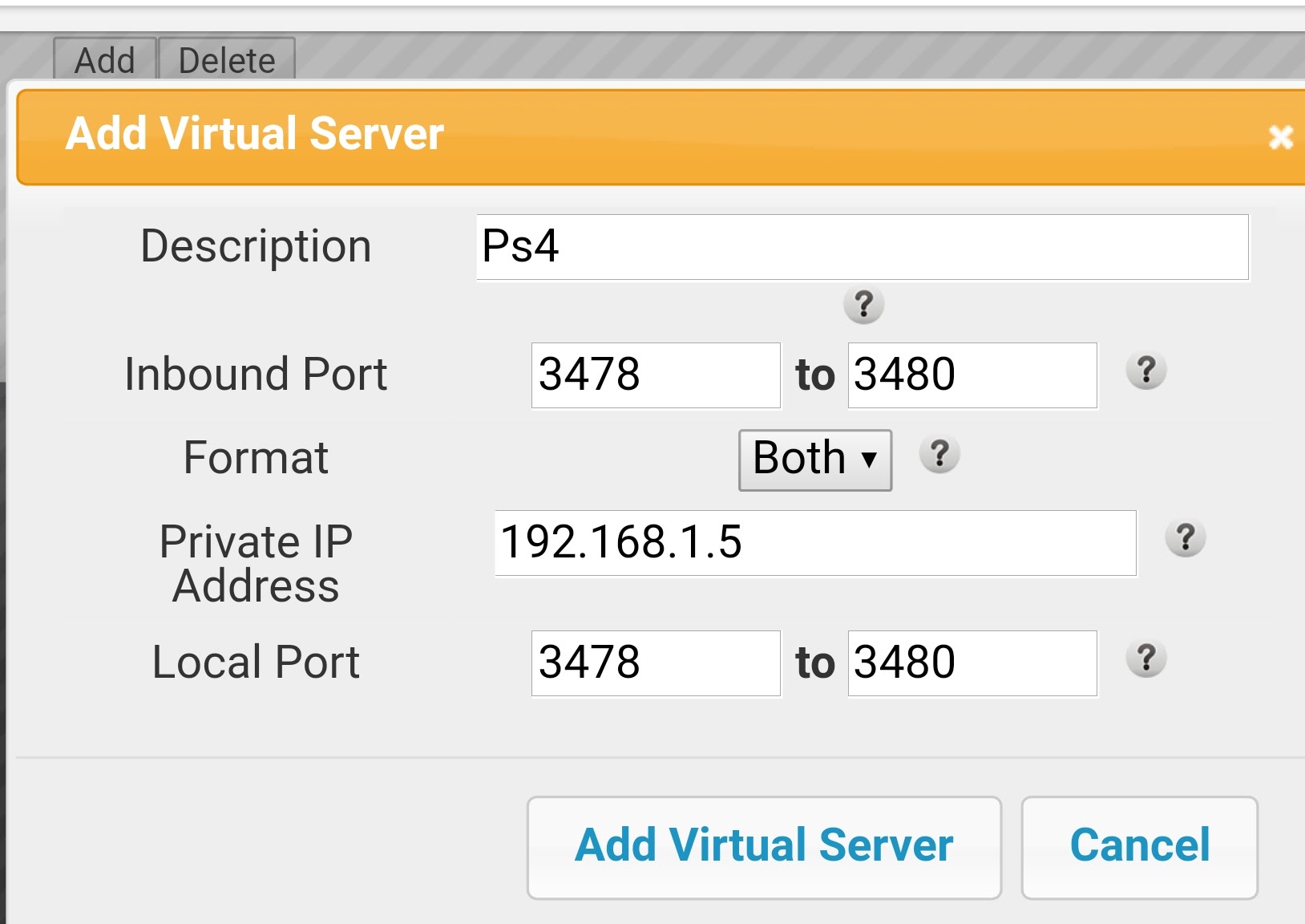

G+_Rich Mclean Posted August 24, 2017 Share Posted August 24, 2017 We have a PS4 we want to setup, I don't want to turn on UpnP, is there a way to go around this and still get the experience of playing online. I've read I can open some ports but I'm always been hesitant of messing around with the router's advance settings. ISP is Spectrum ( not sure if this makes a difference or not). Any step by step instructions I can use will be very much appreciated. TY Link to comment Share on other sites More sharing options...

G+_Ben Reese Posted August 24, 2017 Share Posted August 24, 2017 Portforward.com is a great resource for knowing what ports applications or devices need. They also have instructions for most popular routers. https://portforward.com/networking/static-ip-ps4/default.htm You'll want to start with a static IP on the PS4 - one outside of your DHCP range. The ports they have listed are... TCP: 80, 443, 1935, 3478-3480 UDP: 3478-3479 Honestly, the 80 and 443 seem odd to me. I'd try it without those first. And I was just reading on a forum that some games may require additional ports, but those should be easy enough to add later if needed. Link to comment Share on other sites More sharing options...

G+_Rich Mclean Posted August 27, 2017 Author Share Posted August 27, 2017 Is it better to do a port forwarding or DMZ in terms a security? Link to comment Share on other sites More sharing options...
G+_Ben Reese Posted August 27, 2017 Share Posted August 27, 2017 Rich Mclean port forwarding is safer. DMZ tells the router to send all unknown traffic to that device. So, even though your PS4 may not have an SMB file server running, you're still sending inbound traffic on port 445 to the PS4's IP. If for some reason an unpatched Windows 7 machine grabs that IP and is running Windows file and print sharing, you'd get hit with Wanna Cry. With port forwarding, you'd only be at risk if that Windows 7 machine was running a web server (unlikely) or some other service on 3478-3480. DMZ is good for small tests where you know there's little risk (and you're ok with the risk). Link to comment Share on other sites More sharing options...
