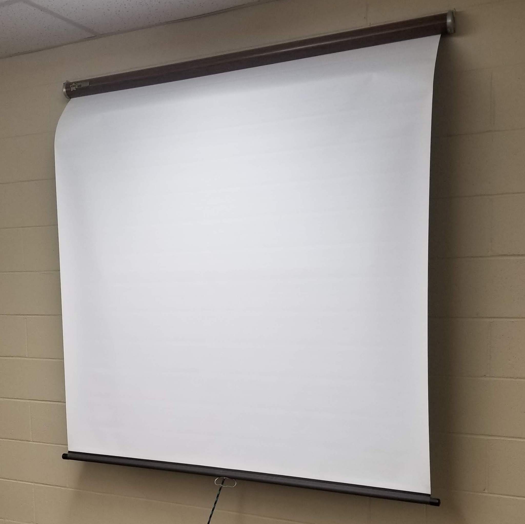

G+_Ben Reese Posted February 10, 2019 Share Posted February 10, 2019 Most TV mounts I've seen have some sort of tilt. And if they don't tilt for normal viewing, you can usually loosen a screw and tilt the bottom out for installation. This is what we got for mounting 2 x 70" TVs and a 50". They don't fit completely flat on the wall, but hold out about 3". The 70" TVs are pulled out and turned about 30°. The 50" is pushed back against the wall. https://www.samsclub.com/sams/omnimount-extended-full-motion-lg-television-mount/prod22271048.ip This is a picture of the projector screen over the front of the 50" TV. Link to comment Share on other sites More sharing options...
