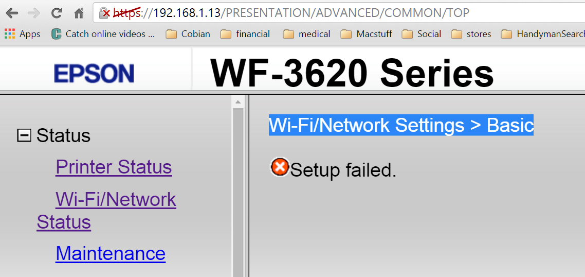

G+_Rud Dog Posted October 25, 2015 Share Posted October 25, 2015 Pic for printer not working. Link to comment Share on other sites More sharing options...
G+_Jason Marsh Posted October 26, 2015 Share Posted October 26, 2015 Hmmm, so it fails network setup but has address and serves web admin page... Is there vomitus on the ceiling? Link to comment Share on other sites More sharing options...
G+_Akira Yamanita Posted October 26, 2015 Share Posted October 26, 2015 I checked out the manual and it looks like either something that shouldn't have been turned on (such as IPsec, secure IPP, or 802.1X) was turned on or the certificate expired. Link to comment Share on other sites More sharing options...
G+_Jason Marsh Posted October 26, 2015 Share Posted October 26, 2015 I've seen invalid certs because of system time getting reset. Can you check that the time and date on the devices are correct? This would be for both the printer and the client you're accessing the printer from. If the date is correct, I'd reset to factory defaults and go back through the hassle of reconfiguring it. Link to comment Share on other sites More sharing options...
G+_Rud Dog Posted October 26, 2015 Author Share Posted October 26, 2015 Jason Marsh it only serves up the "web admin" page when I connect via WiFi other wise can't access the printer. Link to comment Share on other sites More sharing options...
G+_Rud Dog Posted October 26, 2015 Author Share Posted October 26, 2015 Akira Yamanita Did not realize my printer used HTTPS till it failed in fact don't think it did but can't be sure only because when it is working it gets no oil. It is hard to believe they assigned any type of security to the printer is this common? I mean would they assign a cert to a printer and if so why have such a short span in time as I am sure most consumers know nothing about certs and how to work with them. A bit puzzling> Link to comment Share on other sites More sharing options...
G+_Rud Dog Posted October 26, 2015 Author Share Posted October 26, 2015 Jason Marsh So you are of the camp there is a cert on my printer and somehow my date was corrupted and the cert time length time was beyond the expiration. Which prompts the question; are certs expiration based on a date in the future or timer in days or years? Also if the cert is the culprit does it not also apply to the Wifi connection or does it have its own cert and if so what date format does it use? Link to comment Share on other sites More sharing options...
G+_Jason Marsh Posted October 26, 2015 Share Posted October 26, 2015 The cert wouldn't be generated by your printer, but if system time was way out of sync you could have cert issues. It seems something is corrupted in the config or the firmware. I saw your other post, and it appears you've reset the config. Have you tried updating the firmware? This also might sound crazy, but what happens if you use a different browser to interact with the admin pages for the printer? I've had a NAS and a print server that didn't play well with Chrome, so I used IE for them and everything was fine. Link to comment Share on other sites More sharing options...
G+_Rud Dog Posted October 26, 2015 Author Share Posted October 26, 2015 The crazy approach is sometimes helpful but in this case using Firefox instead of chrome still got me the same warning. 192.168.1.13 uses an invalid security certificate. The certificate is not trusted because it is self-signed. The certificate is only valid for the following names: 192.168.0.2, 192.168.0.2, EPSOND400E6.local., EPSOND400E6 (Error code: sec_error_unknown_issuer) BTW on the website for drivers this Epson400E6 is shown to be good for the printer I have in case you notice the pic having a different name. Next stop firmware. Link to comment Share on other sites More sharing options...
G+_Rud Dog Posted October 26, 2015 Author Share Posted October 26, 2015 PS Date and time check out ok on both the printer and PC. Link to comment Share on other sites More sharing options...
G+_Jason Marsh Posted October 26, 2015 Share Posted October 26, 2015 Hmmm.. Self-signed.. So maybe the printer does generate the cert. It looks like the cert may have been generated when the device was on a different subnet than where it now lives. (was 192.168.0.x, now it's 192.168.1.x) If you change the device/netbios name will that cause it to generate a new cert? The admin guide points out that javascript should be enabled in your browser in order to setup HTTPS/SSL access; is it? Link to comment Share on other sites More sharing options...
G+_Jason Marsh Posted October 26, 2015 Share Posted October 26, 2015 Pages 13 + 14 of this may reveal something... https://files.support.epson.com/docid/cpd4/cpd41038.pdf Link to comment Share on other sites More sharing options...
G+_Jason Marsh Posted October 26, 2015 Share Posted October 26, 2015 See "Using a Digital Certificate" on page 30 through "Updating a Self-signed Certificate" on page 34. Whatever's broke, it's right there. Link to comment Share on other sites More sharing options...
G+_Rud Dog Posted October 26, 2015 Author Share Posted October 26, 2015 Well finally got through to Tech Support and an hour later we are good to go. Someone nailed it apparently some how some way the printer was placed in WiFi mode and this disables Wired ethernet port connection. If someone is reading this and has the same problem be aware disabling the WiFi is rather obscure. Press the wifi icon in the upper right hand corner of the display on your printer. Then select wifi/network settings From there find the setting stating disable wifi. One that was done all was well in printing land. The one thing they could not help me with was the privacy error I am still getting on my browser screen when attempting to connect to my printer. Tech Support suggested I contact google. Link to comment Share on other sites More sharing options...
