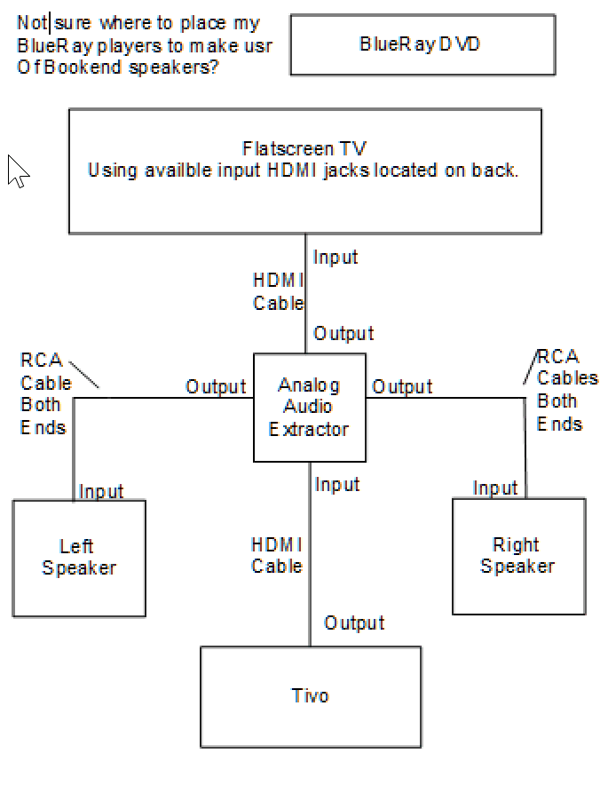

G+_Rud Dog Posted March 24, 2016 Share Posted March 24, 2016 After checking out what was available bumped into the J-Tech Digital ® Premium Quality 1080P HDMI To HDMI + Audio (SPDIF + RCA Stereo) Audio Extractor Converter . Decided to rethink my configuration but then was left with what do I do with the BlueRay player and does the extractor have enough power to drive bookend pseak Link to comment Share on other sites More sharing options...
G+_Rud Dog Posted March 24, 2016 Author Share Posted March 24, 2016 Clarification only one Blu Ray player not players as shown on the drawing. Link to comment Share on other sites More sharing options...
G+_Travis Hershberger Posted March 24, 2016 Share Posted March 24, 2016 You'd need another amp as most "audio extractor" won't have one built in, just a line out. Much simpler just to grab a home theater amp that has hdmi switching built in. Link to comment Share on other sites More sharing options...
G+_Rud Dog Posted March 24, 2016 Author Share Posted March 24, 2016 Travis Hershberger thank you. I agree but my other half absolutely does not want another box in the area where the TV is located. So if I could "hide" as in the small size of the extractor it might be feasible. Now it appears I will have to add a small amp as suggested in my first post, by member of the community.(Sorry forgot who suggested it) Now to find the dimensions of the amp and extractor. Are there no engineers with wife's that have this this requirement surely it exists. Till then off to find the dimensions of the extractor and mini amp. Link to comment Share on other sites More sharing options...
G+_Reed Hanson Posted March 24, 2016 Share Posted March 24, 2016 Is this something, that would help your situation? http://www.crutchfield.com/p_772D2/Audioengine-D2.html?tp=59309 Would still need an amp to power your speakers, but the amp could be put someplace out of sight. Link to comment Share on other sites More sharing options...
