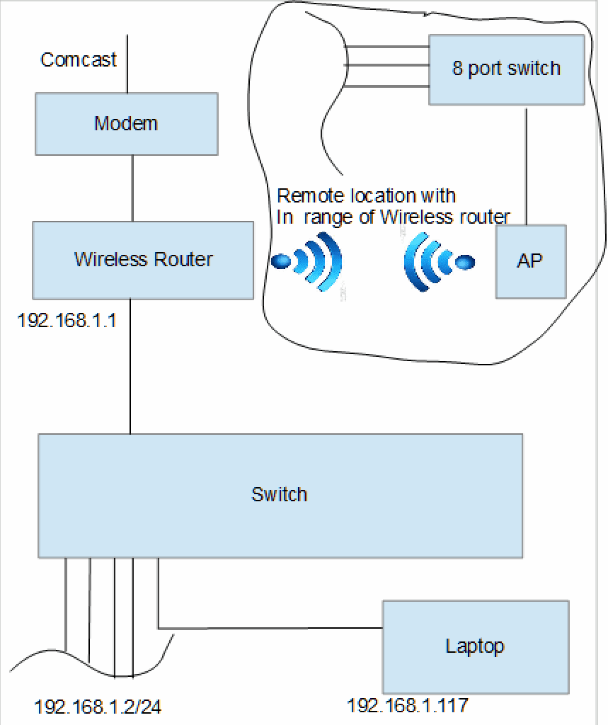

G+_Rud Dog Posted April 10, 2016 Share Posted April 10, 2016 Would like to take an older wireless router and add it to my existing LAN as an extension the kicker is via wireless. The diagram is in place with the exception of the circled portion. How would I set this up? Link to comment Share on other sites More sharing options...
G+_Ben Reese Posted April 10, 2016 Share Posted April 10, 2016 The client AP/router has to support repeater bridge mode. If it does, the actual setup will depend on the routers firmware. On DD-WRT you give it the same SSID and password as the host AP then set it to I think repeater/bridge mode. Link to comment Share on other sites More sharing options...
G+_Josiah Gross Posted April 11, 2016 Share Posted April 11, 2016 Flashing the old router DD-WRT would be the way to go - https://www.dd-wrt.com/wiki/index.php/Repeater_Bridge Link to comment Share on other sites More sharing options...
G+_E. Matt Armstrong Posted April 11, 2016 Share Posted April 11, 2016 Depends on firmware options. I have a router that has client mode, which turns the off the AP and SSID, so it is just an Ethernet to Wi-Fi adapter. I had to then use another router connected to it to be the remote AP. You could also use a computer with a Wi-Fi card and share the connection over to your remote 8 port switch if everything will be wired in the remote location. Link to comment Share on other sites More sharing options...

G+_Rud Dog Posted April 17, 2016 Author Share Posted April 17, 2016 If I decided to buy a turn key solution what would this addition be called, this would help my google search efforts. As it stands the wireless signal from my Asus reaches the remote location. Would like to take that wireless signal and have a remote wireless AP pick it up. The remote wireless AP would then have an ethernet cable between it and an 8 port switch. This would allow for attaching wired devices to the local lan via the remote wireless LAN extension. Link to comment Share on other sites More sharing options...
G+_Ben Reese Posted April 17, 2016 Share Posted April 17, 2016 I think in other discussions some have recommended power line Ethernet adapters and that would most likely give more bandwidth and should still work with your setup. If you want to stick with wireless, many APs will have repeater/bridge functionality built in. It really just depends on your price range. I've got this TP-Link AP: http://www.amazon.com/TP-LINK-TL-WA901ND-Wireless-300Mbps-Repeater/dp/B002YETVXC. It works well most of the time, is PoE, and < $50. It's options that might work for you are Client, Repeater, and Bridge+AP. I've also got experience with these Ubiquiti APs: http://www.amazon.com/Ubiquiti-Networks-Enterprise-AP-Unifi/dp/B00HXT8R2O. I'm pretty sure it has client or bridge mode, but it's not on my home network so I can't check right now. Then there are also complete wireless routers with DD-WRT pre-installed. Buffalo is the brand that comes to mind - though there may be others. This is the one I have setup at Church and it has been running strong for almost 3 years: http://www.amazon.com/Buffalo-AirStation-HighPower-Wireless-WZR-600DHP/dp/B0096239G0 As for powerline adapters, I have no experience to speak from, but here's Amazon's "Best Seller": http://www.amazon.com/TP-LINK-TL-PA4010KIT-Powerline-Adapter-Starter/dp/B00AWRUICG. Other's here may have better recommendations and your mileage may vary. One thing that I noticed first thing was the 128-bit AES encryption, so that's good. Hopefully this gives some basis for your research :-) Link to comment Share on other sites More sharing options...
