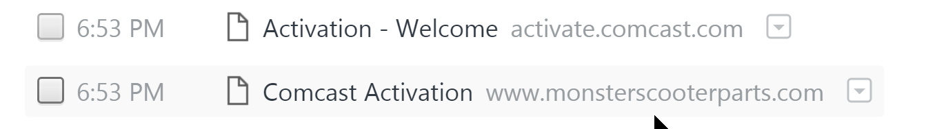

G+_Rud Dog Posted August 29, 2016 Share Posted August 29, 2016 FYI A new anomaly to share with you. Yesterday swapped my Infinity router/modem with my Linksys modem and Asus router. Started up a chat from within my login to my Comcast account and from there was given a link to visit to learn the steps needed to carry out the change over. Also was given a phone number to call as well. Did both and was walked through the steps for swapping out my equipment and since there didn't seem to be any reason for keeping the Comcast/Infinity web site open I closed it. All went as expected switch over was flawless. Then started getting the following link after I clicked on random searches returned by Google. For example was looking up batteries and every once in while the link in question would be substituted with the Xfinity link and that page would show up instead of the link for batteries. This is the link. https://activate.comcast.com/RoutingEngine/accountlookup.do Now thought at first it was just a problem in the link so decided to clear my cache. All was fine then while googling motors one of the google supplied links took me to the link above instead of the link for motors. Checked my history and indeed the link shown above was back and in one case it had combined the url with the motor url but the Comcast/Infinity link was followed. Snapped a pic of the history listing and the website. It seems even after rebooting this remains. Ran Malware-bytes and AV and it still shows up from time to time. Just so's you all know and comment if you have ever experience this. Link to comment Share on other sites More sharing options...

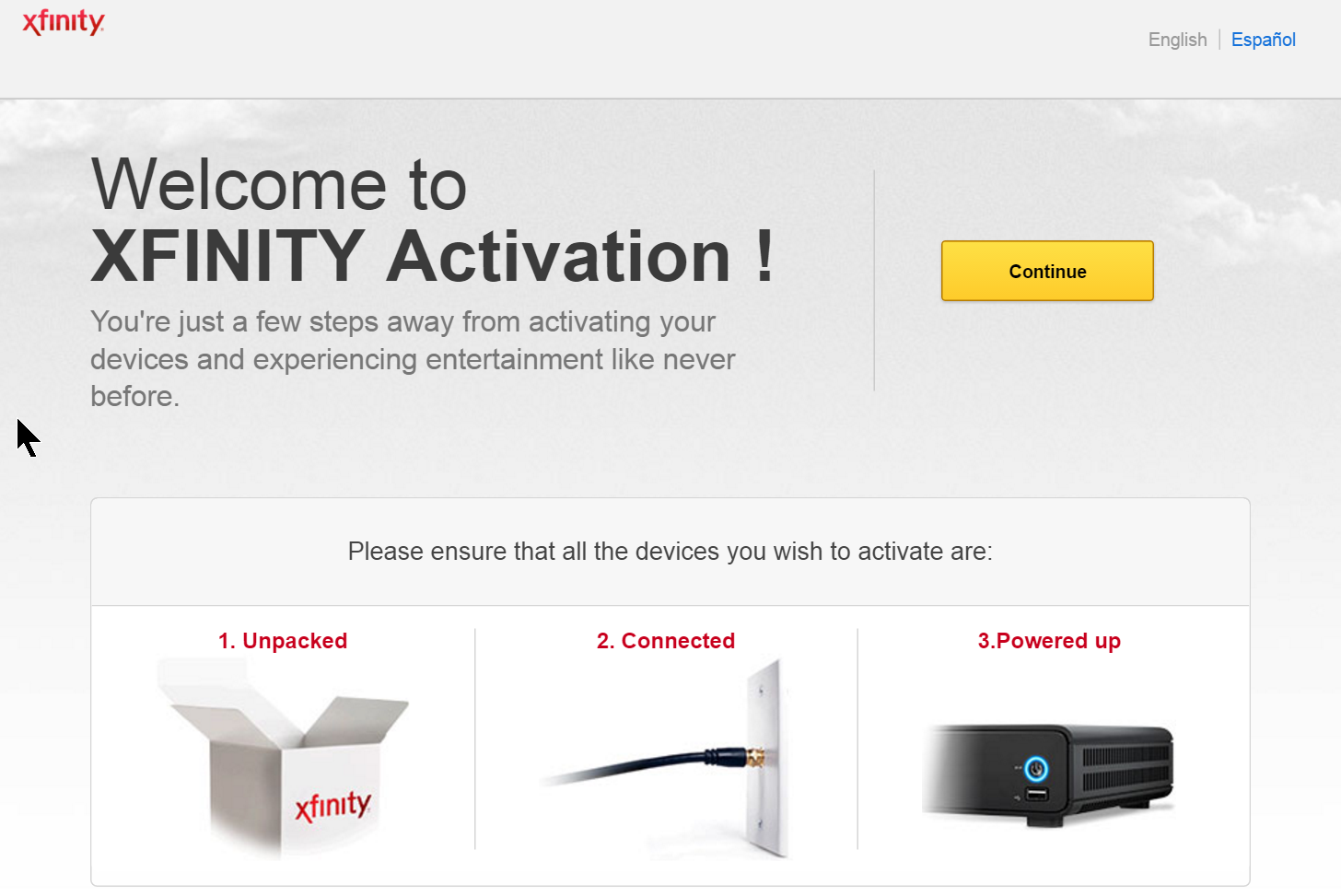

G+_Rud Dog Posted August 29, 2016 Author Share Posted August 29, 2016 Thank you Ben this has been resolved. Hate being forced to do something on my computer by anything not me! But after flushing everything including both toilets in the house decided to give in. (also tried google's DNS servers) The call I made to Comcast for the initial switch over from their modem/router to my Asus router and lInksys modem, went flawlessly and I had complete Internet access. But as mentioned there were google searches when selected would bring back a message from Comcast rather from the intended selected item. As I trouble shot this problem it got worse, came down to every thing I typed, the browser would come back with that annoying comcast url website. So I caved in and followed the Comcastazi instructions to the end and that got rid of the nightmare that was Comcast. If only the Comcast Tech had told me this but as we all know it rolls down hill. Again thank you for your suggestions and help now back to the motor, battery and other fun projects. Link to comment Share on other sites More sharing options...

G+_Rud Dog Posted September 2, 2016 Author Share Posted September 2, 2016 Steve Martin Hey Steve, sorry for the confusion. One of the pictures uploaded shows a screen with a 'Continue' button this screen is impossible to eliminate once you begin the process which is initiated when Tech support instructs you to go the url in question. That button is the key to getting rid of the annoyance described in my earlier posts. It is Comcasts way of capturing and controlling your browsing till you follow the steps on that webpage. Which is odd due to the fact the switch over was carried out over the phone and completed it was not till later the problem started to confuse the hell out of me. So if you or anyone else decided to switch over to your own equipment and witness the screens shown the simple fix if to follow the steps in the screen shots provided. Link to comment Share on other sites More sharing options...
