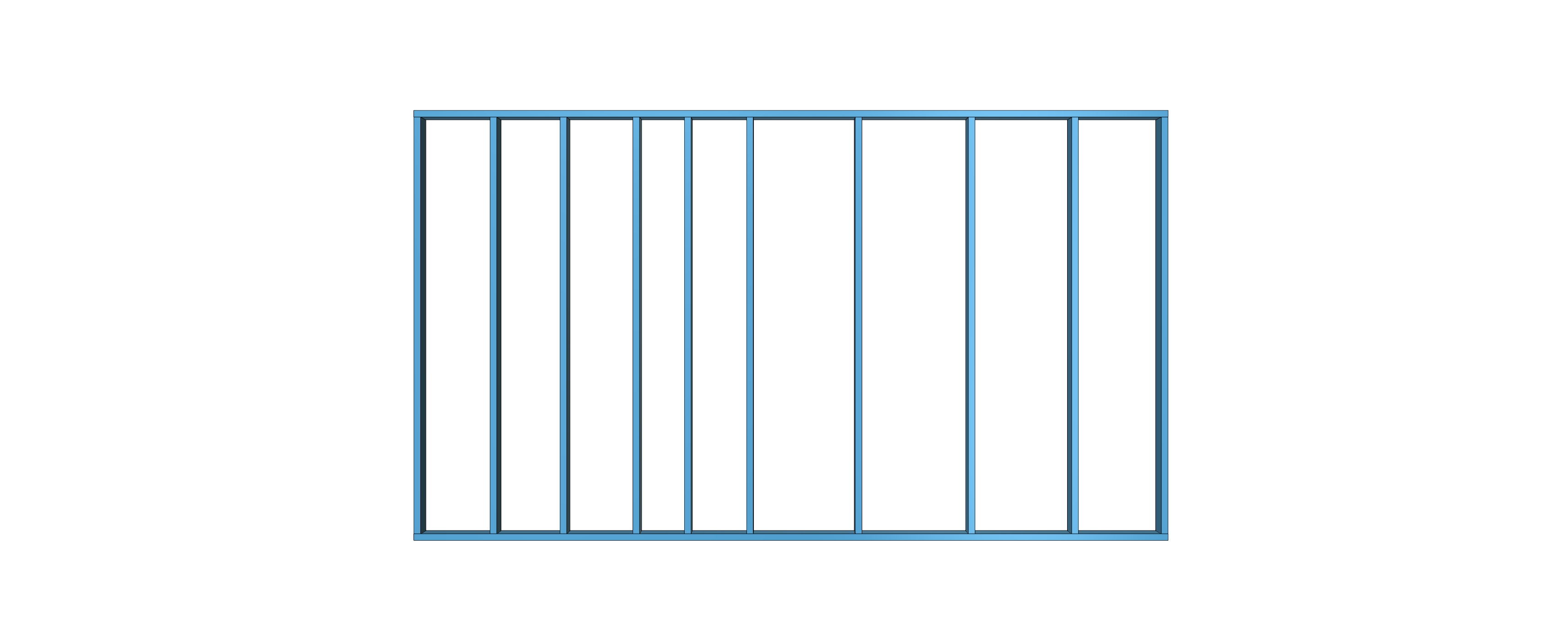

G+_Rud Dog Posted October 21, 2016 Share Posted October 21, 2016 Well started off with a simple project involving mounting our 55" Samsung flatscreen on the wall. First step was to locate the studs in the wall, all done and funny how they are not 16 inch on center. Second locate bracket online and get dimensions for associated wall mounting bracket. This is were I just stopped and planted my face into the wall. Researching for template showing bolt holes for the bracket which is supposed mount to the wall is non existent. So before I explode gonna take a break. Anyone have similar experience and if so how did you get around it with out having to buy each bracket to see which worked? Just for giggles thought I would post the stud locations in the wall in question note the non-uniformity. The distance from center to center of the first one on the left is 17 inches:) Link to comment Share on other sites More sharing options...
G+_Dan Hockey Posted October 21, 2016 Share Posted October 21, 2016 My garage was built that way, plus it's 1 1/2" out of square from end to end. Link to comment Share on other sites More sharing options...
G+_Jason Perry Posted October 21, 2016 Share Posted October 21, 2016 Piece of plywood will fix that?. Cut the drywall out and screw a piece of plywood in its place. Make sure the holes in one side like up with a stud and the plywood is screwed to the studs on each side of the other set of holes. The closer you can get the holes to a stud the better. Or put in another stud Link to comment Share on other sites More sharing options...
G+_Ben Reese Posted October 21, 2016 Share Posted October 21, 2016 If the holes don't line up using the bracket it came with, drill 1 new hole. That spacing looks pretty bad. Is there another wall coming off that one on the other size? There's typically extra studs thrown in at partitions. I'd almost guess the builder laid it out from the right and just didn't want to include an extra stud when they got to the left. Just a thought. Link to comment Share on other sites More sharing options...
G+_Rud Dog Posted October 21, 2016 Author Share Posted October 21, 2016 Thank you all this is something I knew was something I would have to eventually do but so dam pissed at the construction quality and lack of information on products on the market. But have calmed down and taking different approach. Link to comment Share on other sites More sharing options...
G+_Rud Dog Posted October 22, 2016 Author Share Posted October 22, 2016 Jason Perry When I mentioned placing a piece of plywood on the wall secured to studs my wife's eyes crossed. Link to comment Share on other sites More sharing options...
G+_Robert Short Posted October 22, 2016 Share Posted October 22, 2016 I've got a couple of walls the same way but there are closets on the other-side for one wall and bathrooms on the other but I hate to say now a days that isn't uncommon. I used a couple of 1x4's to strap across the studs them bolted the bracket to the 1x4's. Link to comment Share on other sites More sharing options...
G+_Jason Perry Posted October 22, 2016 Share Posted October 22, 2016 Rud Dog? I know the feeling. This is a project I would be doing when she isn't home. I only see 3 options Drilling new holes in the mount, Ripping the wall open and putting a new stud and, Cutting the drywall out replacing it with a nice piece of plywood with a finished surface plastering around the edges and painting t to match Link to comment Share on other sites More sharing options...

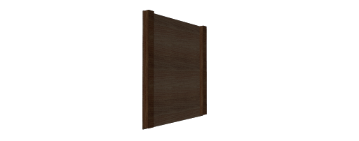

G+_Rud Dog Posted October 22, 2016 Author Share Posted October 22, 2016 Thanks guys this is what the final idea looks like. First off will cut out sheet rock from opposite side of wall that Flat-screen will mount. Then the item show below will be slid in so the plywood sits flush with the sheet-rock. The two 2x2's will be used to mount it to the studs in the wall. Plywood will give me some play with centering. Link to comment Share on other sites More sharing options...
