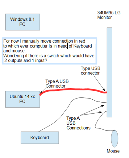

G+_Rud Dog Posted November 27, 2016 Share Posted November 27, 2016 Ran across this video and decided I wanted to take full advantage of my 34UM95 LG monitor. It revealed this particular monitor has a built in KVM switch. This video runs a PC and a Mac using DisplayPort and the Thunderbolt port. His USB mouse, keyboard, microphone are plugged into the USB A ports on the back of the monitor and the USB Type B connector is plugged into his PC via type A USB Connection. The Mac is connected only via the Thunderbolt port. When switching between computers via the LG monitor switch switch, his connected items follow the display and connected machine. My question is how does this work? Also once I know how it works via Displayport and Thunderbolt ports maybe it will help understand if it can be carried out using HDMI ports as the monitor in question has four connections for video, Display, Thundolt and 2HDMI ports. Here is the link that should clear up the setup. Link to comment Share on other sites More sharing options...

G+_Rud Dog Posted November 28, 2016 Author Share Posted November 28, 2016 Need a USB Type A switch which will help avoid the manual swapping of the red cable as this does work. a> Link to comment Share on other sites More sharing options...
G+_Ben Reese Posted November 28, 2016 Share Posted November 28, 2016 Sounds like you just need a HDMI/USB KVM switch. I'm using an old VGA/PS2 KVM to have 2 computers connected. I don't have enough experience with the HDMI/USB variants to recommend an affordable one. Link to comment Share on other sites More sharing options...
