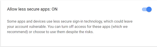

G+_Rud Dog Posted December 11, 2018 Author Share Posted December 11, 2018 John Sullivan yes I also read the section on how the "less secure apps" needed to be set for this to work and carried that out when I read it some time ago. Will try and make a Hotmail account and try that. Oh, the suggested alternative for washer done project was seen and didn't feel comfortable with the vibration approach. One request could you post your working files to Pastebin? Link to comment Share on other sites More sharing options...

G+_Rud Dog Posted December 12, 2018 Author Share Posted December 12, 2018 Seeing this error when attempting to run sketch: 535-5.7.8 Username and Password not accepted. Learn more at Error sending message: SMTP AUTH error Have looked at the password and username many times and can not find anything wrong with them. One odd thing when I attempt to print out the encoded username and password the username does not match the encoded username I created on the website for doing so and the Serial.println() for the password returns nothing? Link to comment Share on other sites More sharing options...
G+_Rud Dog Posted December 12, 2018 Author Share Posted December 12, 2018 So decided to try yet again the steps in the Instructable using his files as I have many times before. The only difference was making a video to post my steps. To my surprise, the files from the Instructable for some reason worked. Now I did read some folks were having to set the Gmail account setting for lowering the security more than once. I did that before quitting last night and it worked this morning. Now, will go back and review your sketch incorporating my sensor code and see if I can combine the two as you did. Hopefully, this will not be another long day. Link to comment Share on other sites More sharing options...

G+_Rud Dog Posted December 12, 2018 Author Share Posted December 12, 2018 Well, today is my lucky our combined code works for the first stage. I can only assume beings all the steps taken were identical and there was a problem with the flipping of the switch on the Gmail server. As mentioned some folks reported turning on and off the lower security settings did the trick well I believe it here as well. Thanks to John Sullivan for his help in this long search for the solution. Link to comment Share on other sites More sharing options...
