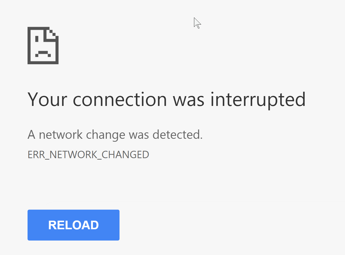

G+_Rud Dog Posted November 7, 2017 Share Posted November 7, 2017 Can anyone shed light on what this is? Popped up a few times, launching my browser, in the last few months. Link to comment Share on other sites More sharing options...
G+_Travis Hershberger Posted November 7, 2017 Share Posted November 7, 2017 I'm guessing Comcast's fumbling of routes yesterday. Link to comment Share on other sites More sharing options...
G+_Rud Dog Posted November 7, 2017 Author Share Posted November 7, 2017 Travis Hershberger Heard the story concerning Comcast's troubles and it was in the back of my mind when first experienced the network message but then realized, had experienced the connection problem before the story broke. Unless this has been going on far longer then stated. Link to comment Share on other sites More sharing options...
G+_Ben Reese Posted November 7, 2017 Share Posted November 7, 2017 I've got a batch script that I use in place of ping, then just let it run in the background. pinglog.bat: @echo off set pingServer=%1 ping -t %pingServer%|cmd /q /v /c "(pause&pause)>>nul & for /l %%a in () do (set /p "data=" && echo(!time! !data!)&ping -n 2 %pingServer%>>nul" Then just call it as "pinglog.bat 8.8.8.8" Doesn't answer the problem of why it's down, but gives one more check on Internet stability. Link to comment Share on other sites More sharing options...
G+_Rud Dog Posted November 7, 2017 Author Share Posted November 7, 2017 Forgot to mention the duration is only about 1 minute or so. Link to comment Share on other sites More sharing options...
G+_David Wiggins Posted November 7, 2017 Share Posted November 7, 2017 Are you on WiFi? You could be hopping networks. It happens a lot when people have home routers on default. My grandfather's is set to Linksys, unencrypted. I have a neighbor with the same. Sometimes my device will decide to hop over to the neighbor's and break and active session. I have to purge saves networks after visits. (My old phone was a pain, after once joining TWCWiFi, it would try to join anytime it saw it, even when riding down the road. And I couldn't make the blasted thing forget permanently) Link to comment Share on other sites More sharing options...
G+_Ben Reese Posted November 7, 2017 Share Posted November 7, 2017 Rud Dog this will catch it even if only one minute. It pings every couple seconds. I've also just piped it to a Txt file so I can get a full day's log and review later. I'm working on a version that will log to an SQL DB. Also, if it's intermittent like that it may be a noisy line. I was having an issue of my modem rebooting a few times a day because of too much noise on the line. Spectrum came out and replaced all the connections (crimped new ends, replaced splitters) and the problem mostly went away. Still some intermittent issues, but it hasn't rebooted for several weeks. Link to comment Share on other sites More sharing options...
G+_Rud Dog Posted November 8, 2017 Author Share Posted November 8, 2017 David Wiggins its happening on my LAN desk top computer not using Wifi on the desktop its hardwired. Ben ReeseAs for network rebooting it has gone from a chronic problem to one every 7 to 10 days. May comcast is being tickled. Link to comment Share on other sites More sharing options...
G+_Dan Baldwin Posted November 8, 2017 Share Posted November 8, 2017 I will get this if I launch my browser to quickly after boot up when the vpn hasn't started up yet then reconnects after vpn is running. Link to comment Share on other sites More sharing options...
G+_Rud Dog Posted November 8, 2017 Author Share Posted November 8, 2017 Dan Baldwin Currently not making use of VPN but good to know at least something else can trigger the event. Link to comment Share on other sites More sharing options...
