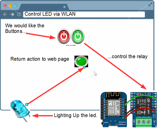

G+_Rud Dog Posted January 17, 2018 Author Share Posted January 17, 2018 Is there some way to have the sketch commands embedded in the ICONs shown below and return conditions sent to return action led? It would be great if HTML could directly talk and listen to the IOT device. Link to comment Share on other sites More sharing options...
