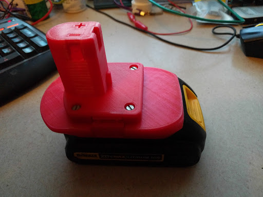

G+_Rud Dog Posted February 26, 2018 Share Posted February 26, 2018 I know we can apply this communities ability to a simple project. All my batteries (20VDC) hand tools have been purchased under the Dewalt brand name. Unfortunately, Dewalt does not make a 20V glue gun and I am in need of one and would like to use the large investment I have made in Dewalt's 20V batteries. Does anyone know of a solution allowing this to happen in the form of an adapter? I did find one solution but the cost of the adapter was around 70.00 bucks and shipping was about 29.00 dollars. And since I don't' own the glue gun yet add 29.00 dollars to that total. There must be an easier way. First thought anyone with a 3D printer and the ability to print the adapter? https://www.thingiverse.com/thing:1248463 https://www.thingiverse.com/thing:1248463 Link to comment Share on other sites More sharing options...

G+_David Peach Posted February 28, 2018 Share Posted February 28, 2018 Rud Dog, I'd be willing to print this for you. I haven't done the math yet, but if you will pay for the filament, electricity and shipping we could work out a deal. When I get home tonight I will pull it all up in my slicer and find out the cost of the print for you. Link to comment Share on other sites More sharing options...

G+_David Peach Posted March 1, 2018 Share Posted March 1, 2018 $3 for filament and electricity (actually $2.96, but close enough). Plus whatever shipping would cost. Then if you want to throw in 30 min of labor at whatever your hourly rate is that would be appreciated. I sent you a Hangouts invite so we can discuss the details. Link to comment Share on other sites More sharing options...

G+_Rud Dog Posted March 8, 2018 Author Share Posted March 8, 2018 David Peach thank you was really impressed with the quality of the battery adapter. Now If I could only get over the feeling I would spend more time troubling shooting the 3D printer then printing I would buy one. Here is the first stage. Went out to my shed and found screws cut them down and attached the two pieces together. Now will need to make a run to the hardware store as I don't have the blue spade connectors needed for the electrical connection. Oh, the two tabs require springs from what I read will need couple of ink pen springs. That comes next. Great Job. Link to comment Share on other sites More sharing options...
