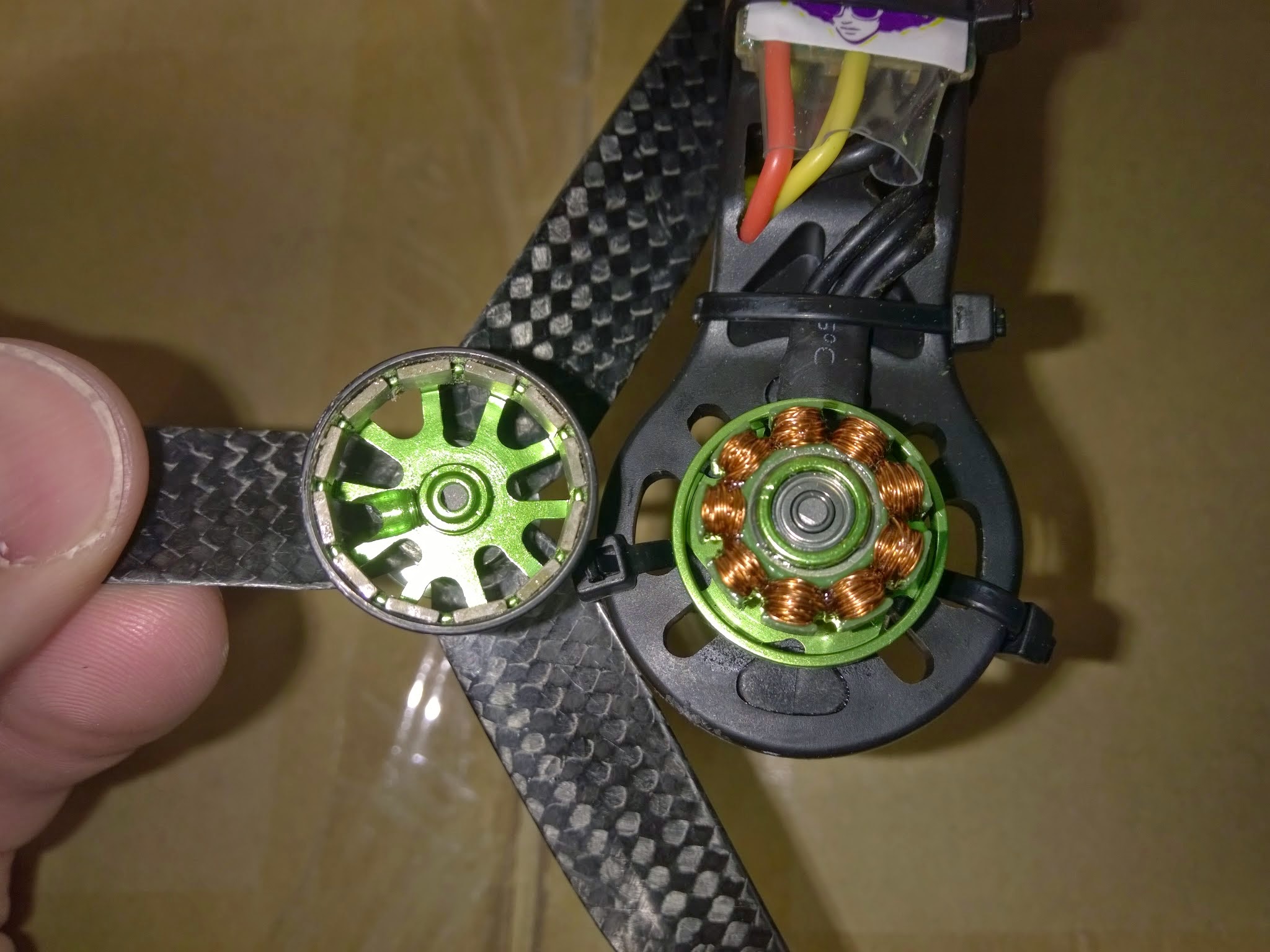

G+_Robert Watson Posted February 13, 2015 Share Posted February 13, 2015 Broke a motor shaft, while flying. I'm starting to think these motors aren't the best in the world. /s Link to comment Share on other sites More sharing options...
G+_Eddie Foy Posted February 13, 2015 Share Posted February 13, 2015 What motor? Happen on a hard accel? Link to comment Share on other sites More sharing options...
G+_Robert Watson Posted February 13, 2015 Author Share Posted February 13, 2015 It's the Turnigy motors that come with the Hobbyking Spec 250fpv kits. I think they are 1704-1900kv? I was just hovering in my front yard. And I have only had one of what may be called a "semi-hard" crash. Link to comment Share on other sites More sharing options...
G+_Wayne Black Posted February 13, 2015 Share Posted February 13, 2015 One thing that I've learned over the years about the manufacturers in China, is their "quality control" is hit or miss. They are getting better, but when they do the heat treating process, sometimes the metal will come out too soft or, what looks like in this case, too hard and brittle. I've seen drills made in China that when you went to drill a hole the drill would literally un-spiral. It's worth contacting HobbyKing and see if they'll replace it. Link to comment Share on other sites More sharing options...

G+_UAV Pirate Posted February 14, 2015 Share Posted February 14, 2015 Sometimes it's better to have the cheap plastic prop. When the motor is spinning as fast as these do its a lot of stress on the shaft. A plastic prop may have broke saving the motor? If this was a prop strike? Link to comment Share on other sites More sharing options...
G+_Eddie Foy Posted February 14, 2015 Share Posted February 14, 2015 Flexible plastic props vs rigid carbon? Tough choice. If filming, probably want plastic (less vibration/Jello effect), racing/work carbon probably a bit better. Also carbon won't absorb transient vibrations, so it has to go some where. Next stop: motor. Then frame. Balance those props!!!! Especially if rigid/carbon take and fix the vibration reports from the flight controller. Link to comment Share on other sites More sharing options...
