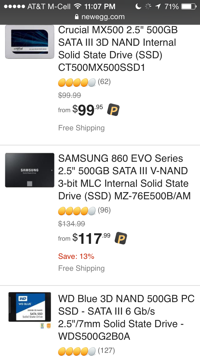

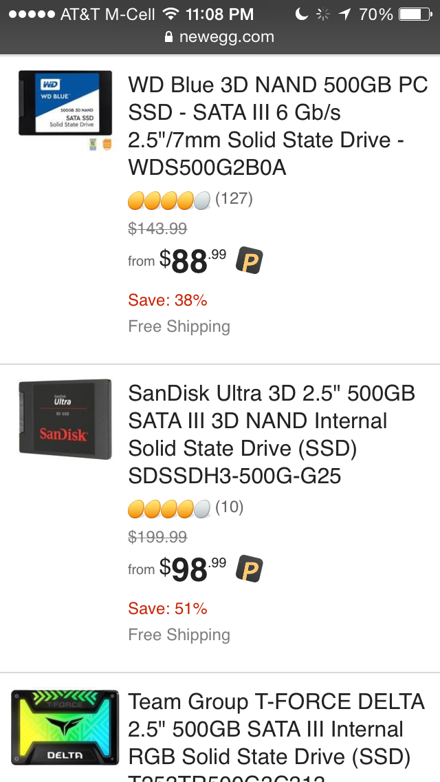

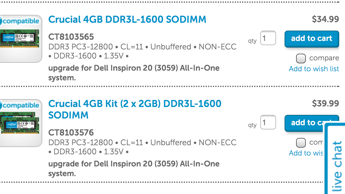

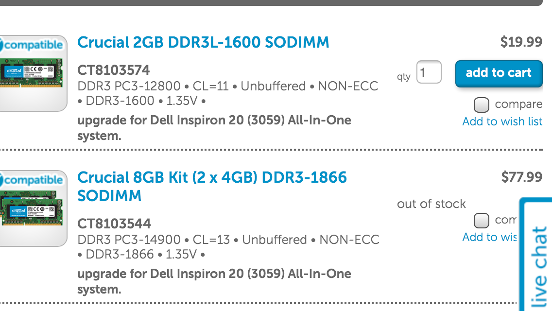

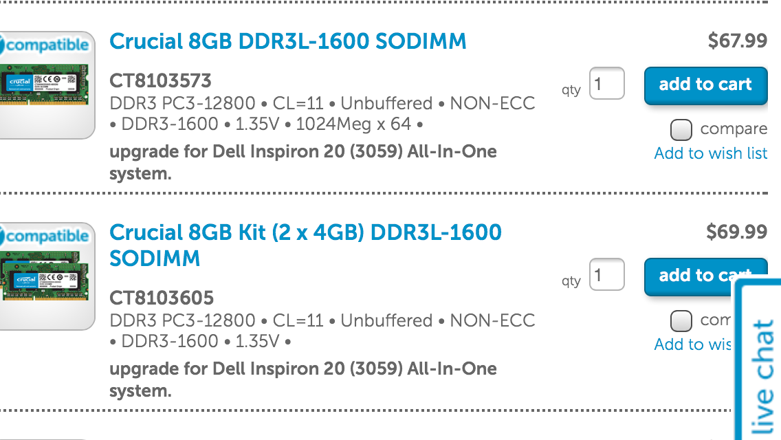

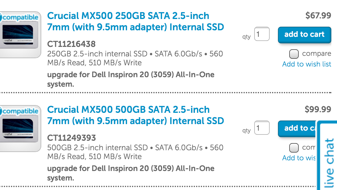

G+_Giligain I. Posted August 4, 2018 Share Posted August 4, 2018 ? I've got a computer to which I would like to make it run Linux on a new HD; at the same time upgrade the memory some. I've never done this conversion before, so I anticipate usual problems, like working on existing household plumbing pipes. So, I'm seeking some useful guidance to foresee problems before I order the extra hardware, or needed adapters for SSD conversion. ? this is the computer: never opened or started up yet • Dell Inspiron 20 3059 (specs) https://www.kahlon.com/rm688871_Dell_Inspiron_20_(3059).html https://m.ncix.com/products/specifications/139435 • Planned Purchase ORICO SuperSpeed USB 3.0 to SATA Hard Drive Docking Station for 2.5'' & 3.5'' HDD, SSD [support 8TB]-Black (6619US3) $20 https://m.newegg.com/products/9SIA1DS3N87773 • Memory I'm not sure how the (2) slots are used for memory or adding memory. I'm assuming 2gb cards in each slot = 4gb standard default given memory. If this is so then the upgrade memory to 8gb would require (2) 4gb cards. Or can you mix match sizes? If only (1) 4gb card is currently in the 'puter, then can I just get a 2nd 4gb card to add in other slot? Maybe these slots are empty to begin with. • Hard Drive I'm thinking of using SSD HD 500gb size for installing Linux. Not sure if one is obviously better choice than the other. Any feedback on making the conversion? If this isn't easy then installing a new SATA HD 1tb size will be my 2nd route to go with. • The Plan Take the existing Wndows 10 HD out of the 'puter and replace with the new HD which will be used for Linux. The Wibdows 10 HD can then be used with the Planned Purchase: external HD thru USB docking station. Adding memory is just a bonus for already being inside the 'puter, and not required if it's not too costly. ? I've spent $400 for the computer and would like to keep the upgrade as close as possible to half purchase price, $200. Any more spent needs to be justified and explained. • also, would it be better to do the Linux install into the hard drive before I make the HD swap? I prefer to have the internal HD run Linux and keep the Windows 10 OS on the external docking station. I suppose it's possible to copy the HD into the new external HD and then reformat and install Linux into the existing internal HD, but then that would rule out the memory upgrade since disassembly is no longer required. ? the pictures: Photo [1-3]: SSD HD ...the Crucial? my default choice, but don't know why. Photo [4-6]: Memory sticks ...I think any of these will "work" but unsure about best way to get 8gb. Or about their differences in layman's terms. ? P.S. This isn't a gaming 'puter by any means, just gonna be ordinary web pages, email, picture viewing use only. • thanks for any usual decisive help to get this project started. I have 30 days to complete this..if not sooner. Link to comment Share on other sites More sharing options...

G+_George Fromtulsa Posted August 5, 2018 Share Posted August 5, 2018 Giligain I. Setting aside and keeping both your OEM RAM and HDD could facilitate a warranty claim, for what good that's worth. RAM is sadly expensive. I recently bought a Gemini Lake NUC. It is running off some of the cheap SATA 120GB SSDs Amazon has recently sold for as little as $27, Kingston A400 being the probably best known brand, but I've several - PNY, AData, Silicon Power. With a SATA extender cable outside the case it is a simple matter to swap boot drives and test Linux distros. Useful before potentially borking "production machines" with new and shiny but not ready for prime time. Specs say the NUC maxes out at 8GB. Others reported it handles 16. The 16 cost about as much as the NUC and multiples of the current prices of 120GB SSDs. I just accept the OEM instruction to use matched pairs. It's for speed of access and started appearing so long ago I no longer remember the technical "why" it is better. Was easier to accept on machines that had, e. g., 2x2GB and 2 vacant slots. And RAM used to get cheaper over time - Link to comment Share on other sites More sharing options...

G+_John Sullivan Posted August 5, 2018 Share Posted August 5, 2018 George Fromtulsa According to the screenshots he posted, a 4 GB single RAM board for his computer is about $35.00 ... not that expensive Link to comment Share on other sites More sharing options...

G+_George Fromtulsa Posted August 5, 2018 Share Posted August 5, 2018 John Sullivan Correct. My inexpensive little NUC takes DDR4 2400 that were a lot more costly. Wal-Mart shows the i3 priced at $546, but out of stock. A 2014 intro? Crucial shows 8GB sticks at about $67 ea. Guess I'd try to get by with OEM 4GB and see how Linux runs before spending more. At equivalent price point the current model # is 3275 with AMD A6 APU. Does have USB 3.1 Gen 1, which would facilitate USB external boot. Pretty sure his 3059 has only USB 2 that would make for a much less happy external boot. Link to comment Share on other sites More sharing options...
