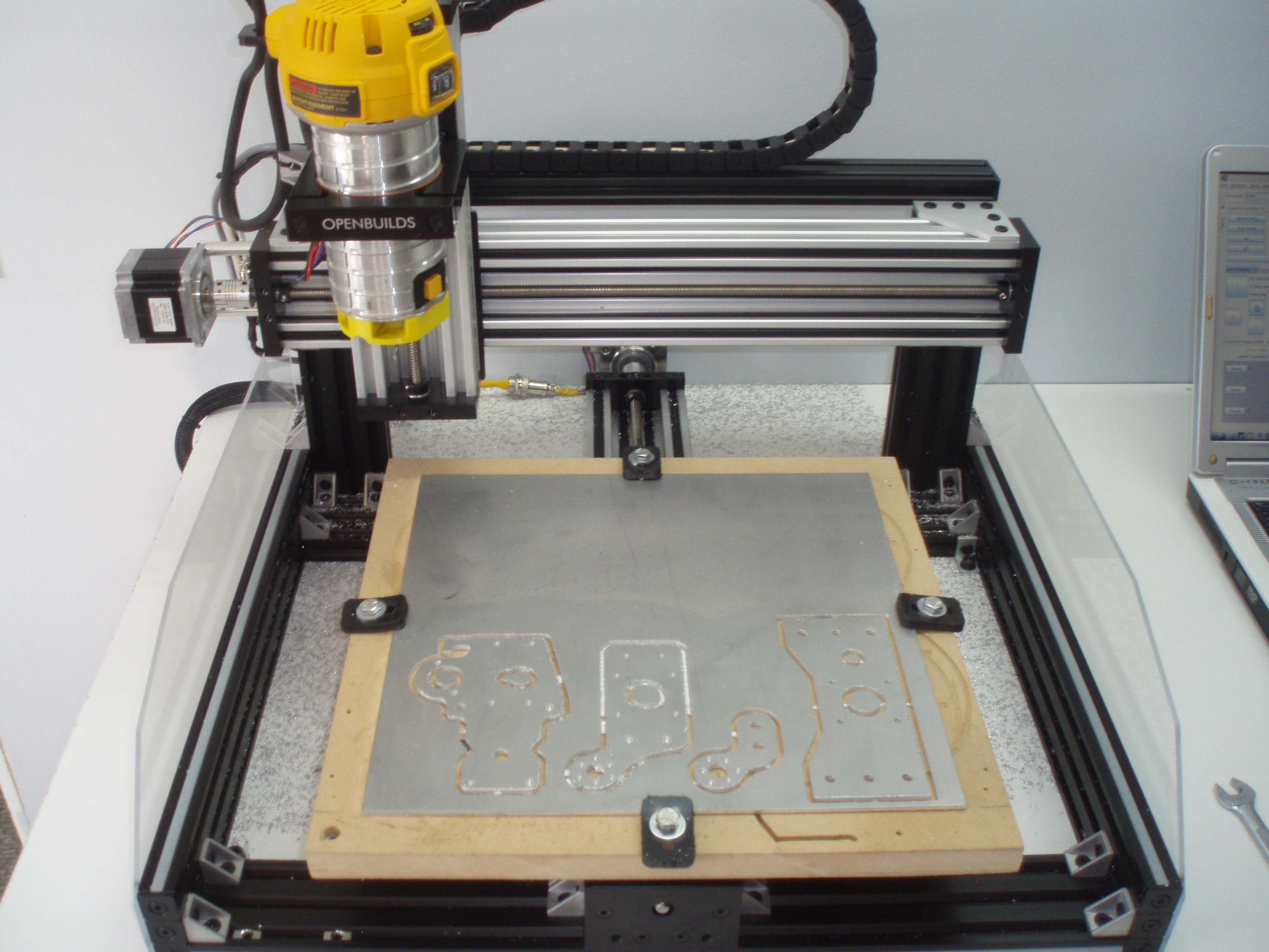

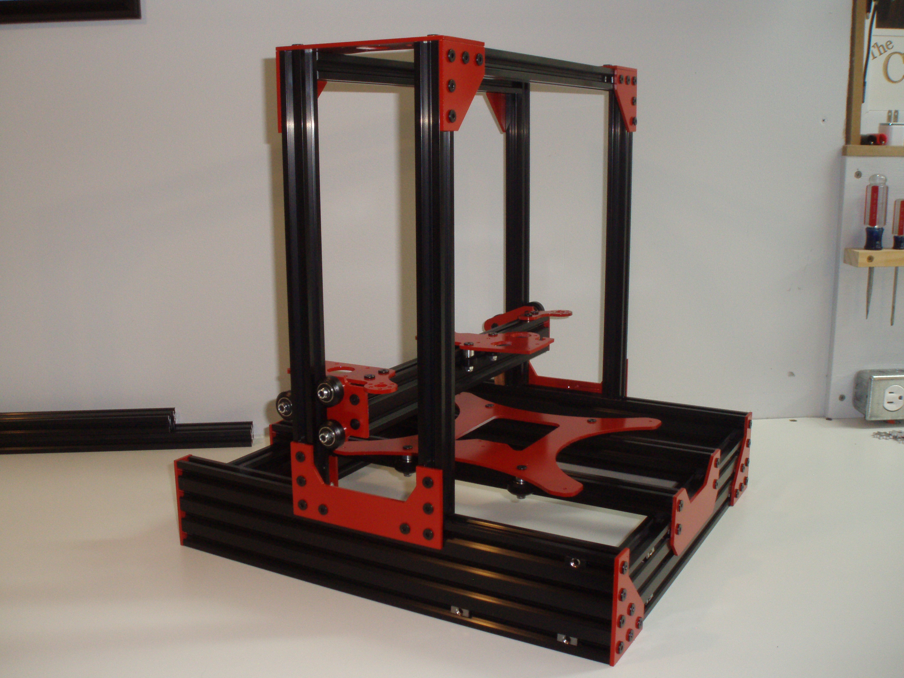

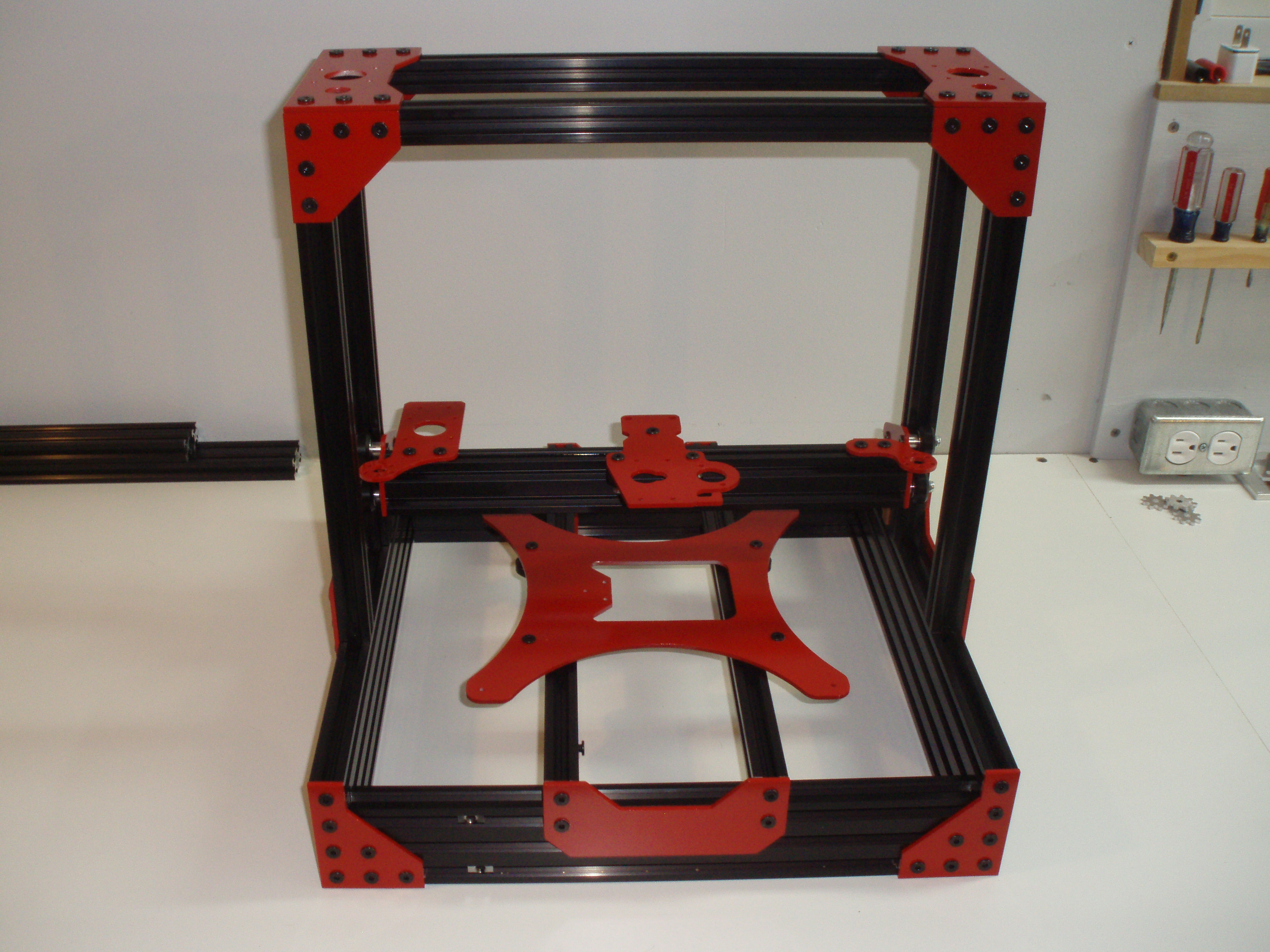

G+_Scott W Posted March 16, 2017 Share Posted March 16, 2017 Looking for some recommendations on 3d printer software. Specifically what slicer you are using. I have never owned or used a 3d printer and am looking for some easy to use software for a beginner. I am in the building stage of the printer and its time to look into software. I don't need CAM software, I currently use Fusion360 and Cut2d with my CNC. Just need something easy to use to get going. The printer will be using Marlin firmware if that matters. I am still a ways away from a working printer, the frame is built now gathering all the electronics. Looking forward to diving in soon. I actually built the CNC to use to make the brackets for the 3d printer. Link to comment Share on other sites More sharing options...

G+_Scott W Posted March 16, 2017 Author Share Posted March 16, 2017 James Hughes Thanks James, Repetier and Simplify3d both look great. I like that repetier already has 3 slicers bundled. I am going to give it a try. Tony Martin Hey Tony, I would say all in I have around $800 into the CNC. You can get the frame as a kit here: openbuildspartstore.com - C-Beam Machine Mechanical Bundle I bought all the parts separate because I wanted black and also did a few mods to stiffen up the Y-Axis. I am really happy with the performance, its rock solid. I have milled 1/4 in aluminum no problem. If I built another, I would go with a larger cut area though. With the mods I did I have a usable 12 x 12 cut area. Link to comment Share on other sites More sharing options...
