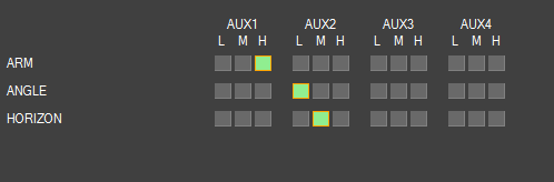

G+_Erik Ellsinger Posted July 10, 2015 Share Posted July 10, 2015 Seems like my configuration isn't being saved to the flight controller. Even after I click Write settings I have the orange border which indicates that the settings have been changed but not saved to the flight controller. Also arming using Aux1 doesn't work but arming by moving the stick to the lower right corner does work and the motors spin up. Does anyone have any idea why my configuration won't be saved to my flight controller? Link to comment Share on other sites More sharing options...
G+_Erik Ellsinger Posted July 10, 2015 Author Share Posted July 10, 2015 Found the problem, you need to run the MultiWii program as a administrator. Link to comment Share on other sites More sharing options...
