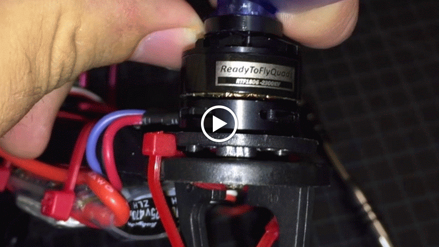

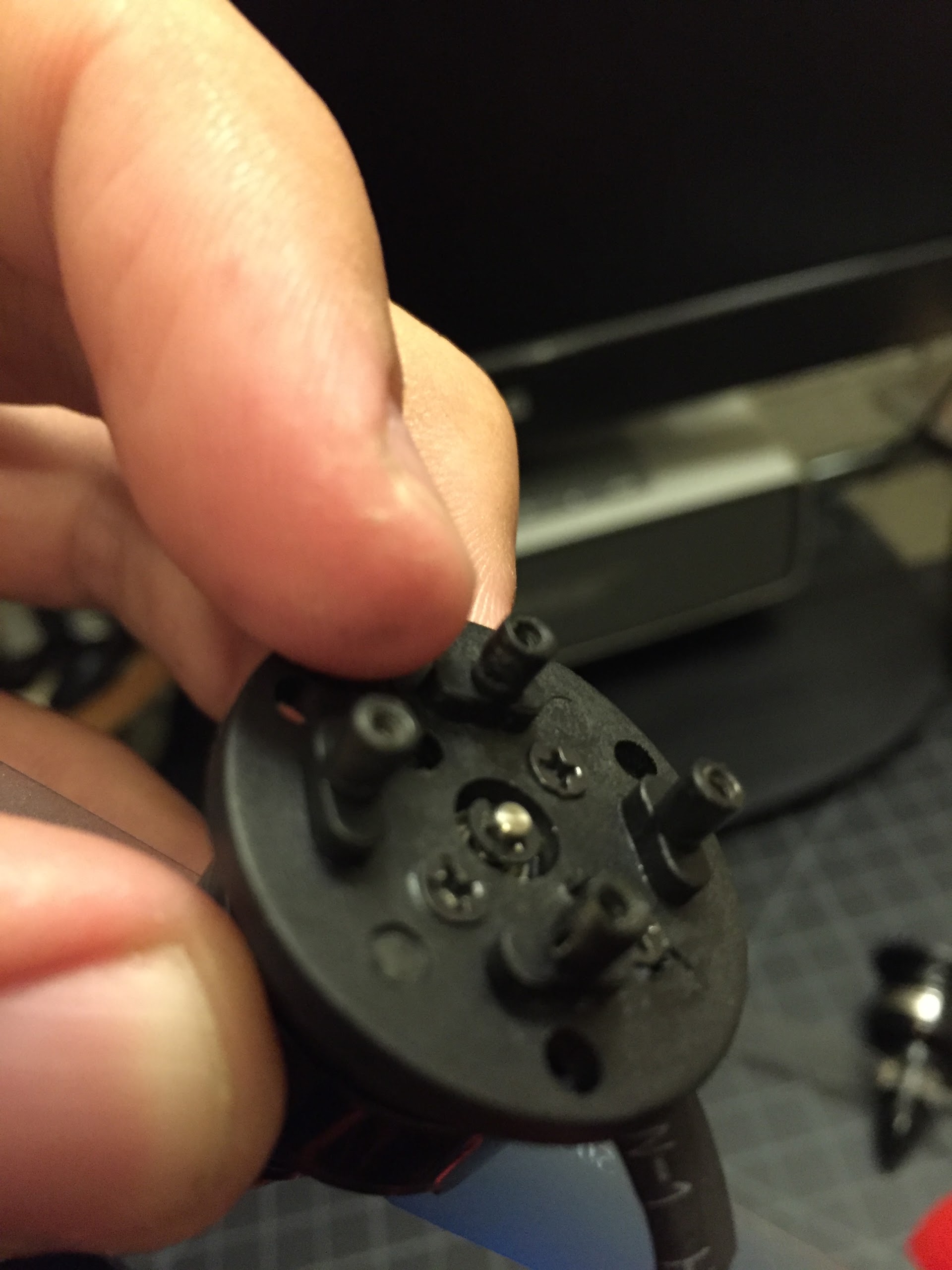

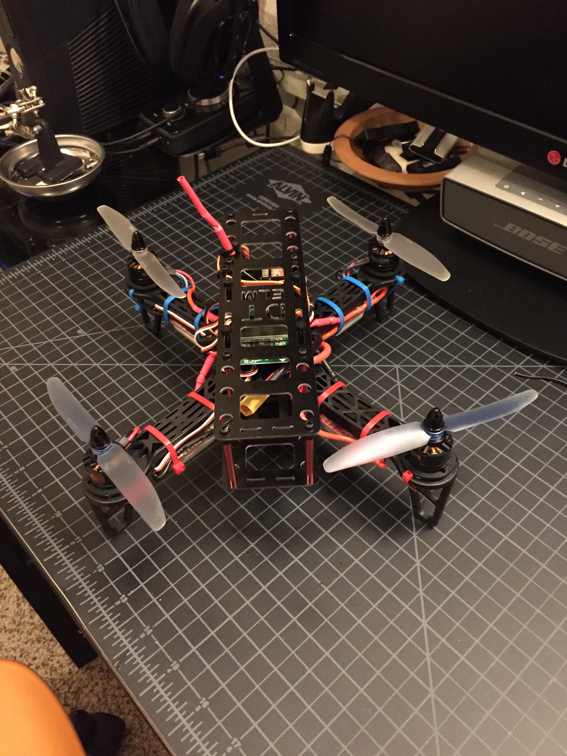

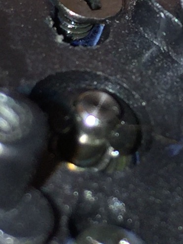

G+_Adam Schweitzer Posted July 12, 2015 Share Posted July 12, 2015 Just finished my first quad build, the KH 250 today. Very happy overall with the parts and performance. Just one problem...I ended up the the RTF Quads 1806-2300KV motors. During my first flight I was hovering a few feet from the ground and it just fell out of the blue. My initial inspection looked like one of the motors may have gotten a screw in the windings because the top half of the motor was all wobbly and barely spun. Tonight, once I had a chance to take it apart, I found out it was actually a loose locking screw for the prop shaft. You can see in the pictures one of my others motors that surprisingly was still working; moving up and down about 1/8". So 2 out of 4 of these motors had this problem apparently. Anyone else have this issue? Is this something I should be checking often? Never heard Fr. Robert Ballecer, SJ mention this on the show before. Link to comment Share on other sites More sharing options...
G+_Quadflyingmedic Posted July 12, 2015 Share Posted July 12, 2015 Pull the setscrew out and put some locktight on it and line it up tighten it down and shouldnt have any more problems. I always make sure everything is tight and has locktight on it when building. Had a bell fly off a motor on a maiden of one of my quads never found it. Learned the hard way. Congrats on your first build Link to comment Share on other sites More sharing options...
G+_Adam Schweitzer Posted July 12, 2015 Author Share Posted July 12, 2015 Thanks! I did exactly that on all 4 motors now. Fingers crossed for my next flight! Link to comment Share on other sites More sharing options...
