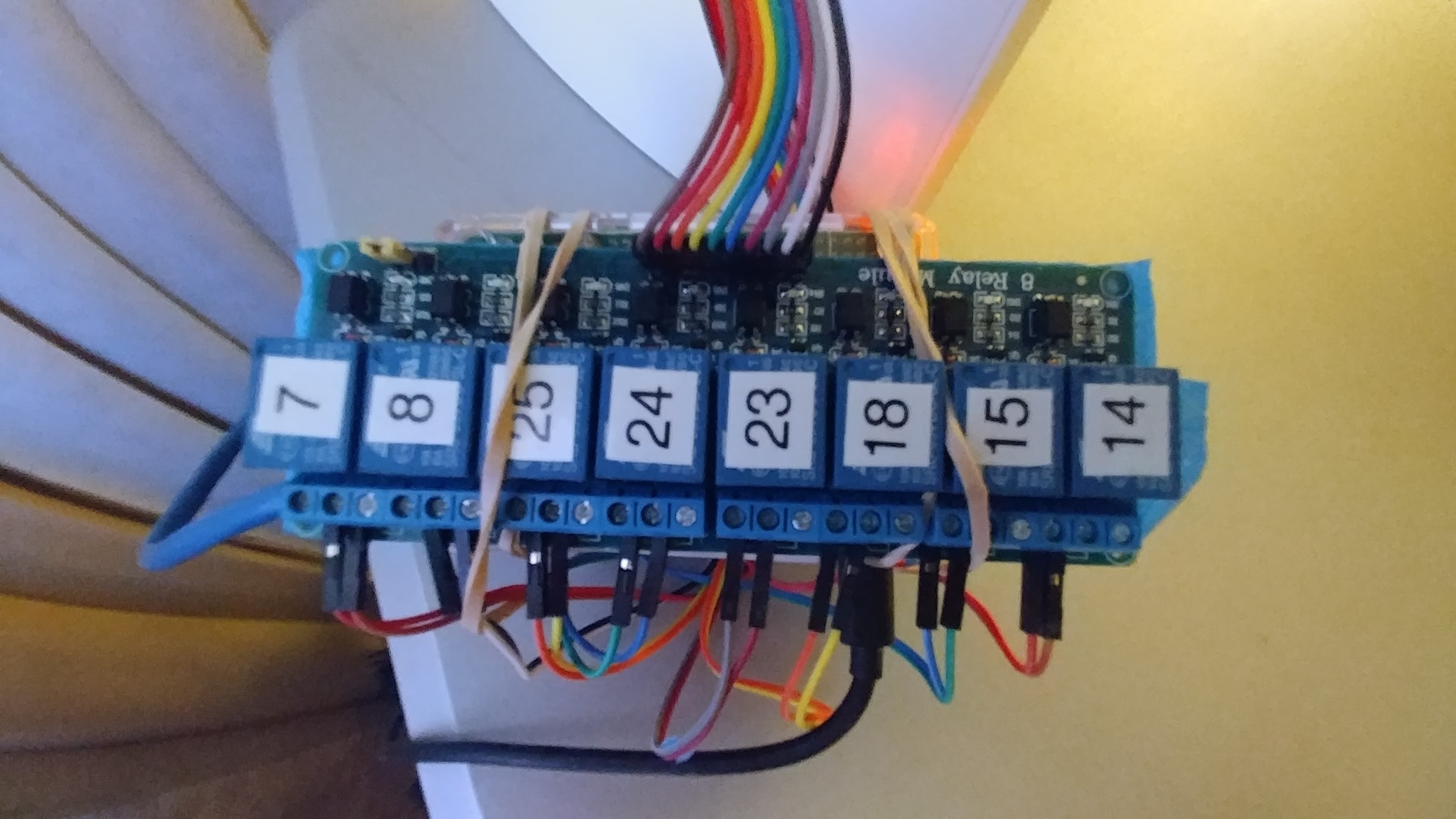

G+_Patrick Gormley Posted January 25, 2017 Author Share Posted January 25, 2017 I think I will use a Raspberry Pi that I have from a old project laying around. It's probably not the most elegant way but I think I will get a 8 channel Relay board and sacrifice a remote and attach the relays to the button pads. Then just use the Python Flask framework to accept http calls to "Press" the buttons on the remote. Link to comment Share on other sites More sharing options...

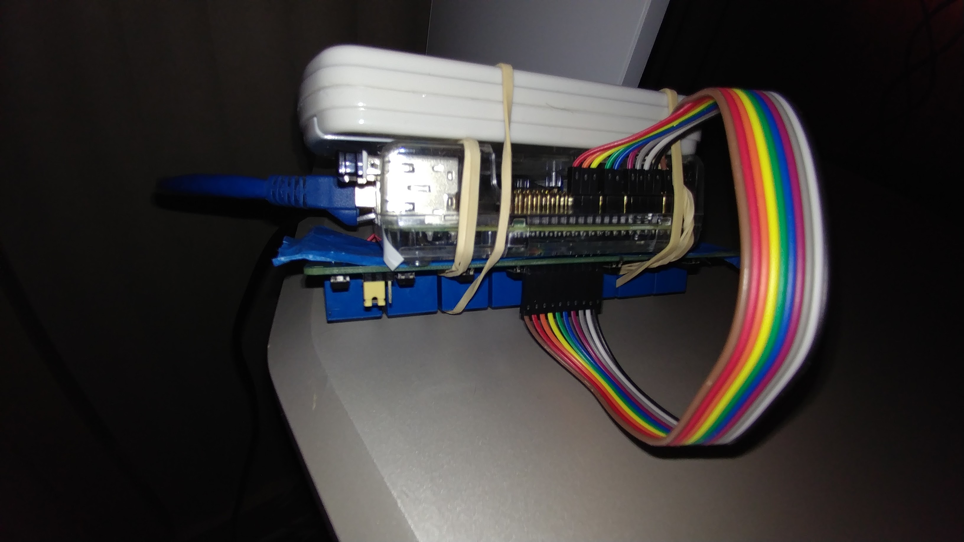

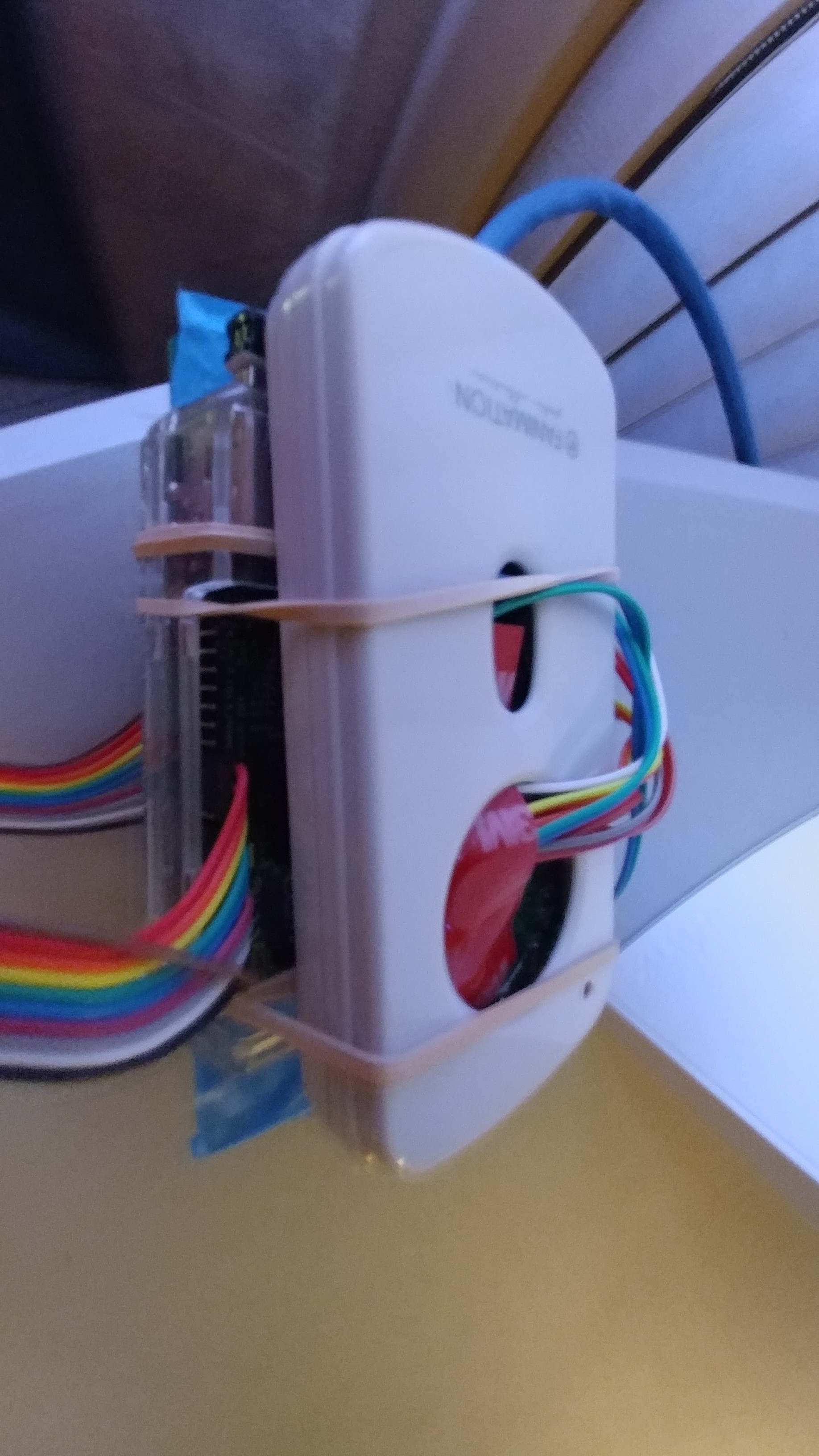

G+_Patrick Gormley Posted February 1, 2017 Author Share Posted February 1, 2017 Its done but not to pretty. Need to figure out some sort of enclosure. Link to comment Share on other sites More sharing options...

G+_Carlton Dodd Posted February 1, 2017 Share Posted February 1, 2017 Glad you got it working! Looks like you settled on a R-pi for the controller? The relays are probably overkill, and almost certainly noisy. If you go for a revision, you could probably replace them with transistors. Link to comment Share on other sites More sharing options...
