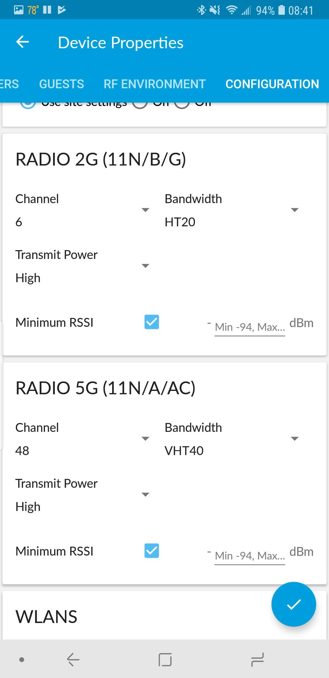

G+_Ben Reese Posted May 28, 2018 Share Posted May 28, 2018 It's not really a common setting and may not even be exposed on all routers. It's the minimum signal strength where devices consider a strong enough connection. Wireless routers expect to be the only device you're connecting to, so they'll hang onto that connection as long as possible. Reducing the RSSI (or is it increasing? I'm usually confused dBm numbers) will cause it to disconnect sooner. Again, not something that most people have to adjust, just an option. Here's a screenshot of the setting (not actually set) on my Ubiquiti AP. It looks like on OpenWRT it may have to be set manually on config files. Link to comment Share on other sites More sharing options...
