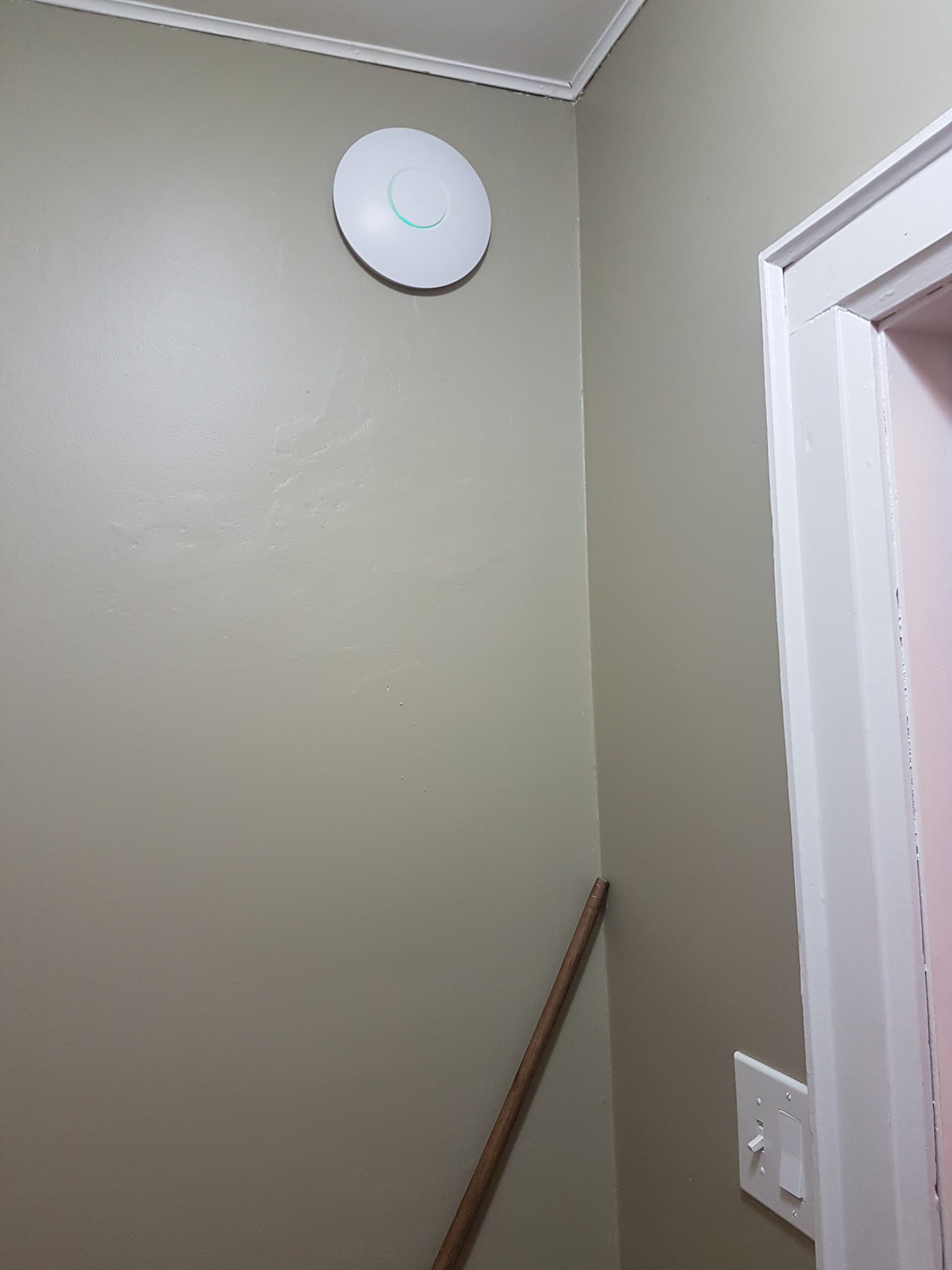

G+_Jason Perry Posted August 10, 2016 Share Posted August 10, 2016 Finally got around to mounting my AP somewhere other than on the floor in the basement under my desk. Link to comment Share on other sites More sharing options...
G+_Travis Hershberger Posted August 10, 2016 Share Posted August 10, 2016 Nice. I actually had to turn the power down on the two we have at work. Even one being mounted in a closet and the other in a different building, in the offices the signals were confusing Apple devices. Link to comment Share on other sites More sharing options...
G+_Jason Perry Posted August 10, 2016 Author Share Posted August 10, 2016 I thought the range was a big improvement over my old device. Now that I have it in a better location it's amazing and it's only N Link to comment Share on other sites More sharing options...

G+_todd zimmerman Posted August 25, 2016 Share Posted August 25, 2016 Jason Perry what model AP did you go with? Link to comment Share on other sites More sharing options...
G+_Jason Perry Posted August 25, 2016 Author Share Posted August 25, 2016 todd zimmerman?, it's the wireless N long range version. I got it because a company was upgrading. I wanted the AC version and was willing to pay, but I wasn't going to turn down a free AP. Link to comment Share on other sites More sharing options...
G+_todd zimmerman Posted August 25, 2016 Share Posted August 25, 2016 Jason Perry?? how good is the effective range? I need to build a setup to share WiFi across two buildings (both being 2 story wood frame, roughly 100 feet apart center-to-center). I'm not sure if the Long Range AP would be suffient for the second building if the LR AP is deployed in the first building. The other option that I'm considering is using a pair of NanoSatation Loco M2's to act as a bridge between the two buildings, then have separate APs on both sides of the bridge, with an EdgeRouter X on the base side. In a past deployment, I used a Linksys WRT54GS with DD-WRT for the base station with an ASUS wireless N router acting as a Repeater in the remote building. Overall, this worked great. However, when we hosted an event with 10-20 teenagers (several times a year), the Linksys router would get saturated on the WiFi and lock up requiring a reboot. (Wired traffic would be OK). So... I'm thinking about doing a redeploy using non-consumer gear. Don't get me wrong, I love the WRT54GS (being hw v1.x it has 32MB RAM + 8MB flash) with DD-WRT, but it I need something that's more stable when it gets pounded. Thx ? Link to comment Share on other sites More sharing options...
G+_Jason Perry Posted August 25, 2016 Author Share Posted August 25, 2016 Now that my AP is off the floor of my basement I can get through 25' of house and 75' to 100' in my backyard. My house was built in 1936 so it is thick plaster walls. That being said it starts to get shotty streaming video after 50' into my backyard, so 75' total. Not sure how much extra distance you would get out of the AC hardware but I think that would be the way to go. Link to comment Share on other sites More sharing options...
