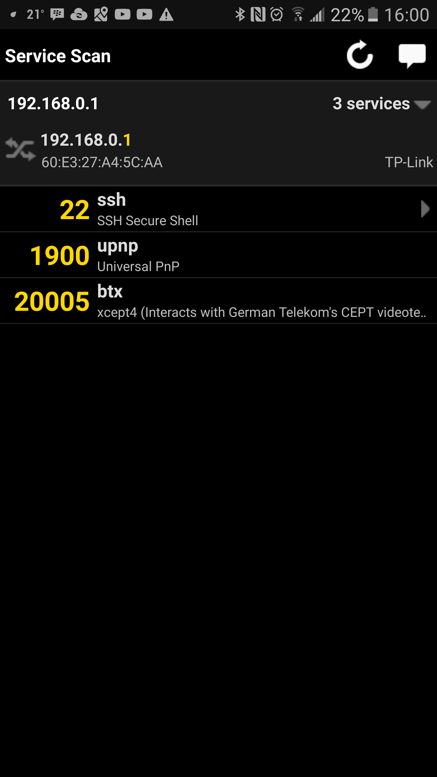

G+_Jason Perry Posted September 17, 2016 Share Posted September 17, 2016 So I am willing to admit the Internet issue at my parents house is being caused by the 10 month old router. I opened their laptop to see the only wireless connection is the default the router came with. On top of that now that I am connected I can ping the router but there isn't a landing page. Any thoughts on what's resetting the router? PS it's mounted high enough I have to get on a ladder to get to it. Link to comment Share on other sites More sharing options...

G+_Eddie Foy Posted September 17, 2016 Share Posted September 17, 2016 Did you port scan it? If there is no 80/445 then maybe the webserver went down. If it has 22/23 ssh/telent, maybe you can get in and just reboot it from there. Link to comment Share on other sites More sharing options...

G+_David Wiggins Posted September 18, 2016 Share Posted September 18, 2016 Is that fing you used for the port scan? I love that app. Between tools like that and guacamole, I'm using a full PC less and less lately. (Although guac is a bit of a cheat). Link to comment Share on other sites More sharing options...
G+_Jason Perry Posted September 20, 2016 Author Share Posted September 20, 2016 Just got a phone call from my father's ISP. They just told me that they just noticed the issue we have been having for the past year isn't the router. When they took a closer look at it there has been a brief signal loss followed by the router reconnecting. In their words the signal loss is so brief it looks like the router is just reconnecting on its own. Link to comment Share on other sites More sharing options...
