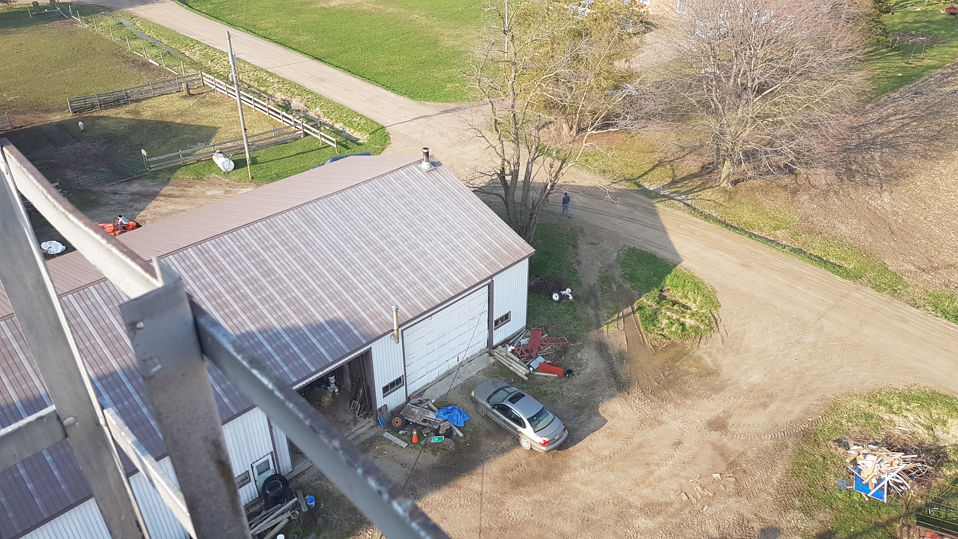

G+_Jason Perry Posted April 19, 2017 Share Posted April 19, 2017 Looking for a YouTube tutorial. I am standing 80' in the air. I need to hang an Ariel network cable down to that building. Could do it my way but I don't want do this more than once. Comments video recommendations? Link to comment Share on other sites More sharing options...

G+_Jason Perry Posted April 19, 2017 Author Share Posted April 19, 2017 Travis Hershberger?, there is a support wire running the path I want to take already. Not sure how much help that will be though besides to anchor each end of the run. I am trying to firm up distances but I don't see the full end to end run being much longer than 150'. I am going to the far corner of the building in the picture. Fiber or wireless is not an option because it is for a PoE WiMax radio. The picture is from the top pf a grain elevator which is my only good line of sight to the radio on the other end. Tod Sage?, this post should help clarify your question. Link to comment Share on other sites More sharing options...

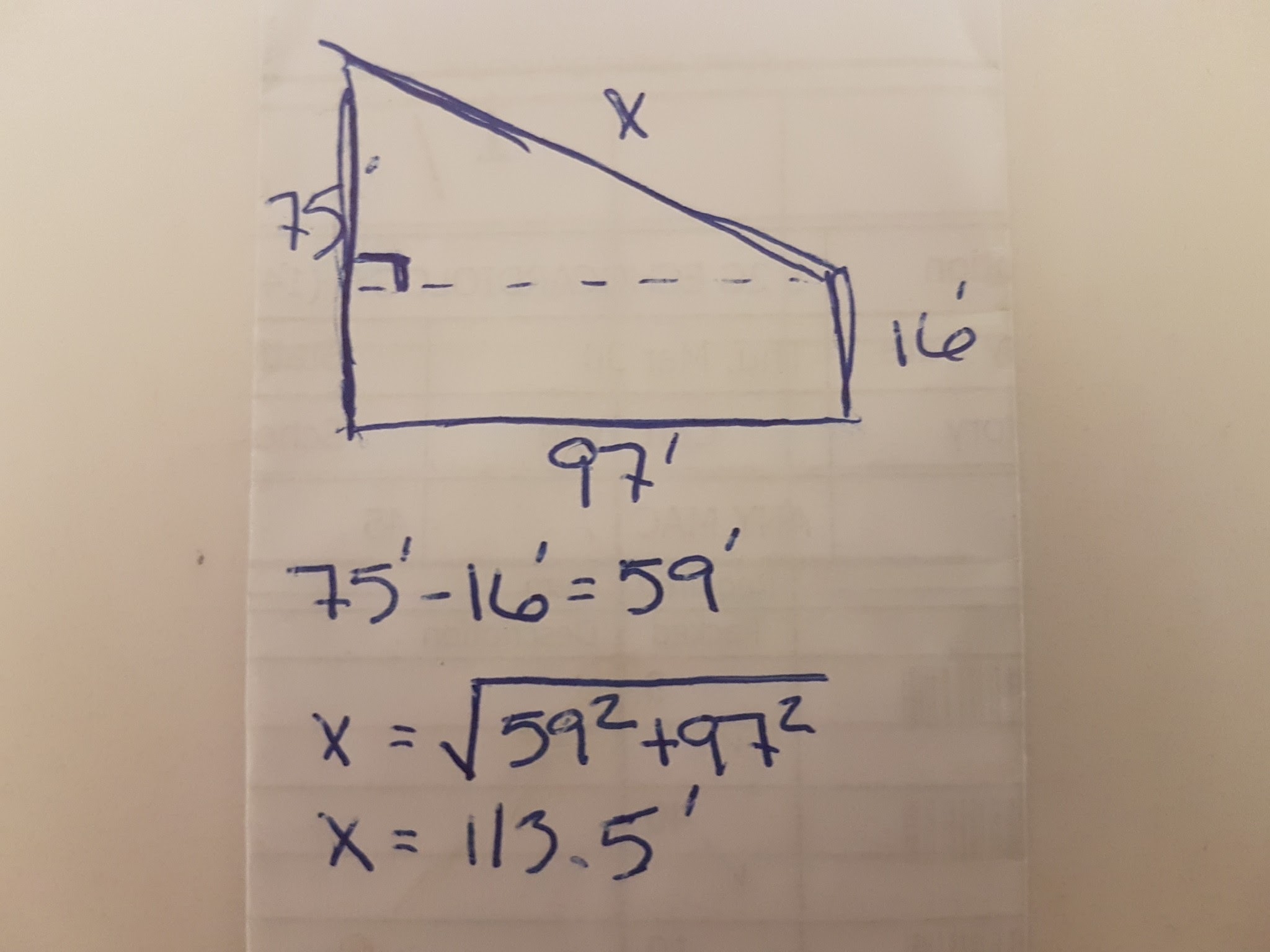

G+_Jason Perry Posted April 19, 2017 Author Share Posted April 19, 2017 I finally got the measurements. It looks like the only way to make it work is to run power closer. The only way to get power within 100' is to run it to the base of the elevator or right to the top. Personally my preference is all the way to the to the top so if I want to play with other radios I can. Link to comment Share on other sites More sharing options...
