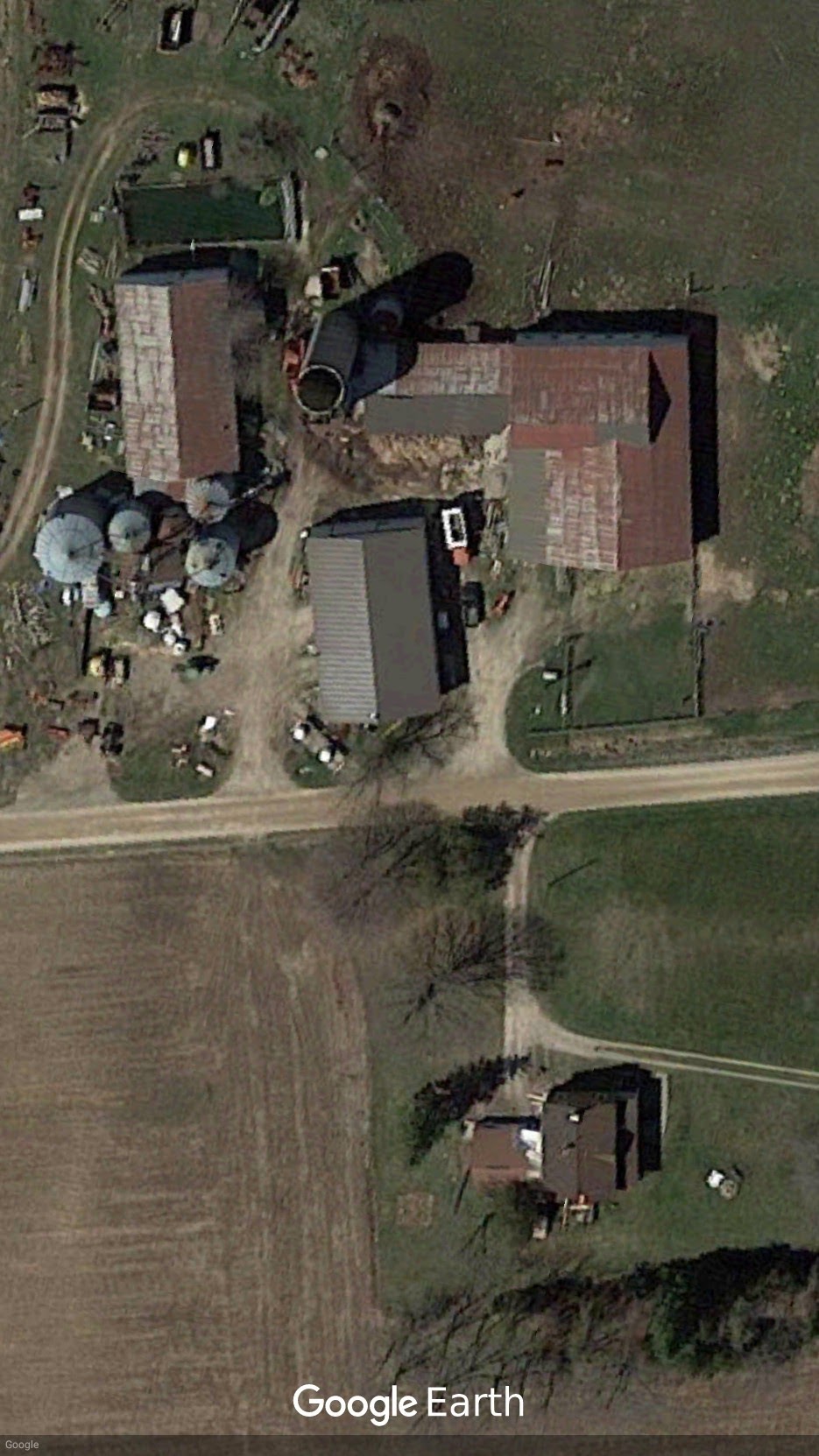

G+_Jason Perry Posted April 22, 2017 Author Share Posted April 22, 2017 Thanks Jared Twomey?. The radio is a Trango M900S. I want to see if I can upgrade since the radio is old and I am going to all this trouble. The radio is currently on the house which is at the bottom of the picture and it will be moving in between all those bins on the right hand side. There isn't a short run in this entire project. Link to comment Share on other sites More sharing options...
G+_Jared Twomey Posted April 22, 2017 Share Posted April 22, 2017 Gotcha, I used to install those all the time, we have since pulled all the Trango unlicensed stuff off our network. I would definitely see if you can upgrade if possible, you can get much better speeds out of the newer equipment available. Also, the trango radios use a non-standard poe wiring, so if you do need to use an extender, you would have to flip some pairs around in the cables. Link to comment Share on other sites More sharing options...
