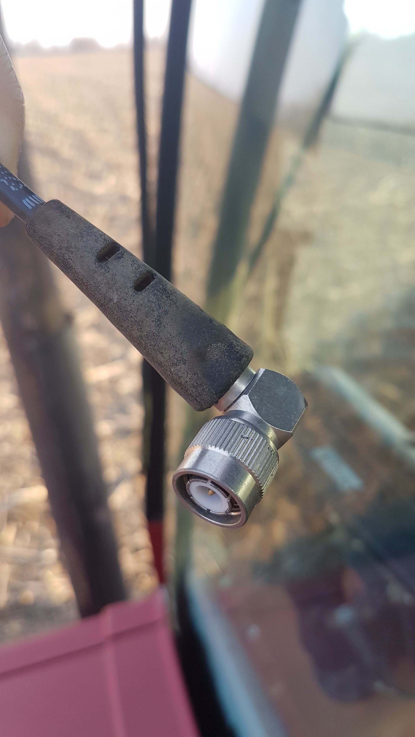

G+_Jason Perry Posted May 26, 2017 Share Posted May 26, 2017 Anyone have experience putting BNC ends on a piece of coax for a GPS receiver? Or testing the line. I am relying on someones word that it is the connector that is broken. I have a tester for f-connectors, maybe just an adapter is needed. Link to comment Share on other sites More sharing options...

G+_Technical Terry Posted May 26, 2017 Share Posted May 26, 2017 Yes, just use an adapter and your tester will work fine for continuity. (Or you can just use a multimeter to test continuity and ensure there is not a short between shield and signal) Link to comment Share on other sites More sharing options...
G+_Jason Perry Posted May 26, 2017 Author Share Posted May 26, 2017 If I need to put new ends on the wire does anyone have recommendations on equipment? I am guessing my compression tool for f-connectors won't work. Link to comment Share on other sites More sharing options...
G+_Joe Valasko Posted May 26, 2017 Share Posted May 26, 2017 You could check out a video on YouTube such as the following. Link to comment Share on other sites More sharing options...
G+_Technical Terry Posted May 26, 2017 Share Posted May 26, 2017 Jason Perry your compression tool could work, it depends on the diameter of the cable. I usually just use a crimp connection. The thick cable I use for long runs is Gepco VSD2001 which requires a Kings 10-9 BNC connector. So because the jacket is thick it requires a larger die in the crimper. Link to comment Share on other sites More sharing options...
G+_Jared Twomey Posted May 26, 2017 Share Posted May 26, 2017 Some compression tools will also work for BNC compression connectors, depends on the tool. I used to install them all the time for SDI cables. Link to comment Share on other sites More sharing options...
