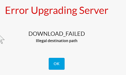

I know my last update I can no longer log in and download the beta software for viewing the timeline. Here is the error I get. I am set up on a laptop locally.

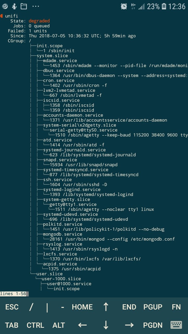

i just ran 'systemctl status unifi' and this is what i am up against
? unifi.service - unifi
Loaded: loaded (/lib/systemd/system/unifi.service; enabled; vendor preset: enabled)
Active: inactive (dead) since Thu 2018-07-05 23:19:21 UTC; 13s ago
Process: 5090 ExecStop=/usr/lib/unifi/bin/unifi.init stop (code=exited, status=0/SUCCESS)
Process: 4975 ExecStart=/usr/lib/unifi/bin/unifi.init start (code=exited, status=0/SUCCESS)
Jason Perry That line with 'Active: inactive (dead)' tells us the service isn't running, so, yeah. Won't work so well.

You can check the mongodb status with 'systemctl status mongodb'
