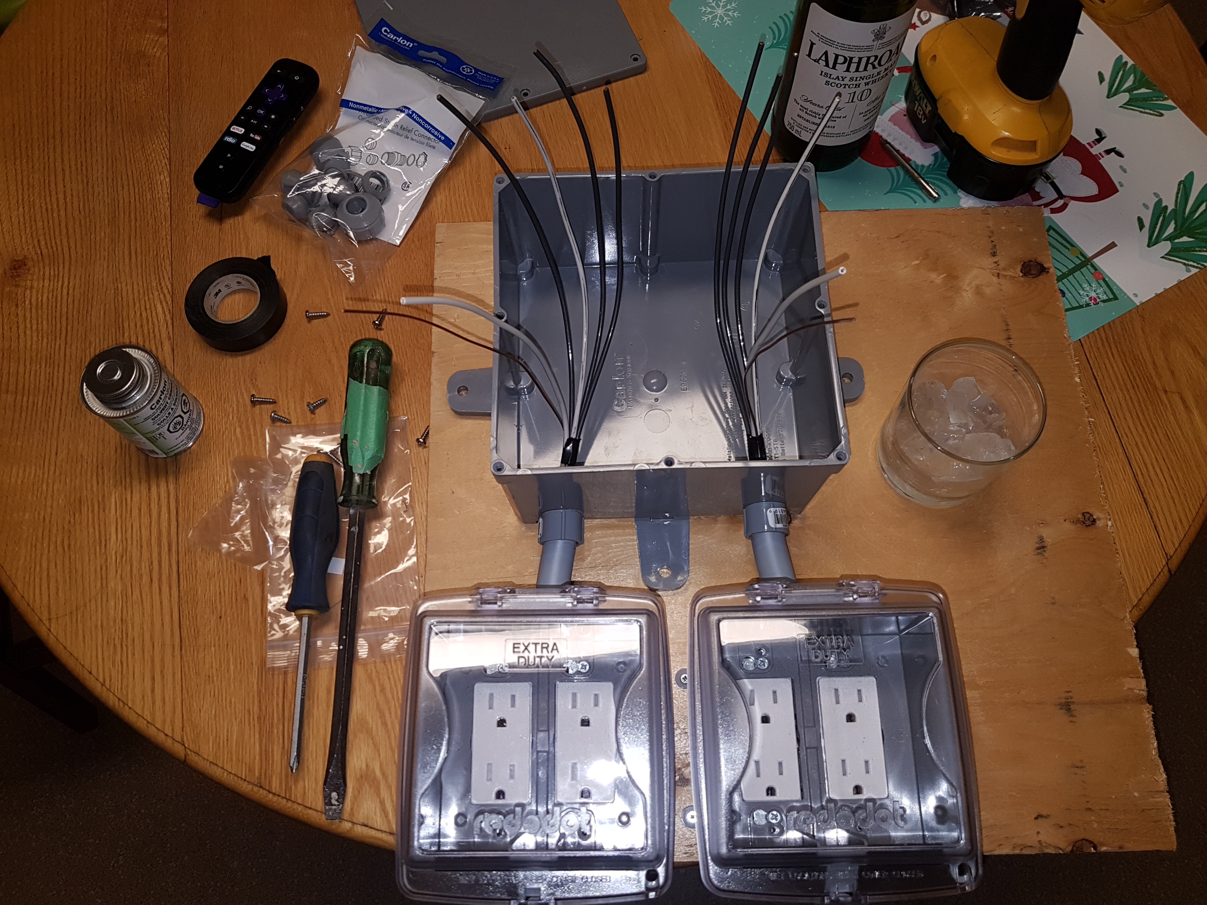

G+_Jason Perry Posted November 26, 2017 Share Posted November 26, 2017 Well I think it is time to clean up and call it a day, before someone decides to wake up. It isn't 32 channels in a fancy Plexiglas box, and I doubt it is even automated this year, but I think it is a good start. Link to comment Share on other sites More sharing options...

G+_Jason Perry Posted November 26, 2017 Author Share Posted November 26, 2017 Not tonight. My wife is out and the kids are in bed, and I couldn't help but build this though from my head. Link to comment Share on other sites More sharing options...
G+_Dan Baldwin Posted November 26, 2017 Share Posted November 26, 2017 Esp and relays in top box? Link to comment Share on other sites More sharing options...
G+_Jason Perry Posted November 26, 2017 Author Share Posted November 26, 2017 Dan Baldwin no microcontroller this year. I want to play with vixen and falcon player before I add switching control at the plugs. I do have an 8 channel SSR board. My intent is to swap out the relays so I can dim, past that it's all up in the air. This year it is going to house a timer, next year my relay board and an Arduino or ESP. Link to comment Share on other sites More sharing options...
G+_Jon Paul Bubendorfer Posted November 26, 2017 Share Posted November 26, 2017 Just curious, 3 circuits per duplex box, I see that. But what's the small wire for? And my OCD is not happy with your angled PVC. The make offset nipples exactly for that. Link to comment Share on other sites More sharing options...
G+_Rud Dog Posted November 26, 2017 Share Posted November 26, 2017 Looking good. Where did you pick up the boxes. Link to comment Share on other sites More sharing options...
G+_Jason Perry Posted November 26, 2017 Author Share Posted November 26, 2017 Jon Paul Bubendorfer I bent the PVC because of the limitations of my local home depot, believe me I looked. The neutral and ground for each box are the ones that are separate from the other wires. The one white wire has a black line down it, I didn't feel like wasting, two more lengths of wire, probably should have. I should go out and buy spools of individual wires. I need to go out and get some Wago lever nuts to finish the job. Link to comment Share on other sites More sharing options...
G+_Jason Perry Posted November 26, 2017 Author Share Posted November 26, 2017 Rud Dog everything is from home depot. Link to comment Share on other sites More sharing options...

G+_Jason Perry Posted December 3, 2017 Author Share Posted December 3, 2017 Jon Paul Bubendorfer well, you called it. The one white wire is getting to me. I will be going out and buying a roll of black wire. Link to comment Share on other sites More sharing options...
G+_Jon Paul Bubendorfer Posted December 3, 2017 Share Posted December 3, 2017 I will not deny, in such a situation, I have put black tape on the visible portion. But that was on really long runs, yours might be easy to swap. Well done. Link to comment Share on other sites More sharing options...
