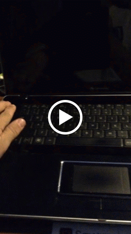

G+_Phillip Adcock Posted August 15, 2014 Share Posted August 15, 2014 This is what my computer is doing, I installed icloud control panel, reset the computer and this started. It doesn't load bios or anything, help me please. Link to comment Share on other sites More sharing options...
G+_Urszula Kaczynski Posted August 15, 2014 Share Posted August 15, 2014 Try turning it off and back on. Press f8 repeatedly until you get a menu. Click on last known good configuration. It might work. If not try f6,11 or 12. Link to comment Share on other sites More sharing options...
G+_Phillip Adcock Posted August 15, 2014 Author Share Posted August 15, 2014 That didn't work for me. I tried still just cycles. Link to comment Share on other sites More sharing options...
G+_Phil Chung Posted August 15, 2014 Share Posted August 15, 2014 ICloud was coincidence. Seeing is a laptop, I would remove the battery and leave everything disconnected for a short while before reconnecting everything and trying again. Link to comment Share on other sites More sharing options...
G+_Phillip Adcock Posted August 16, 2014 Author Share Posted August 16, 2014 Tried that, as well as swapping for Linux hard drive still keeps going through the power cycle Link to comment Share on other sites More sharing options...
G+_Ben Reese Posted August 16, 2014 Share Posted August 16, 2014 I've had the same issue on one of my laptops when the battery died. Seems like I had to take the battery out and leave it unplugged for a few minutes. I then plugged it back in with the battery left out and hit the power button. After it started booting I was able to put the battery back in. ? -I think this was on a Compaq that I had the problem. Link to comment Share on other sites More sharing options...
G+_Ezar Vasquez Posted August 16, 2014 Share Posted August 16, 2014 Yeah, good chance it's battery pack. Leave out for few minutes then try starting without the battery. If not you could try removing mobo battery. Good luck. Link to comment Share on other sites More sharing options...
G+_P Costello Posted August 16, 2014 Share Posted August 16, 2014 Try connecting an external display monitor Link to comment Share on other sites More sharing options...
G+_Phillip Adcock Posted August 16, 2014 Author Share Posted August 16, 2014 P Costello I don't think that will help the power cycling I'm having. Link to comment Share on other sites More sharing options...
G+_Brad Whitfield Posted August 16, 2014 Share Posted August 16, 2014 Do what Ben Reese said about hitting the power button after removing the battery and unplugging it, but I would also disconnect the CMOS battery, if you can get to it. This discharges pretty much everything in the computer. Afterwards, just plug in the charger (no battery or CMOS battery) and try again. I can't tell from the video, but it looks like it's giving you an error code of some kind with the LEDs. You could Google that pattern. It could also be the charger, the motherboard, memory, bad heat dismemberment, etc... Sorry to tell you this, but MOST Gateways are junk. They are getting somewhat better now that Acer owns them, but it still depends on what you buy. Link to comment Share on other sites More sharing options...
G+_Phillip Adcock Posted August 16, 2014 Author Share Posted August 16, 2014 The laptop is about 5 or 6 years old and battery and chargers tend to be my biggest pitfall with it. Link to comment Share on other sites More sharing options...
G+_Brad Whitfield Posted August 16, 2014 Share Posted August 16, 2014 Then those very well could be the problem. 5 or 6 years is a long time for any laptop. Link to comment Share on other sites More sharing options...
G+_Alex Martinez Posted August 26, 2014 Share Posted August 26, 2014 Whats your model number??? There could be a problem related to your computer. There was this one computer that wouldnt load and people found out you had to put it into the freezer so it would boot and then upgrade the bios to fix the problem Link to comment Share on other sites More sharing options...
G+_Phillip Adcock Posted August 27, 2014 Author Share Posted August 27, 2014 Gateway MD2614u and I've never heard of such a solution in all my life. Link to comment Share on other sites More sharing options...
G+_Alex Martinez Posted August 27, 2014 Share Posted August 27, 2014 lol yeah i never also but for a certain problem it works. But it looks like alot of other people have the same problem with your laptop check youtube with your model number and youll see at least 3 4 videos with people talking about there laptop not booting up Link to comment Share on other sites More sharing options...
G+_Ben Reese Posted September 1, 2014 Share Posted September 1, 2014 Alright, Phillip Adcock... It's been 2 weeks. Did you get it working and what did you do if it is working? Link to comment Share on other sites More sharing options...
