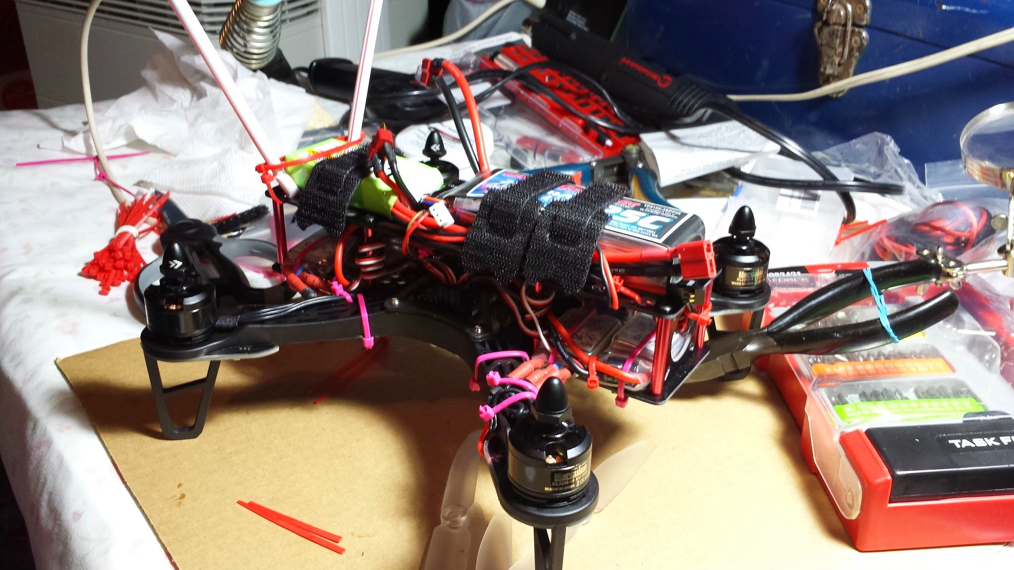

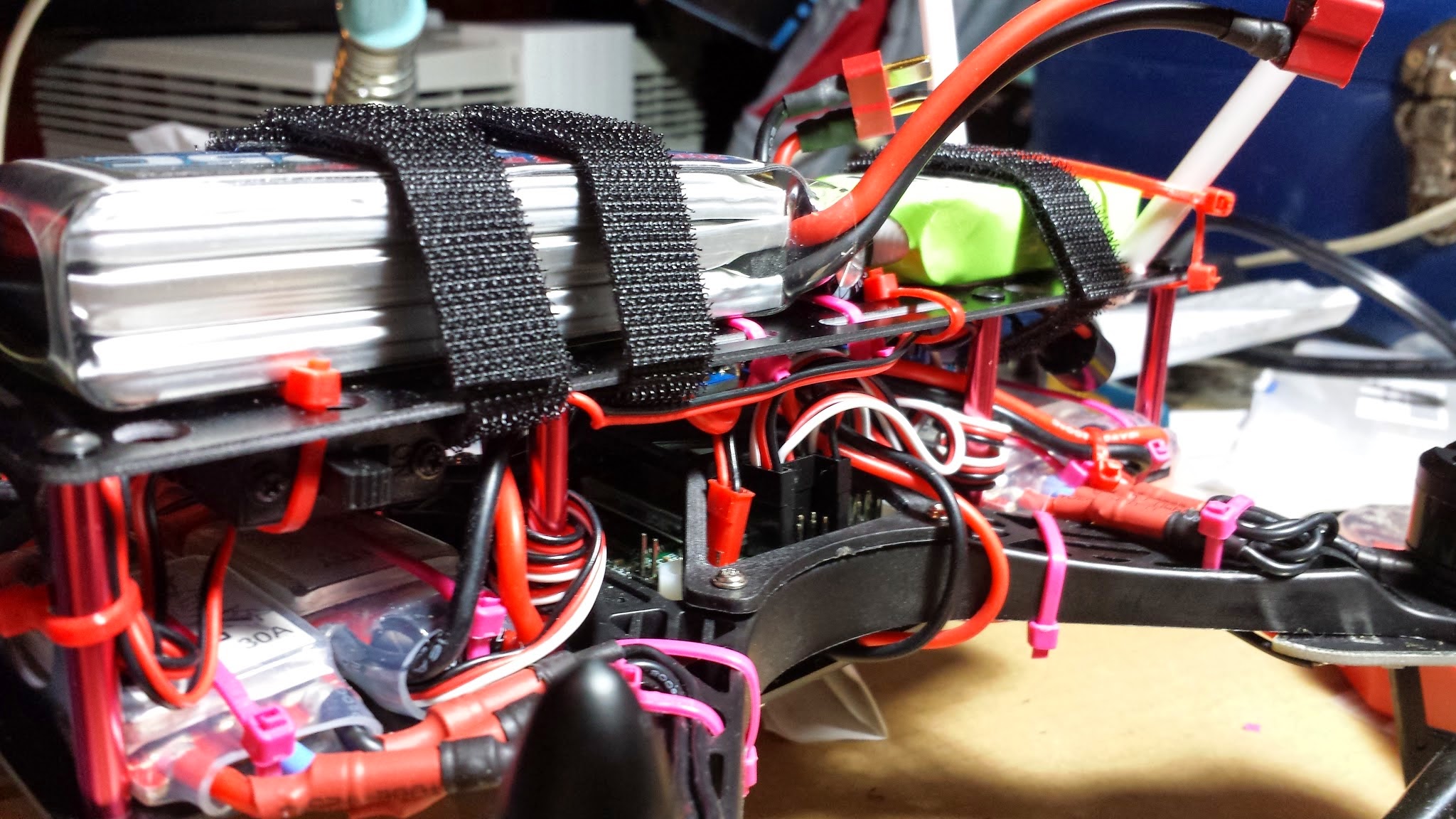

G+_Andrew Schwenk Posted May 18, 2015 Share Posted May 18, 2015 Multicopter question. Hi, I'm building a 250 quad and I'm having some troubles getting the receiver to work. I basically followed the Alienx build and ordered all my parts seperately. The only things I switched out are the motors, I'm using RTFQuad's HL2208-15 KV:1100. Esc's, and flight controller are the same. For a transmitter/receiver I'm using the Airtronics Aquila-6 channel 2.4 GHz. The batteries, if it matters are Thunder Power RC 2100mAh 3-Cell/3S 11.1V G8 Pro Lite Plus 25C LiPo Battery, and HOBBICO LiFeSource LiFe 6.6V 1100mAh 10C Rx U Connector HCAM6416. I'm using the LiPo to power the motors/esc/flight controller/lights, and the LiFe for the receiver only. Although when I turn the receiver switch on it seems to turn some of the lights on as well as the flight controller. I also have a Spektrum Voltage Protector somewhere in there. Here's the problem, when I turn everything on I get a beep and all the lights come on, but when I go to the receiver test screen it has no signal. I've checked and double checked my connections and I can't find a problem. Could it be a hardware issue? Please help, I'm a first time builder and I'm in $600 with no way out. Thanks Link to comment Share on other sites More sharing options...

G+_610GARAGE Posted May 18, 2015 Share Posted May 18, 2015 First get rid your second battery and see if it works. If it doesn't (leave the secondary battery disconnected while troubleshooting), connect an esc directly to your receiver to determine whether it works or not. If the motor doesn't spin up, then something is wrong with your remote. If it does, try running a dedicated wire for each output of the transmitter to your flight controller. Just curious, why do you have a transmitter only battery? Link to comment Share on other sites More sharing options...

G+_Andrew Schwenk Posted May 18, 2015 Author Share Posted May 18, 2015 Hey everyone. thank you for the suggestions. I tested all the escs directly from the receiver and they work. The reason behind the two batteries is Airtronics says not to use anything over 4.8.~6.6v and my LiPo is an 11.1v. But it seems when I plug them both into the quad the KK is drawing power from both sources through the receiver. When powered on I can get number inputs to read from the KK when moving the remote sticks. But it still says no signal in some of them, could something be when going through the flight controller? Also the quad constantly beeps when turned on, is that good/bad/ no concern? Thanks all Link to comment Share on other sites More sharing options...
G+_610GARAGE Posted May 18, 2015 Share Posted May 18, 2015 You don't need the second battery. The esc convert the battery voltage to 5V for the flight controller and receiver. If you connect the transmitter to the flight controller and an esc to the first motor output of the flight controller, then the esc and the battery is going to be fighting each other for power. I would highly recommend removing the second battery and see if that works. When you have two pieces of electronics communicating to each other on separate power sources, things can get wonky pretty fast. I get beeping from my quad when the esc aren't getting a signal from the flight controller. If you are messing around in the menu of the kk, this would be normal. Link to comment Share on other sites More sharing options...
