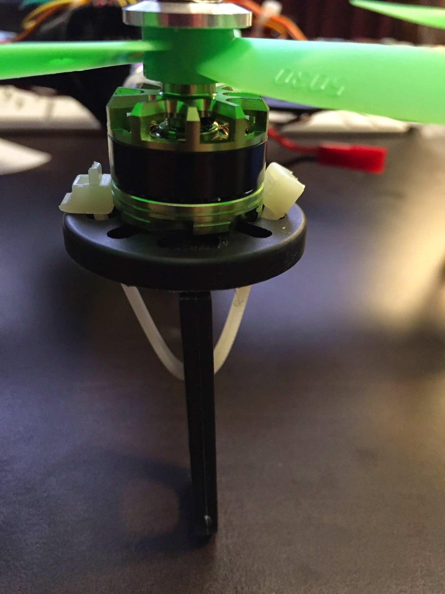

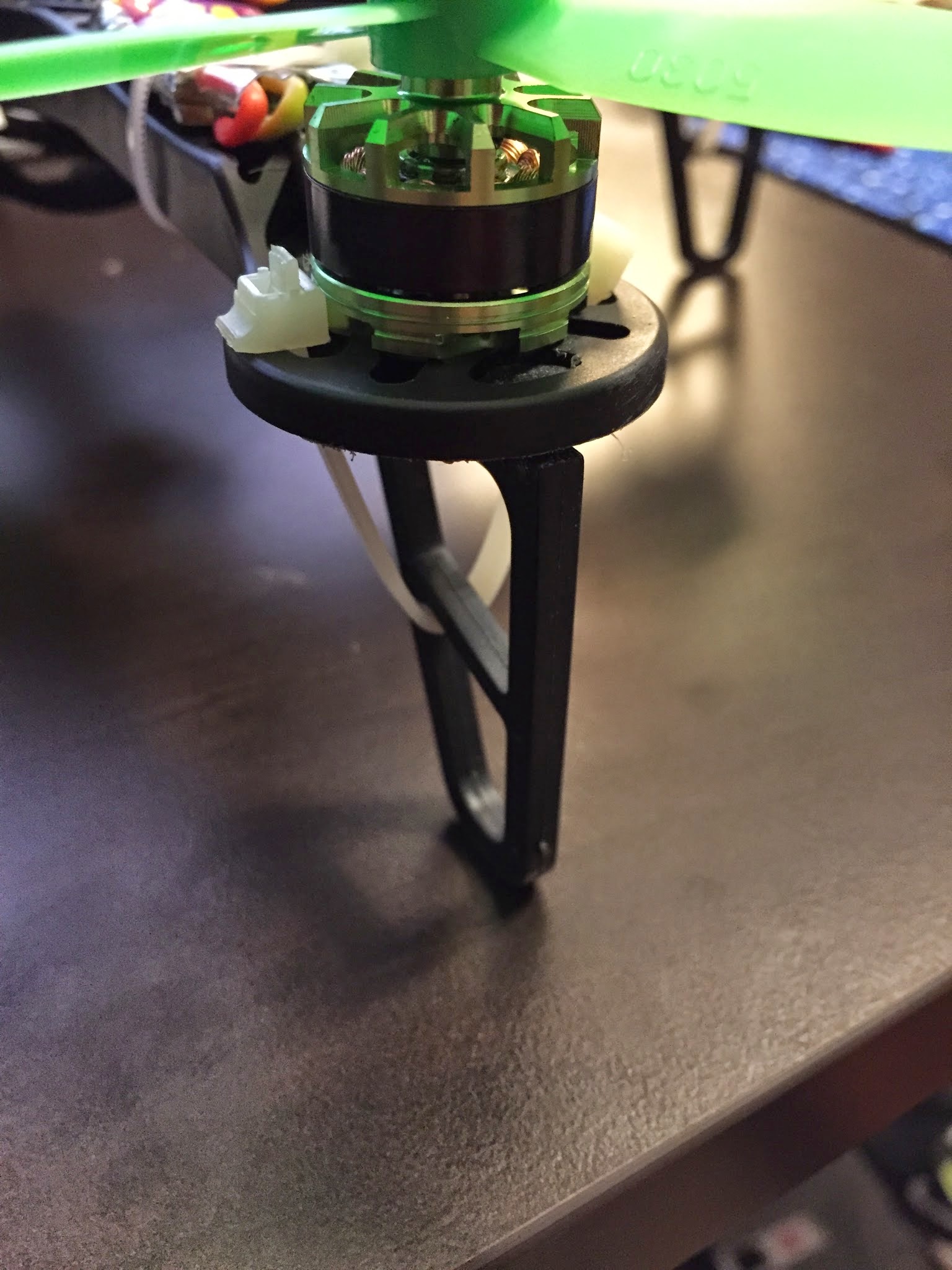

G+_Barry Brown Posted January 20, 2015 Share Posted January 20, 2015 I came up with a solution for attaching the legs to the FPV250 frame. First, I used a couple of drops of fresh CA on each leg. Then I used zip ties to hold the legs in place. I had some ties with "heads" that were large enough to not slip through the holes in the frame, but small enough that they don't interfere with the spinning motor. Two ties were used: one as the strap and one is just the head to hold the strap in place. I haven't landed hard yet, but so far it's working! Link to comment Share on other sites More sharing options...
G+_Fr. Robert Ballecer, SJ Posted January 20, 2015 Share Posted January 20, 2015 Yuup... this is pretty much what I do... I'll show a few different ways to do it on Thursday's KH. Link to comment Share on other sites More sharing options...
G+_Michael Heinz Posted May 2, 2015 Share Posted May 2, 2015 Be warned, though - it's still possible to break the legs off. Apparently tall grass can be all it takes. :-( Link to comment Share on other sites More sharing options...
