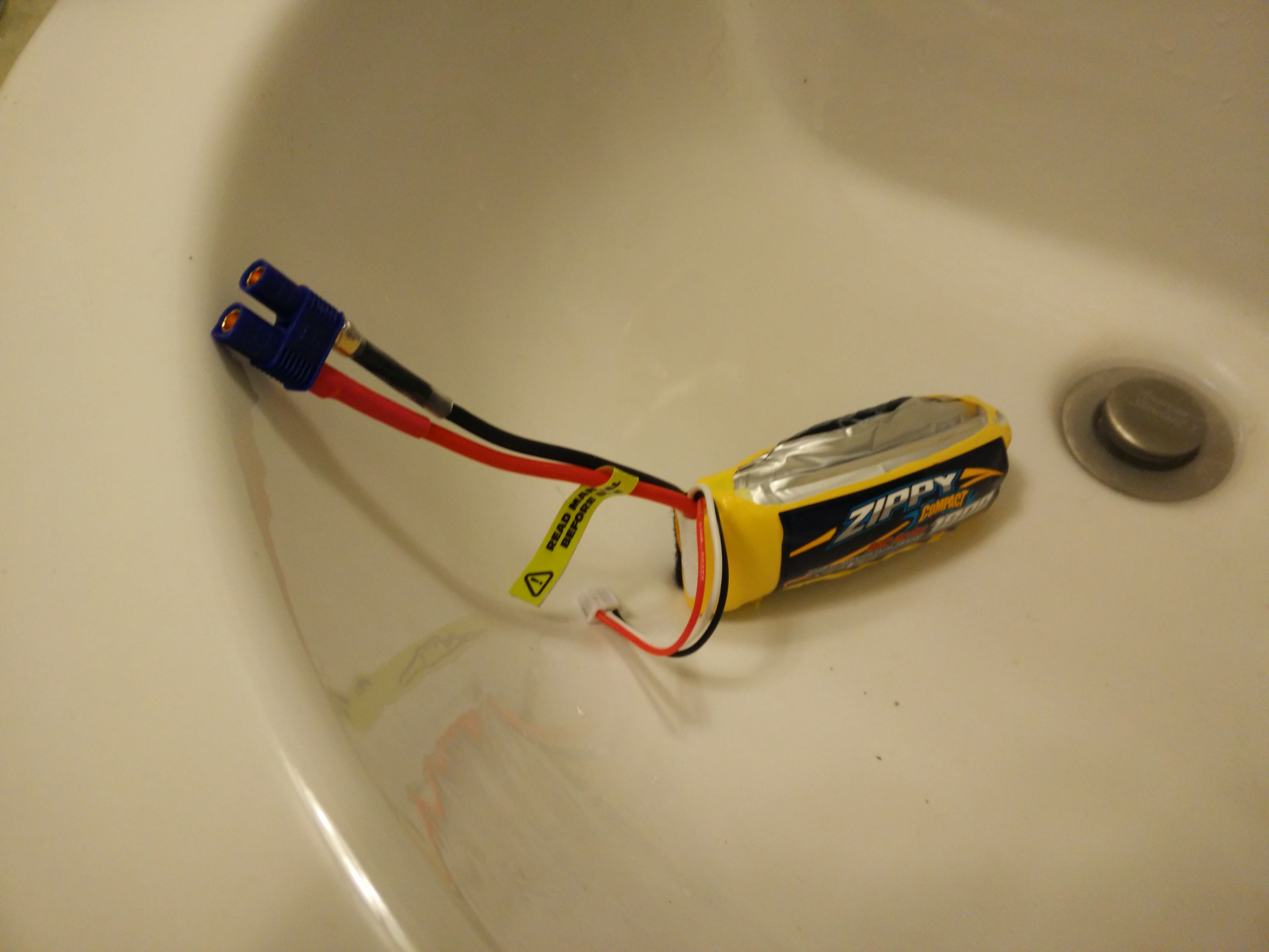

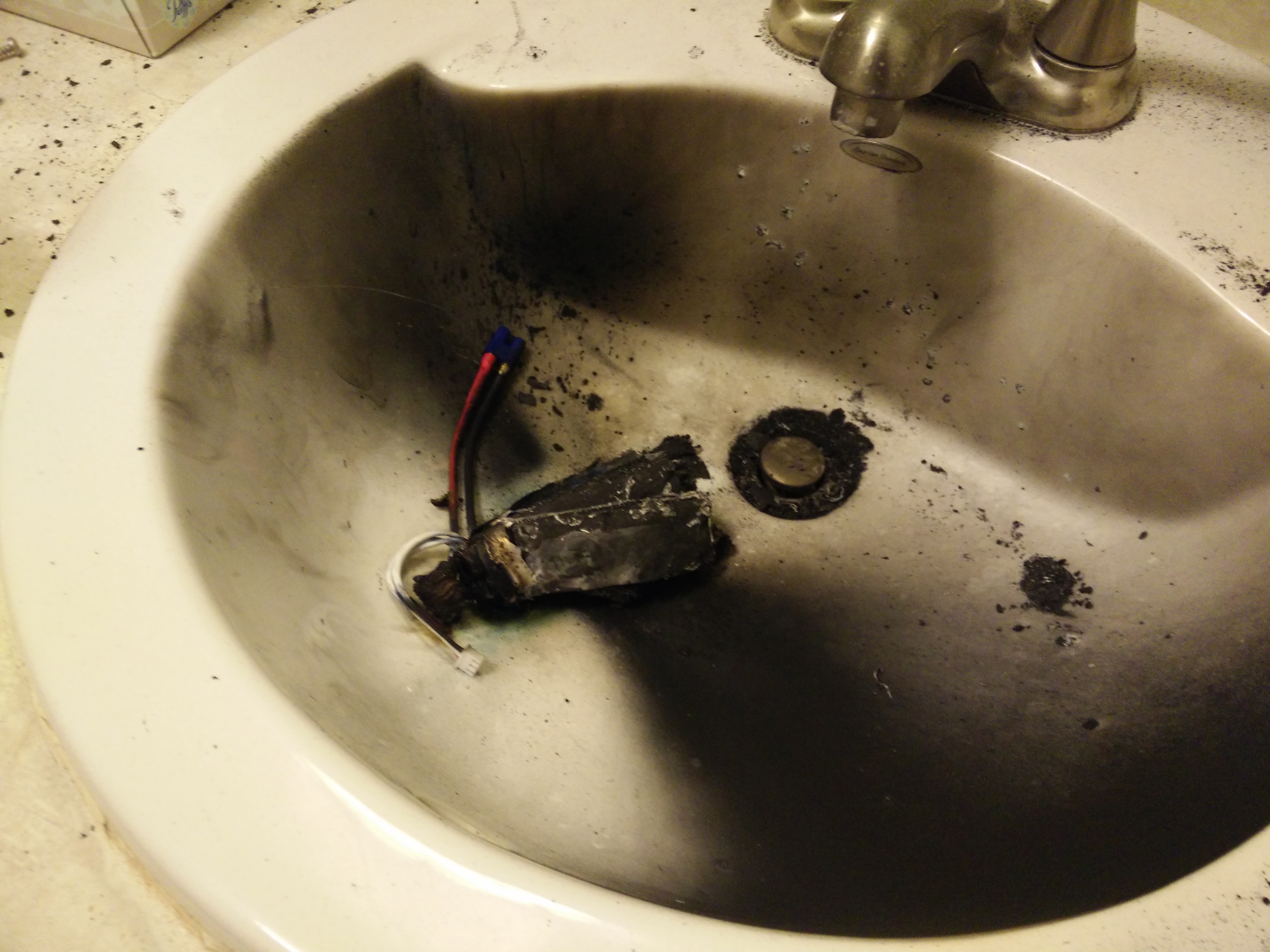

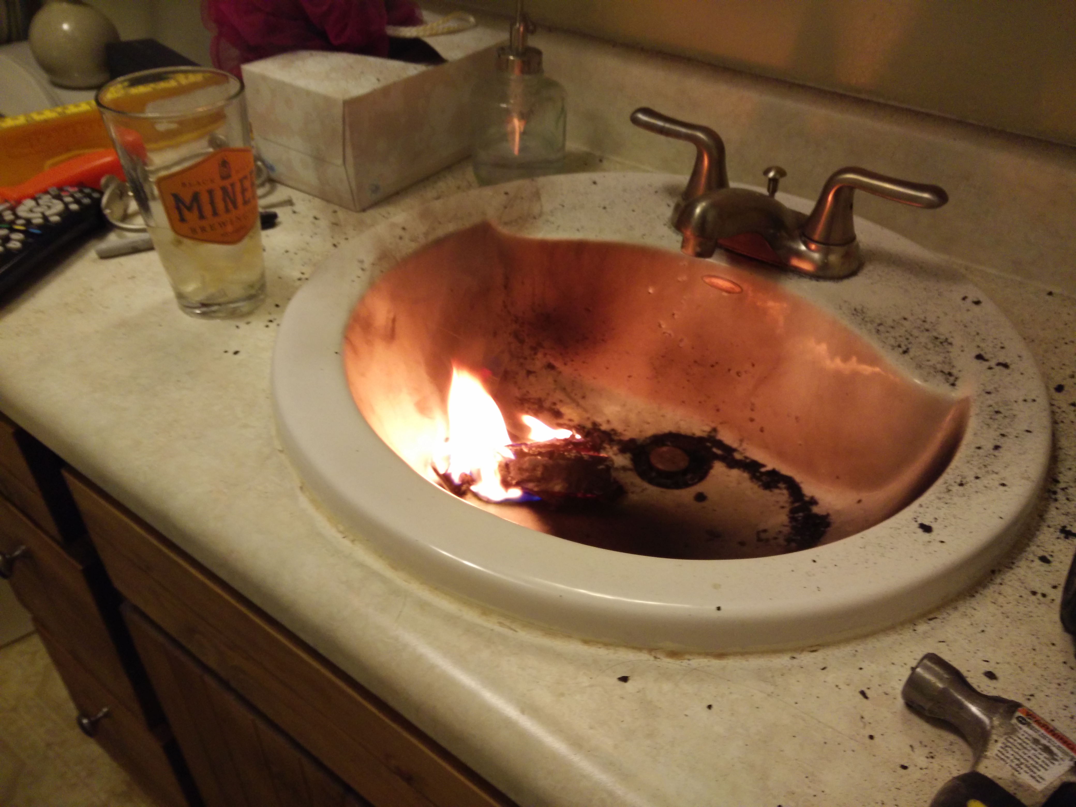

G+_jmadig Posted July 6, 2015 Share Posted July 6, 2015 Hey Padre and Bryan, Just a friendly reminder to the community to be careful with LiPo charging. While charging this 2S batttery, I heard a pop accompanied by clear fluid leaking onto my new kitchen countertop. I quickly threw the offending LiPo into the bathroom sink while attending to the ?acid? on the counter top. Within 90 seconds a raging chemical fire had erupted that was contained by the porcelain sink. This certainly would have be catastrophic had I not been within earshot. From now on, I will do my charging in the seldom used fireplace! Thanks for all the great knowledge, you guys rock! Jim Anchorage, AK Link to comment Share on other sites More sharing options...
