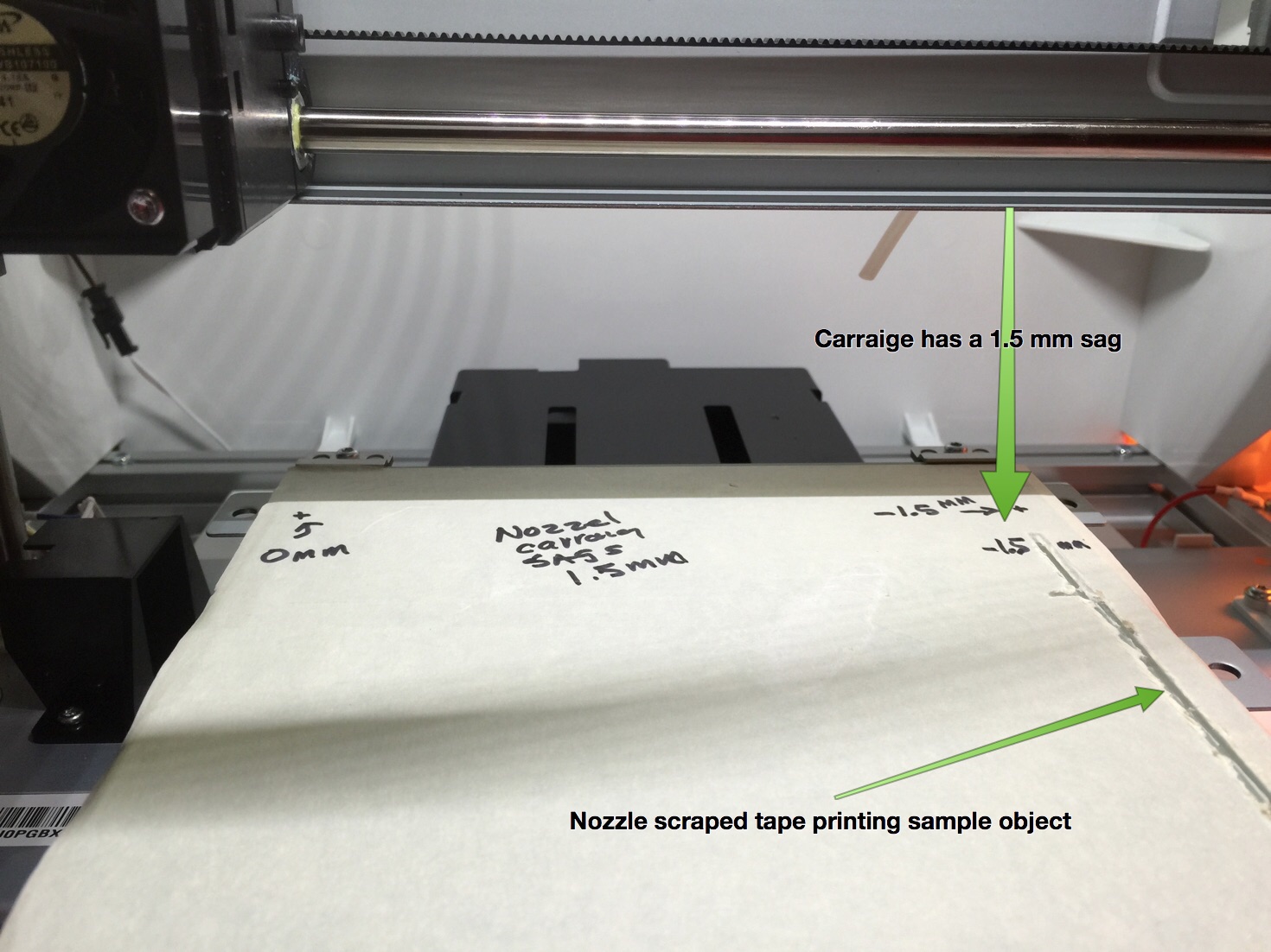

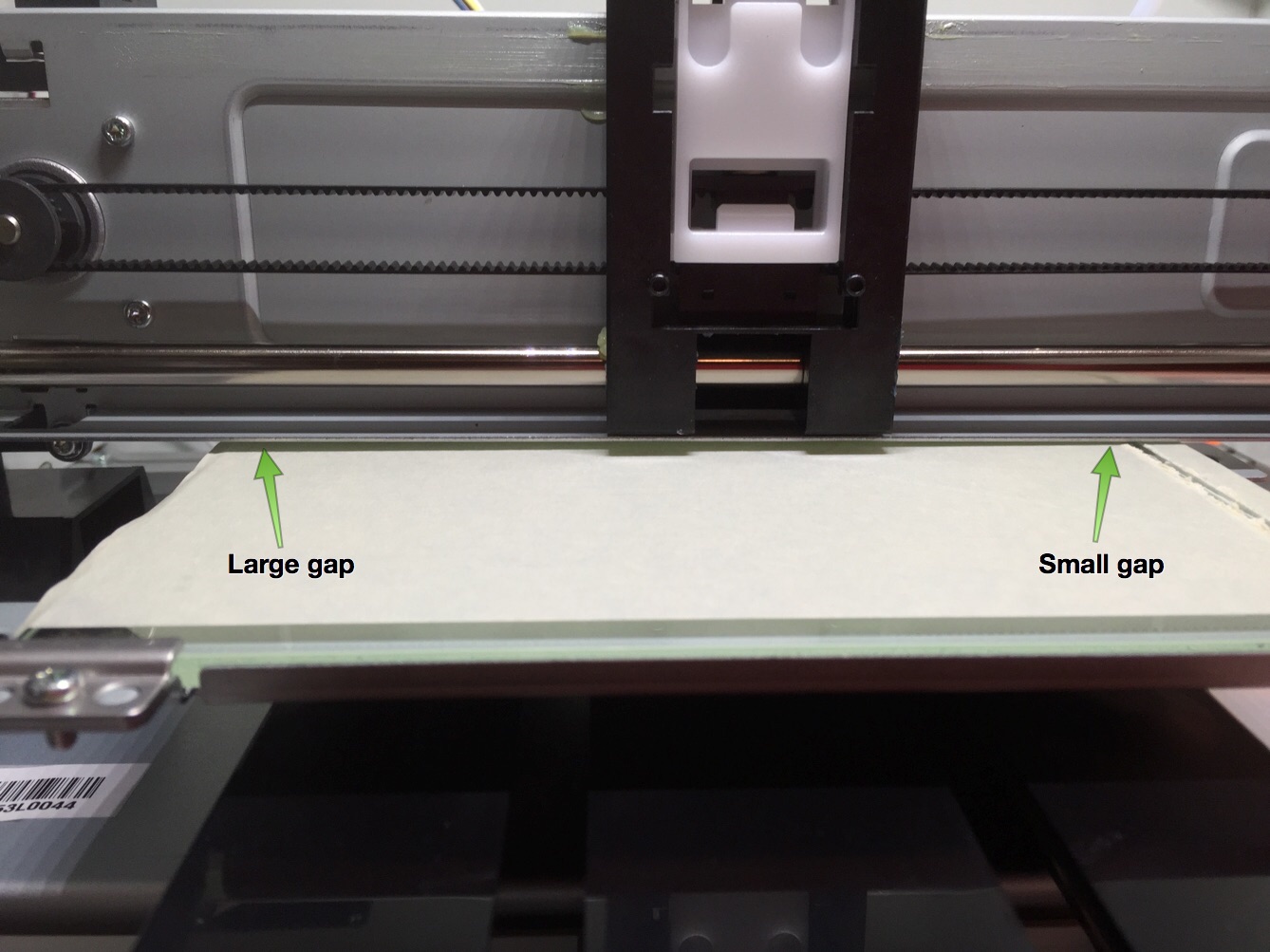

G+_Robert Rydeen Posted May 8, 2015 Share Posted May 8, 2015 I just got my da Vinci Junior 3-D printer and discovered that the distance between the nozzle and the bed is off by 1.5 mm from the left edge to the right edge. I don't see how to correct this discrepancy. Is this unit defective? See the pictures below for clarity.? Link to comment Share on other sites More sharing options...
G+_Robert Rydeen Posted May 9, 2015 Author Share Posted May 9, 2015 Thanks for the input. The video is not for my model which is supposed to not need calibration. I thought about using a dial indicator but didn't know how to mount it but this video reminded me I could just make a mount. I did end up shimming the base platen glass and got it parallel to the nozzle plane. It does work OK but a little worried that the nozzle carriage may have been bent in shipping so still not sure if I should get it exchanged (Amazon). I am hoping the TWIT Know How folks will address this on their unit. Link to comment Share on other sites More sharing options...

G+_William Steele Posted October 12, 2015 Share Posted October 12, 2015 FYI, for others that have the same issue... there are two Torx T10 screws on the left of the gantry... you can loosen them and adjust the arm to the correct height and re-tighten them to correct for the droop. Link to comment Share on other sites More sharing options...
