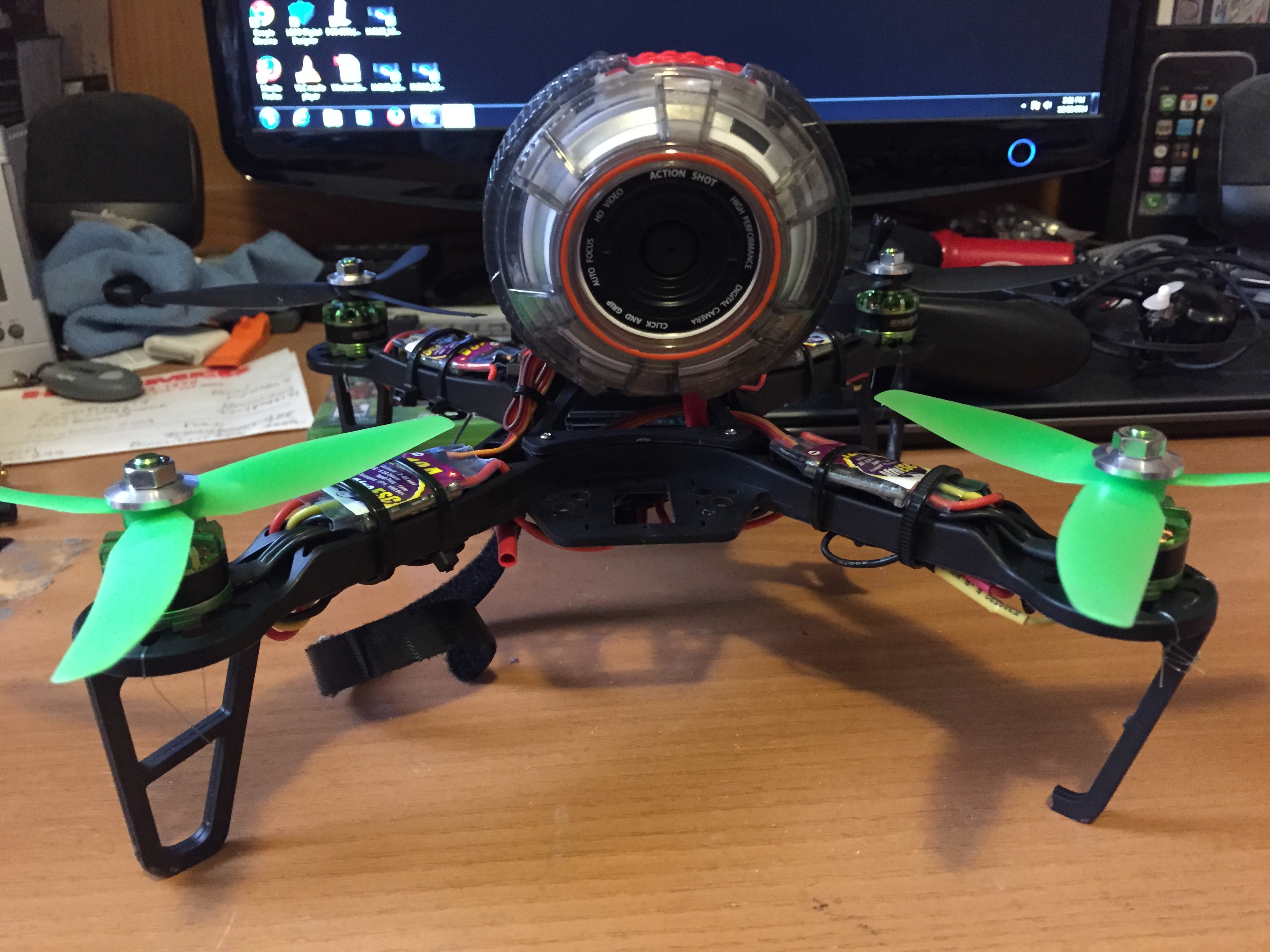

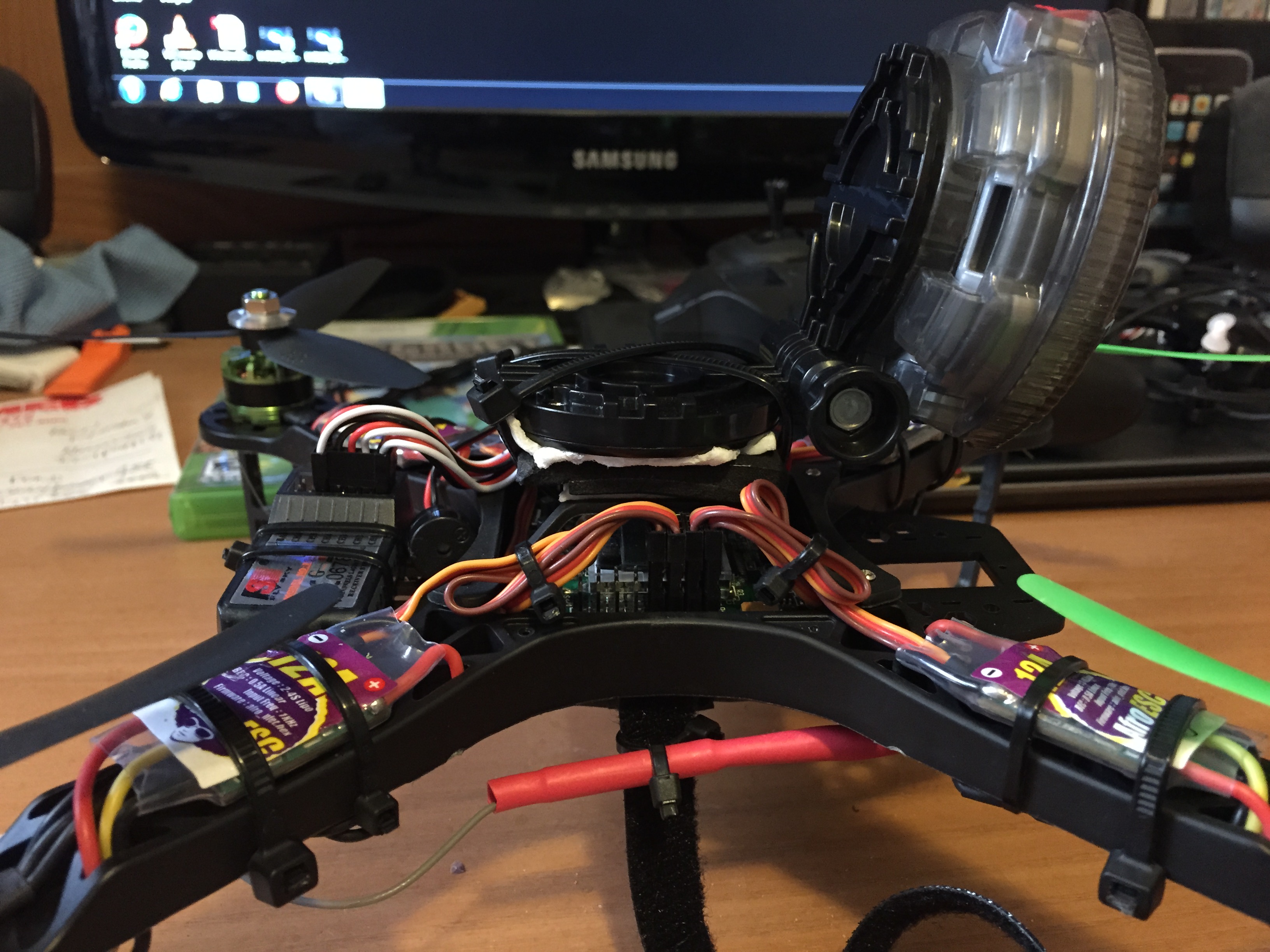

G+_Rob Yesta Posted December 28, 2014 Share Posted December 28, 2014 Do you think this will work? It's a cheap $40 Action Cam. Lighter than a GoPro. I don't want to trash a good GoPro learning to fly. I added foam between the Quadcopter body and mount. Or should I just wait to get cage? End goal will be adding FPV next spring once I get good at flying the FPV250. Link to comment Share on other sites More sharing options...
G+_chris miller Posted December 28, 2014 Share Posted December 28, 2014 I would have started with a #808 16 key chain cam. That thing looks big and bulky. It just sticks up so high looks like it's going to be too heavy. Just my opinion Link to comment Share on other sites More sharing options...
G+_chris miller Posted December 28, 2014 Share Posted December 28, 2014 Pretty little quad Link to comment Share on other sites More sharing options...
G+_Taylor Graham Posted December 28, 2014 Share Posted December 28, 2014 You'll definitely feel the weight and drag. Your flight times will also suffer. With all the compromises, you might want to just get a cheap low profile camera like a mobius (only 40g!). Link to comment Share on other sites More sharing options...

G+_Taylor Graham Posted December 28, 2014 Share Posted December 28, 2014 Well, if you've got the lift, you can carry it! You might get a lot of jello in your video because of the way the camera is mounted. Velcro is good for reducing jello, but that camera is really tall. You might not be able to prevent it. You'll see how it is when you test it though! Link to comment Share on other sites More sharing options...
G+_Tom Nardi Posted December 29, 2014 Share Posted December 29, 2014 Like already suggested, a #808 cam would make a lot more sense, or better yet a Mobius. But if you've already got this one, I guess it's worth a shot. Link to comment Share on other sites More sharing options...
G+_Conan Mills Posted December 29, 2014 Share Posted December 29, 2014 I don't see why not. Like Stan, I would be worried about the CG as well. Just make sure you can balance it out with the battery. Were you going to use this for your FPV camera? If so, make sure it has the capability to do live video out. Link to comment Share on other sites More sharing options...
