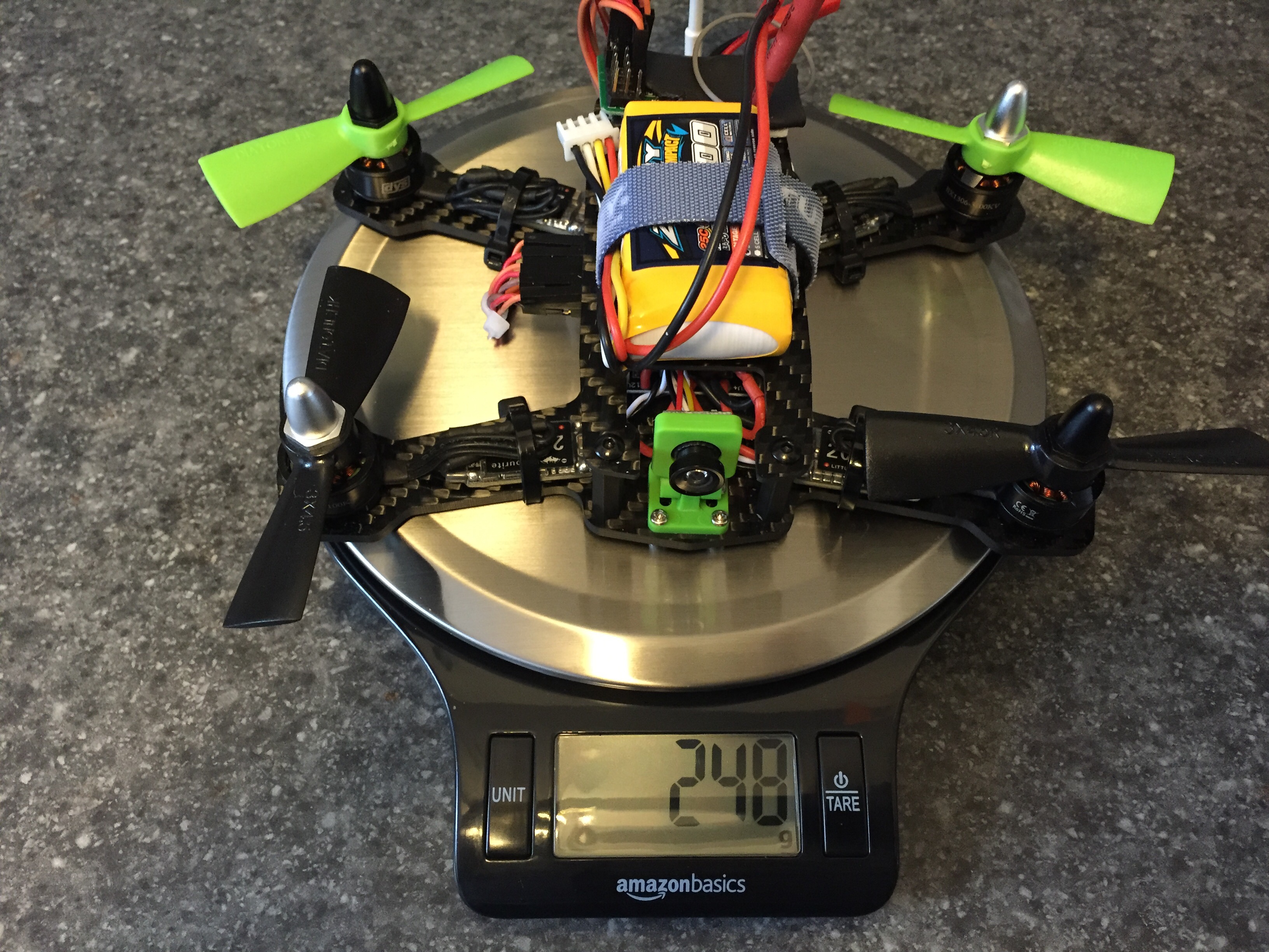

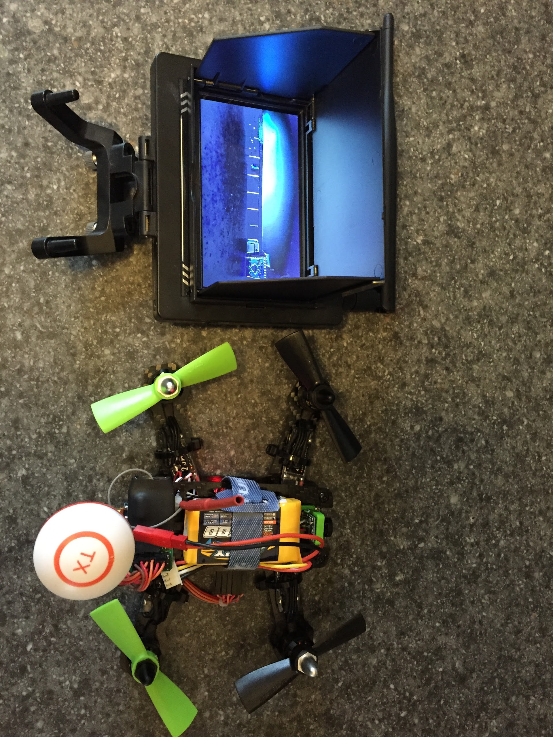

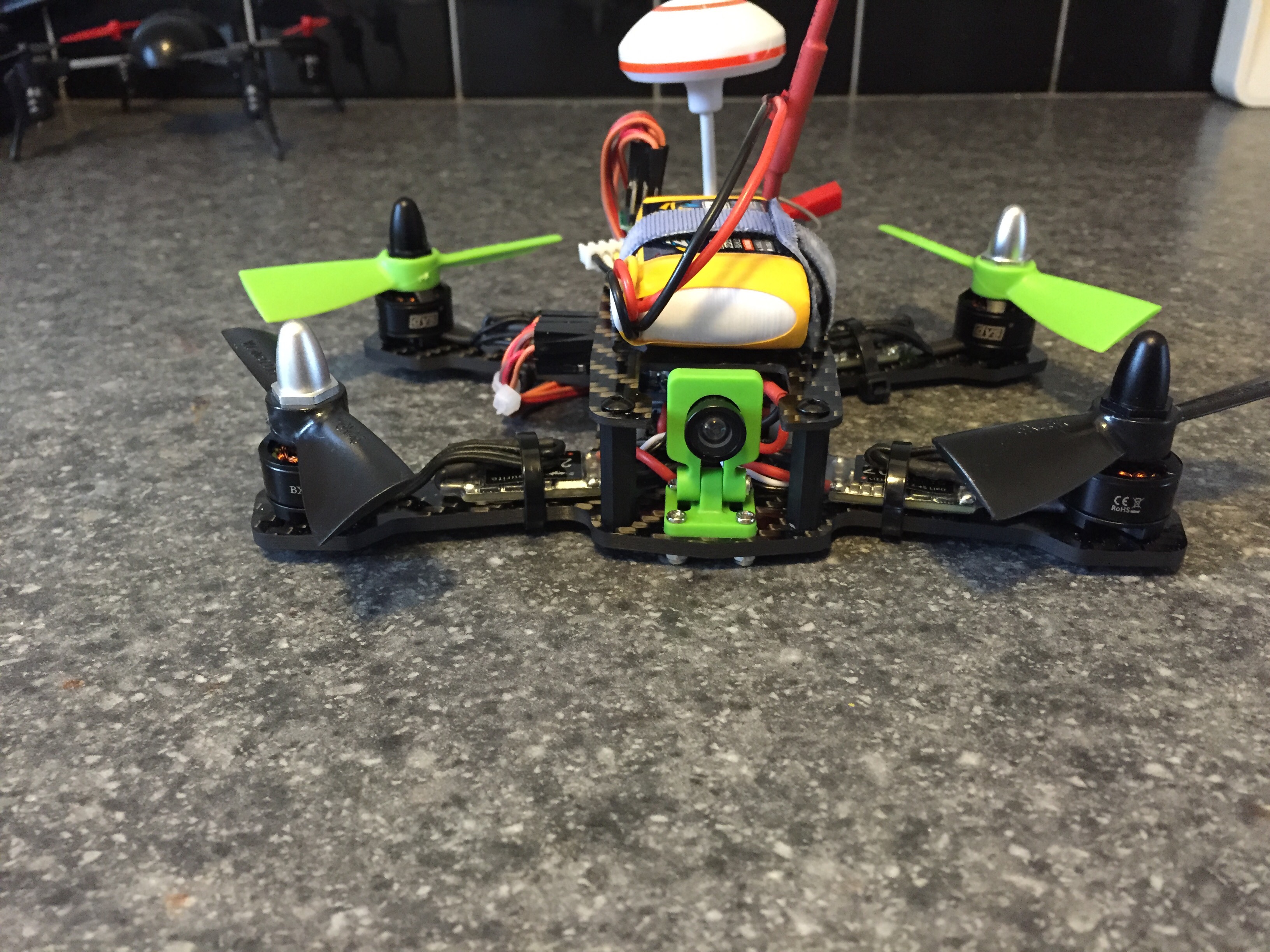

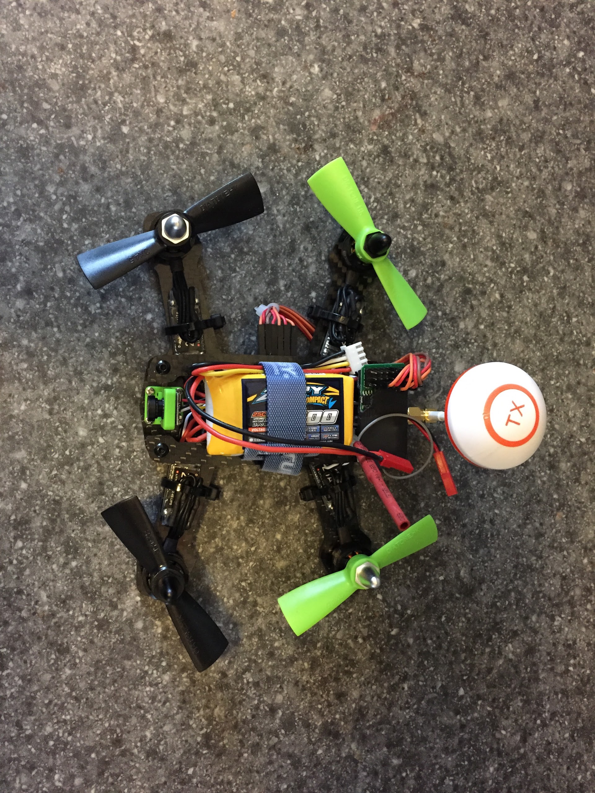

G+_Rob Yesta Posted March 31, 2016 Share Posted March 31, 2016 My 160 done and still shaving weight.?new flight controller and direct solder wires will help. Antenna without plastic cover for FPV. Velcro adds weight on little builds but the safety of double Velcro to keep battery in place is worth the grams. Link to comment Share on other sites More sharing options...
G+_Daniel Kesler Posted April 1, 2016 Share Posted April 1, 2016 Do you have a build list for this quad? Link to comment Share on other sites More sharing options...
G+_Rob Yesta Posted April 1, 2016 Author Share Posted April 1, 2016 Diatone ZMR160 frame FVT Littlebees 20A Esc DYS 1306-3100 Motors Diatone 3045 Propellers Sky zone TS5813S Mini FPV Transmitter 600TVL Mini Camera 170 view Antenna cloverleaf wired Flip 1.5 Flight Controller zippy Compact 500mah Battery http://m.banggood.com/Diatone-ZMR-Series-ZMR160-Carbon-Fiber-Frame-Kit-With-BEC-Board-RC-Multirotor-p-1020633.html http://m.banggood.com/4X-FVT-LittleBee-20A-ESC-BLHeli-OPTO-2-4S-Supports-OneShot125-For-RC-Multirotors-p-1031934.html http://m.banggood.com/DYS-1306-3100KV-BX-Series-Brushless-Motor-For-Multicopter-CW-CCW-p-962149.html http://m.banggood.com/Diatone-3045-34_5-Propeller-2xCW-and-2xCCW-For-RC-Multirotors-Orange-Black-Green-p-1028618.html http://m.banggood.com/Skyzone-FPV-TS5813S-5_8G-25mW-40CH-Mini-AV-Wireless-Transmitter-For-Mini-Multicopter-QAV250-p-1021364.html http://m.banggood.com/600TVL-8_0MP-14-2_8mm-CMOS-FPV-170-Degree-Wide-Anlge-Lens-Camera-PALNTSC-p-984345.html http://www.hobbyking.com/mobile/viewproduct.asp?idproduct=25505 Link to comment Share on other sites More sharing options...
