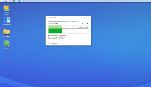

G+_Alex Martinez Posted May 5, 2018 Share Posted May 5, 2018 Really like the Synology episode hope they keep coming!. I remember they did a small example on the screen savers of Padre setting up routing computers though a vpn in Synology if I remember correctly. Hope he finds time to show how he did that in more detail. But I wanted to ask if anyone on here would know why Im having problems transferring files from my Synology it limits the transfer speed at 10mbs to 11 and takes forever on what ever I do . I have cat 6 and gigabit on all my computers. I'm using to tplink archer C7 router with ddwrt on it and a tplink switch. So if anyone can give me some tips why the transfer rate is so low I would appreciate it . Link to comment Share on other sites More sharing options...

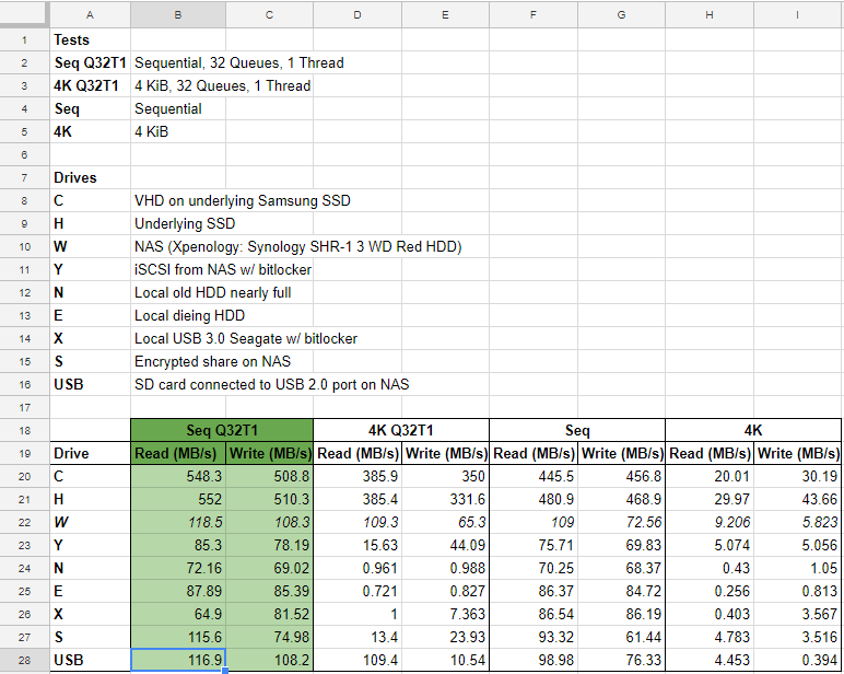

G+_Ben Reese Posted May 6, 2018 Share Posted May 6, 2018 So, I ran Crystal DiskMark on a bunch of different storage options, and here's what I came up with. Sorry for the terrible presentation of data. TL;DR: everything was faster than 10 MB/s on sequential read/write. C and H drives are SSD, so they're expected to be fast. W, Y, S, and USB are all on the NAS, so probably closest to your example. I moved a 12 GB folder to W-drive to validate the 100+ MB/s write speed. USB is connected to a USB 2.0 port on the NAS. Local HDDs E and N are both way too full, so I expected bad performance from them. So, I'm not sure what would cause your slow transfer speed. I'd look at the network again though to make sure your NAS or PC isn't stuck on 100 Mbps networking. Link to comment Share on other sites More sharing options...

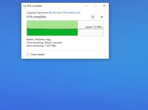

G+_Alex Martinez Posted May 6, 2018 Author Share Posted May 6, 2018 Damn thanks ben and everyone for giving me the tips. I took some time after reading everyone comments and decided to rewired the Ethernet cable between the router and switch ( also changed it from TIA-568A to TIA-568B) .I also saw that cable was on port 5 not port 1 on the switch so i put it on port 1 ( not sure if that made any difference). I dont know which one fixed it but now im getting 100MB/S now. But im wondering i wired most of the Ethernet wiring in my home with TIA-568A and some are TIA-568B does that cause conflict if those two standards are on the same network? Link to comment Share on other sites More sharing options...
