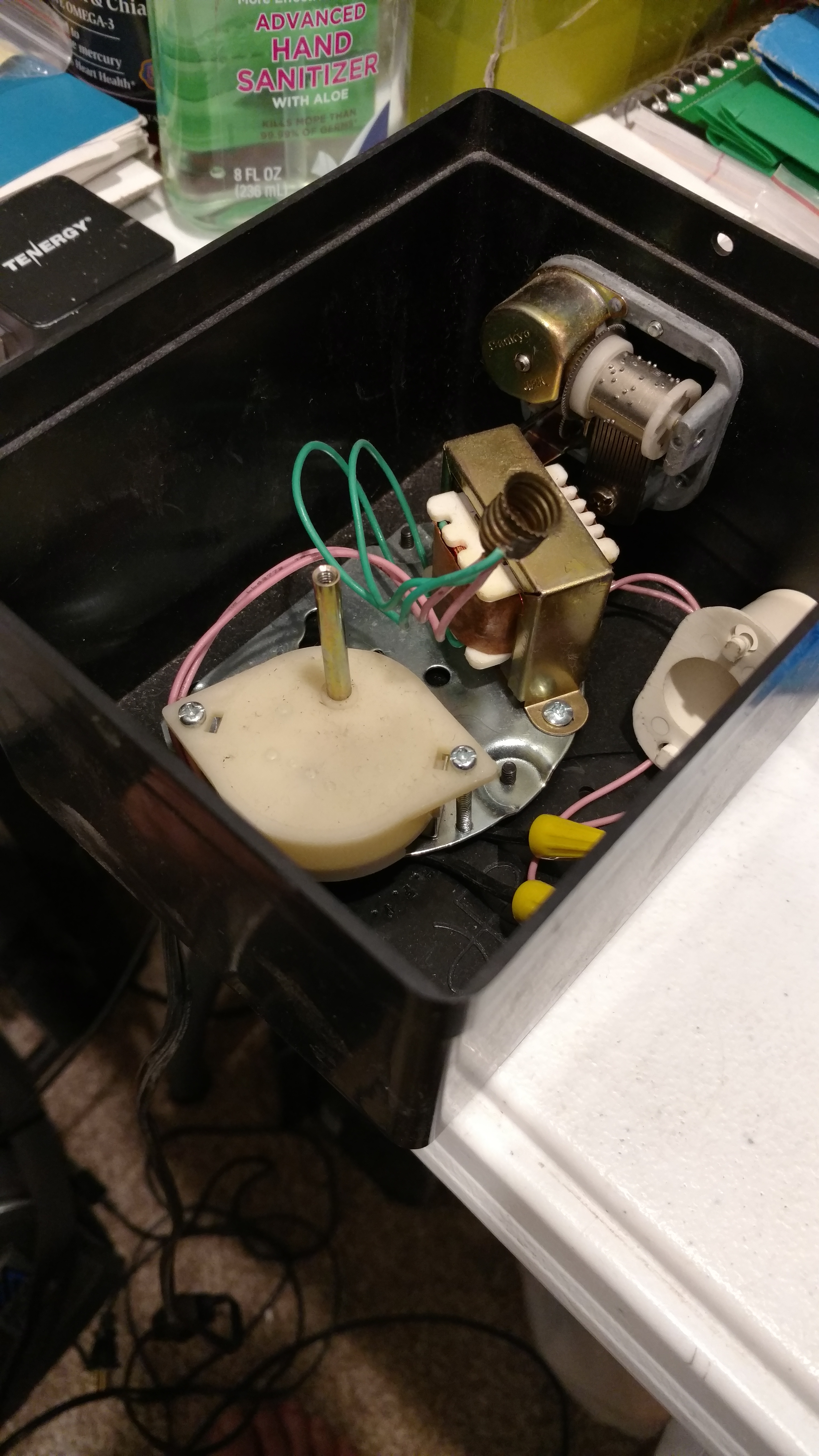

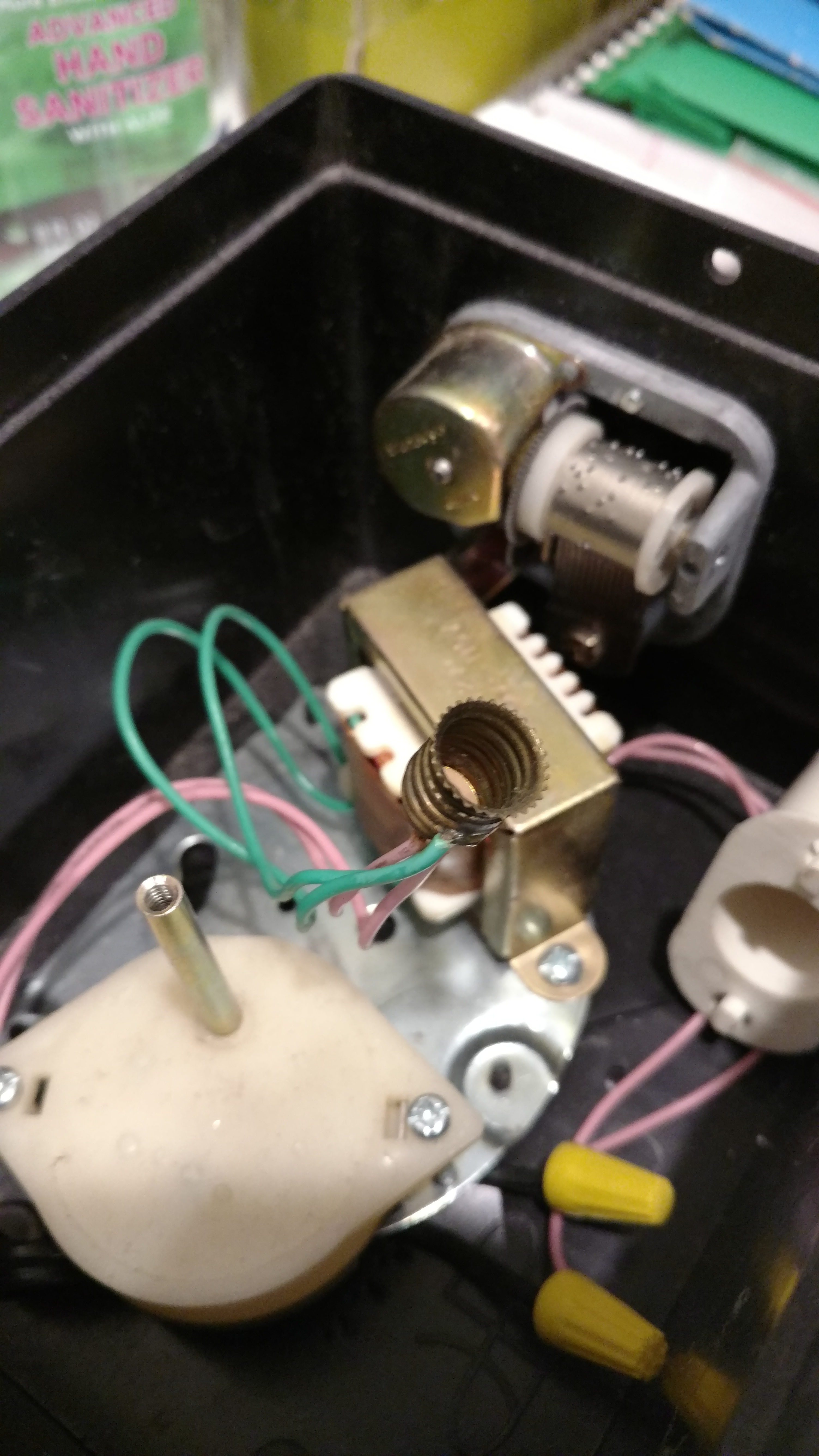

G+_Alex Martinez Posted July 12, 2017 Share Posted July 12, 2017 Im Trying to find a bulb that will work on this little music box but I'm seeing it's throwing out ac 12volts not dc . And I just can't seem to find any bulbs that are ac this small just dc . Just thought I ask on here maybe someone can help me find the right bulbs Link to comment Share on other sites More sharing options...
G+_Black Merc Posted July 12, 2017 Share Posted July 12, 2017 Here is the problem... That (I'm going to guess) music box was probably made before the existence of led's. Therfore to the original lamp(resistive wire filament) 12v is 12v ac or dc. To employ a led based lamp (unless a manufacturer can be found) you will have to modify the device to output dc. I recommend a full bridge rectifying circuit, one stiffening capacitor, then the led. Link to comment Share on other sites More sharing options...
G+_Ben Reese Posted July 12, 2017 Share Posted July 12, 2017 Hopefully someone can confirm or deny, but I don't believe there is any difference between a DC and AC incandescent bulb. I'd expect 12v DC to be brighter than 12v AC, but either should be fine. That said, I think something like this should work: Eiko 6S6/12V S-6 Candelabra Base Halogen Bulb, 12V/6W https://www.amazon.com/dp/B001D966OQ/ You'll need to verify the size first, just to be sure, but I think something like this would work. amazon.com - Eiko 6S6/12V S-6 Candelabra Base Halogen Bulb, 12V/6W - - Amazon.com Link to comment Share on other sites More sharing options...

G+_Ironbat Cave Posted July 12, 2017 Share Posted July 12, 2017 Honda big red trike headlight bulbs will work. Motor throws ac voltage instead of dc. Got some for around $7 on ebay. Link to comment Share on other sites More sharing options...
G+_William L. DeRieux IV Posted July 12, 2017 Share Posted July 12, 2017 Alex Martinez You will probably need to look at replacement bulbs for book lights and/or mini-automotive light bulbs (probably around 8 watts). amazon.com - 8 Watt / 12 Volt Book Light Replacement Bulb - Incandescent Bulbs - Amazon.com Link to comment Share on other sites More sharing options...
G+_John Sullivan Posted July 13, 2017 Share Posted July 13, 2017 Incandescent bulbs don't know the difference between ac and dc. They're just a piece of wire ... they don't care which way the current flows through them. Link to comment Share on other sites More sharing options...
