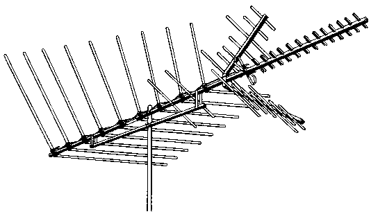

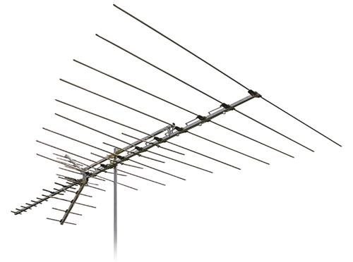

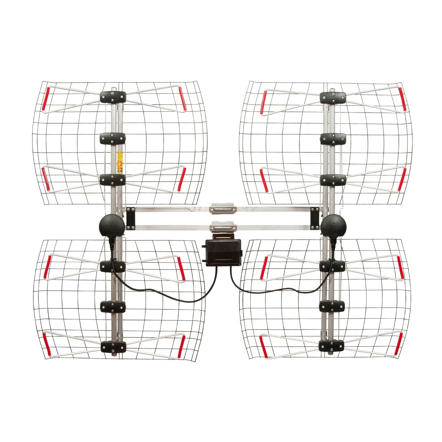

G+_Frederick Holtsberg Posted March 31, 2016 Share Posted March 31, 2016 So I have a question to throw out to the Know How community. No it is not Quadcopter related, sorry. I live in a rural area and it is time to update my outdoor TV antennae. Nine years ago I got a radio shack antennae First Picture It was OK when it was not falling apart. I have been doing research and have narrowed my choice down to two. Xtreme Signal HD8200XL Long Range HDTV VHF/UHF/FM Antenna (Second Picture) 8 Element Bowtie Indoor/Outdoor HDTV Antenna (Third Picture) They both seems good choices but what would you recommend? I am also open to other suggestions…. Link to comment Share on other sites More sharing options...

G+_G Riedell Posted April 1, 2016 Share Posted April 1, 2016 Frederick Holtsberg?? - the larger the antenna, the more it will be affected by wind and ice. But if you're only sometimes in the cross-hairs, or not too worried, most consumer solutions should be fine. If you need VHF reception, nix the bowtie-type antenna, it's not going to do well on those channels. With digital, you may find that you want a fairly clear path to the transmitter site, leaves on trees and precipitation can mess with signal strength... though, at only 50 miles you may be okay. At nearly 100 miles, I need 45+ feet of tower and a booster / amplifier... and when it rains, I'm not watching anything but "no signal". I've used Winegard antennas recently with good results... 79xx and 8xxx series options. Unfortunately, the only opinion that I can provide on the Xtreme Signal 8200 is that it appears very similar both physically and to specs of the Winegard HD8200U... so perhaps they are the same and it should be fine. Also, be aware that you want a short run of quality coax from the antenna to the set(s)... and perhaps an amp if you're running to multiple sets / boxes.? Link to comment Share on other sites More sharing options...

G+_Frederick Holtsberg Posted April 1, 2016 Author Share Posted April 1, 2016 George Riedell A big thanks. I looked up what stations I would want and they all broadcast VHF. I think the bow-tie is out. Link to comment Share on other sites More sharing options...
G+_G Riedell Posted April 2, 2016 Share Posted April 2, 2016 Frederick Holtsberg - You're very welcome. Glad to help. I would normally advise to check if the stations are VHF-high (channels 7-13) or VHF-low (channels 2-6), as some smaller-sized antennas omit the lower channels so that they can eliminate the longer elements from their design. IIRC, that 8200XL covers the full-range (the 79xx series Winegards omit the VHF-low - again IIRC). Keep that in mind also if you opt for another antenna. Link to comment Share on other sites More sharing options...
G+_William Walimaki Posted April 2, 2016 Share Posted April 2, 2016 I have a Winegard HD8200 which I ordered from Solid Signal couple yrs back. Works pretty well for me. The most distant station I can pick up with it is 88 mi away (straight line) which is good since we live in a shallow valley with trees in the way. I could actually use a rotator because there are stations in two other directions. Maybe check out the Solid Signal Xtreme Signal VHF/UHF Outdoor Yagi HDTV Antenna (HDB91X) too which works well. Link to comment Share on other sites More sharing options...
