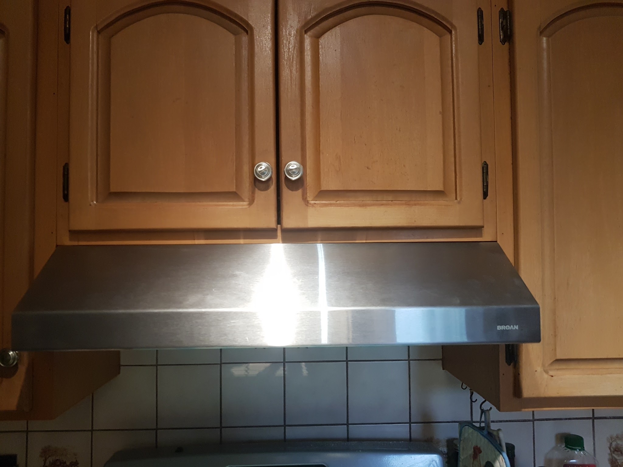

G+_Jason Perry Posted April 29, 2017 Share Posted April 29, 2017 +John Sullivan, not as exciting as your project. Just putting up a new range hood Link to comment Share on other sites More sharing options...

G+_Jason Perry Posted April 30, 2017 Share Posted April 30, 2017 Ben Reese?, I try to wait for the newness of it to ware off before I hack it. It gives my wife one less thing to use against me. I do have the schematic for it and I will be keeping it in a safe place. Any suggestions ?? There is a lot of empty space in there. Link to comment Share on other sites More sharing options...
