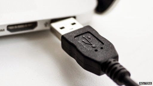

G+_George Kozi Posted October 6, 2014 Share Posted October 6, 2014 Mike Elgan Originally shared by BBC News Code that turns USB devices into cyber-attack platforms has been released online http://bbc.in/1xWins6 Link to comment Share on other sites More sharing options...
