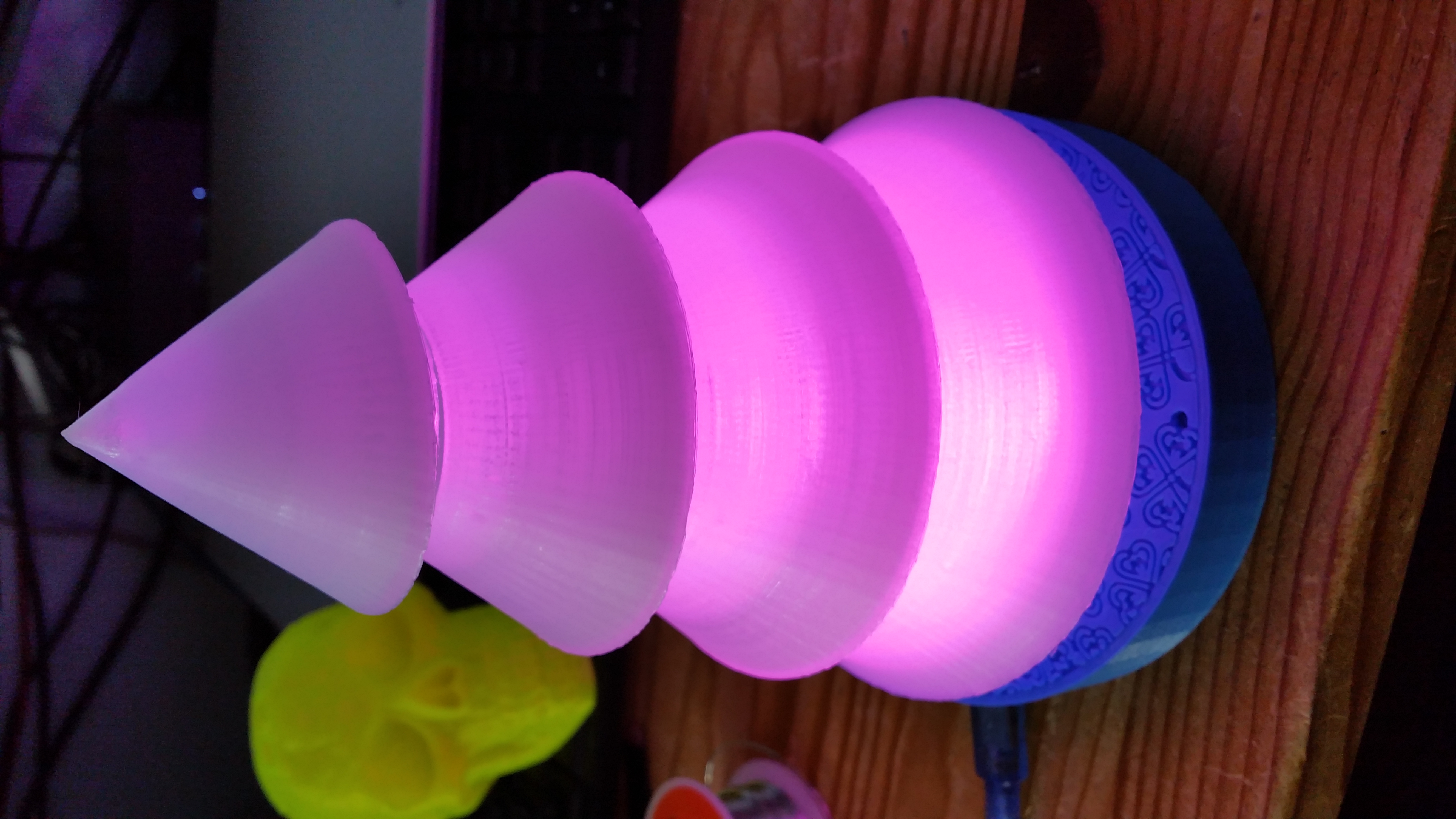

G+_Jerome Semichon Posted November 2, 2017 Author Share Posted November 2, 2017 Ken Jancef A little tinkercad later (bear in mind that stick (wo)men look just the part with my inexistent drawing skills)... How about something like this? tinkercad.com - 3D design Skully Christmas Tree v1 ? I've no idea how it'll print. I've hollowed it inside although I had to leave a board/floor to each "stage" of the tree. It's going to need some form of supports, I suspect so this could get tricky to remove. So external supports would work but not internal ones. I may have to add them manually. Or it may be easier to cut it in half, print it flat and assemble it. I've not added anything to screw it to the base either, yet. Link to comment Share on other sites More sharing options...

G+_Jerome Semichon Posted November 4, 2017 Author Share Posted November 4, 2017 First attempt at printing failed at the top of the base when the base lifted off the heated bed and started moving with the print head. Not good. Re-levelled bed, cleaned the plate, applied 3DLAC spray and restarted the print. It looks like it's printing ok now. The slicer only added supports to the outside as the angle of the tree rings is enough to self-support. We'll see what's on the printer when I wake up tomorrow morning. I've modified the base a little bit to add 2 screw holes aligned with skully's base plate. I couldn't get the 3rd hole. The base of the tree is calculated to cover all the hole in the plate - but only just. We'll see in the morning what the fluorescent transparent filament looks like. Link to comment Share on other sites More sharing options...
G+_Jerome Semichon Posted November 5, 2017 Author Share Posted November 5, 2017 Ken Jancef Fr. Robert Ballecer, SJ Skully recycled for Christmas. Minor printing mishap overnight solved with a bit of glue! I've fixed the tinkercad model if you want it: https://www.tinkercad.com/things/lgkNVscisiz. All looks good and ready for Advent. Happy kids (and me!). PS Could change the code to add more green but that's being perfectionist. :) Link to comment Share on other sites More sharing options...
