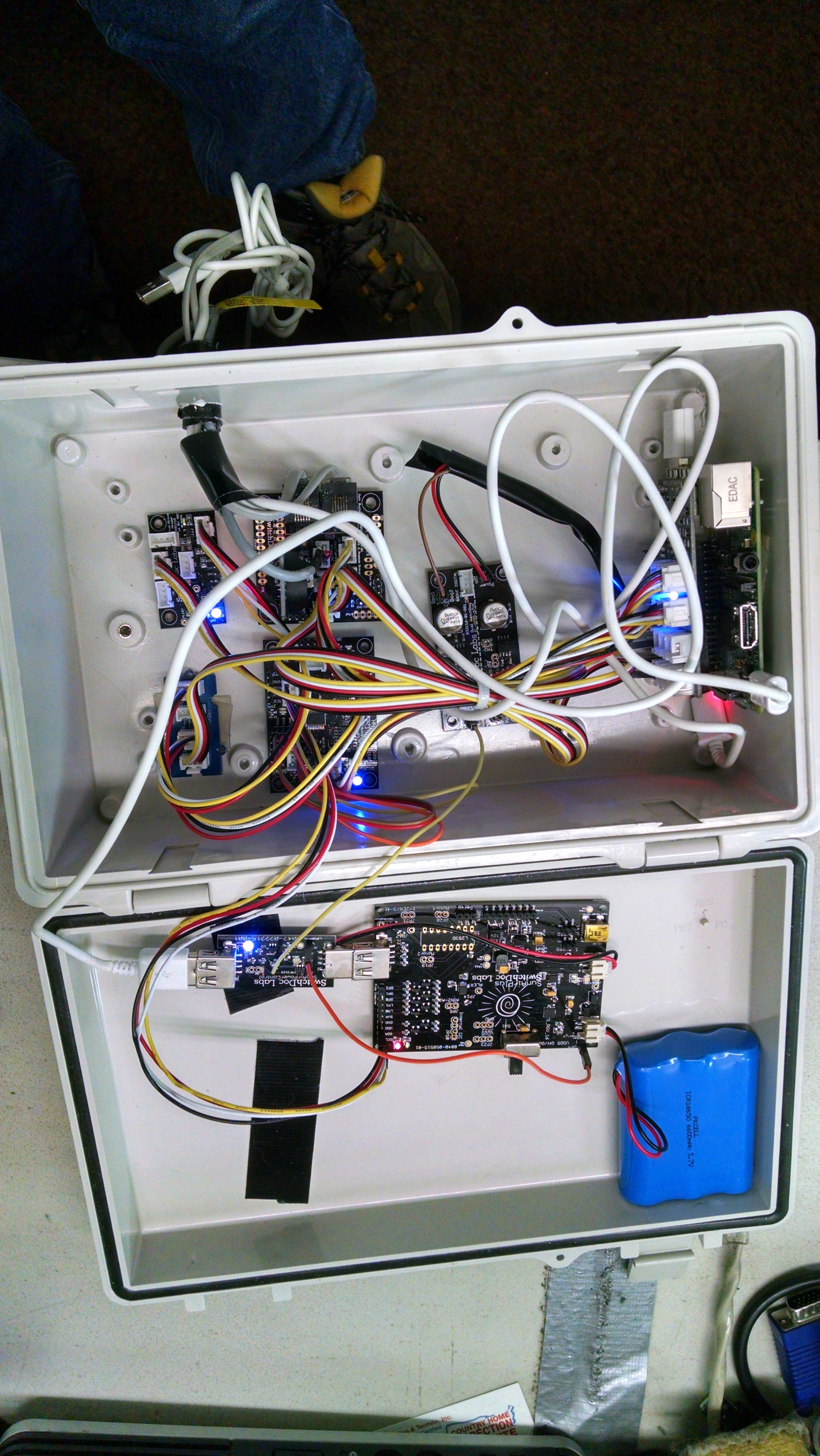

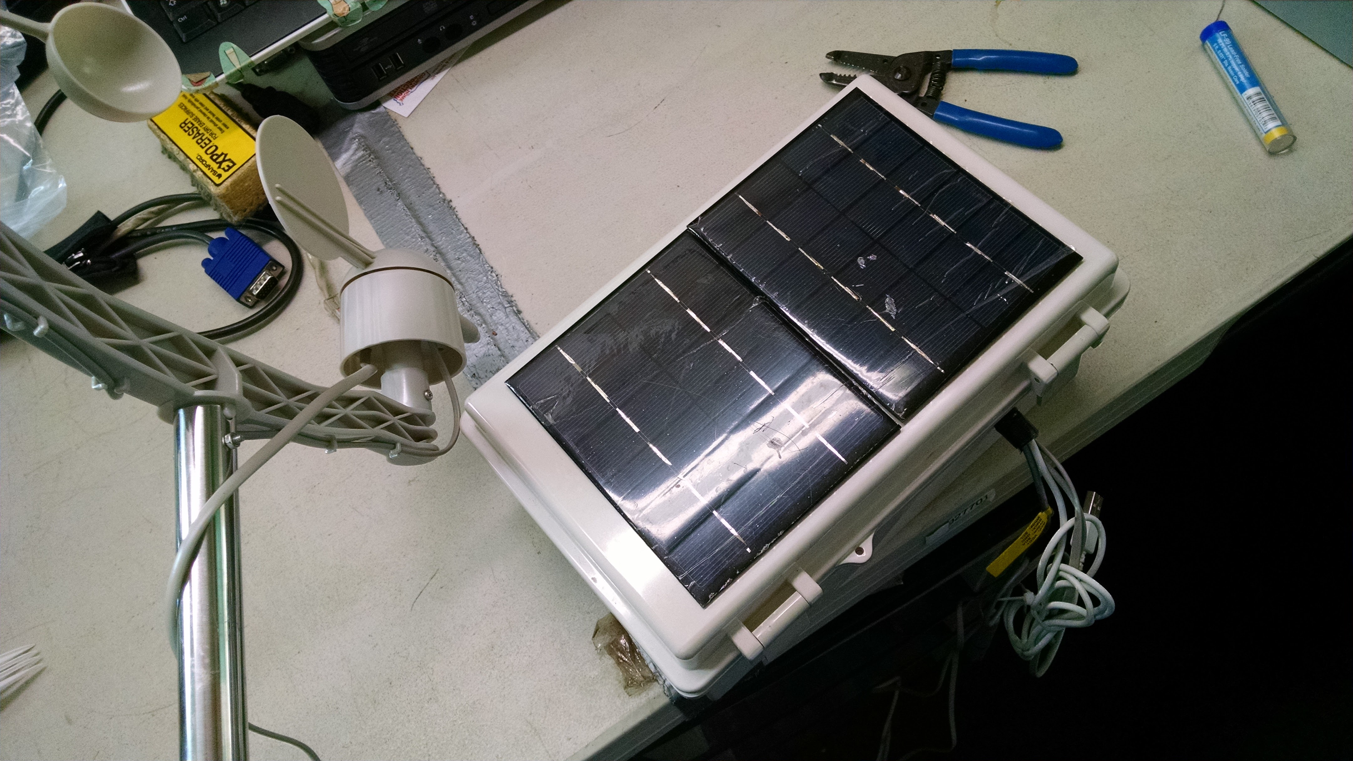

G+_Tom Dempsey Posted March 7, 2017 Share Posted March 7, 2017 So I built this solar powered weather station. Using the Raspberry Pi and Grove connectors. It all works great. Now I'm trying to configure Linux to automatically run the Python script that controls the station when it boots up. Link to comment Share on other sites More sharing options...
