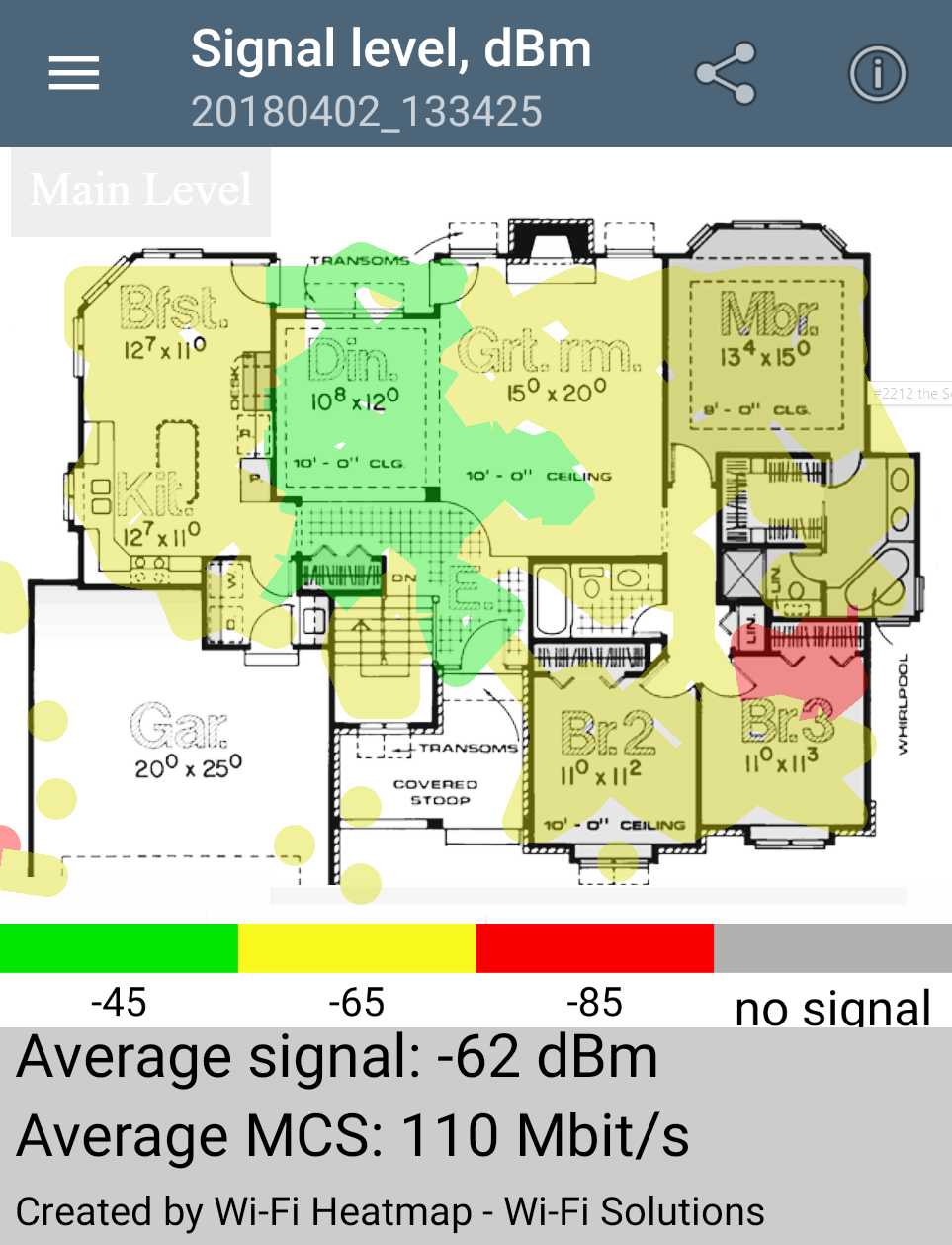

G+_Todd Barnard Posted April 3, 2018 Share Posted April 3, 2018 Ubiquiti AP UAP-AC-LITE Heatmap : Note, I did not find areas where I had no connection. This is the heatmap for my wifi. I have a ranch with an unfinished basement walkout, the AP is mounted on a floor joist pointing down approx under the x in the dimensions of the diningrm. There is one 9" steel I-beam running from the kitchen sink to the Master bath vanity. There are 2 runs of ductwork, each 8x20" next to that beam, and another 9" beam running the same direction under the closet in Bdrm#3. So finding that one corner of attenuated wifi is not a surprise and an Alexa controlled wifi outlet in that corner works flawlessly! I placed a board between the joists and set the AP on its back, pointing up, and a quick survey showed the green covering 25% of the kitchen and 100% of the great-rm with no red areas to be found. I have put the AP back in its original configuration so I can check its LED at a glance, but I will likely move the AP upstairs before I finish the basement (probably in a couple of years). Link to comment Share on other sites More sharing options...

G+_Todd Barnard Posted April 4, 2018 Author Share Posted April 4, 2018 Wifi heatmap on Google play...easier if you find a pic of your floor plan to upload. Link to comment Share on other sites More sharing options...
