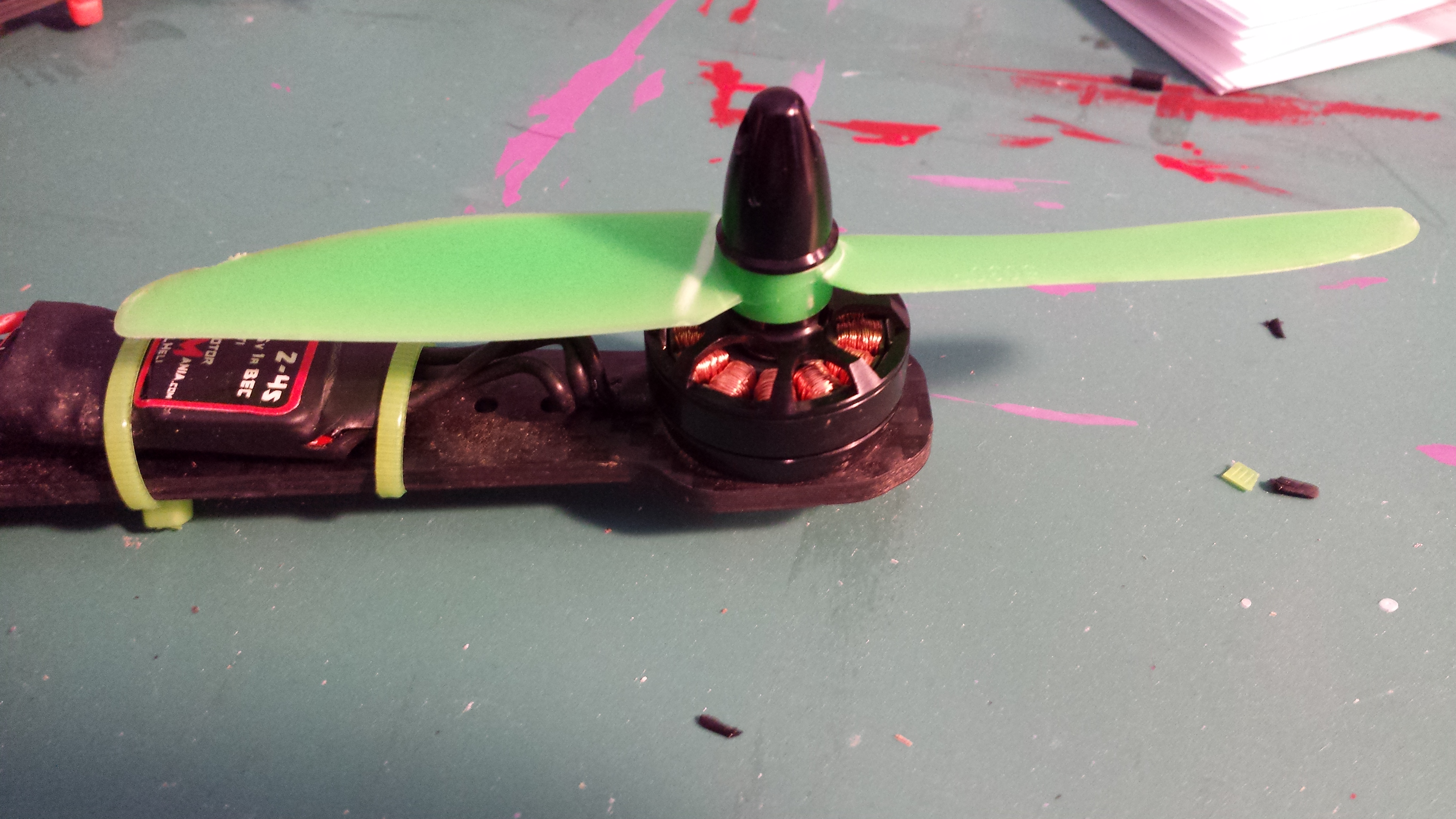

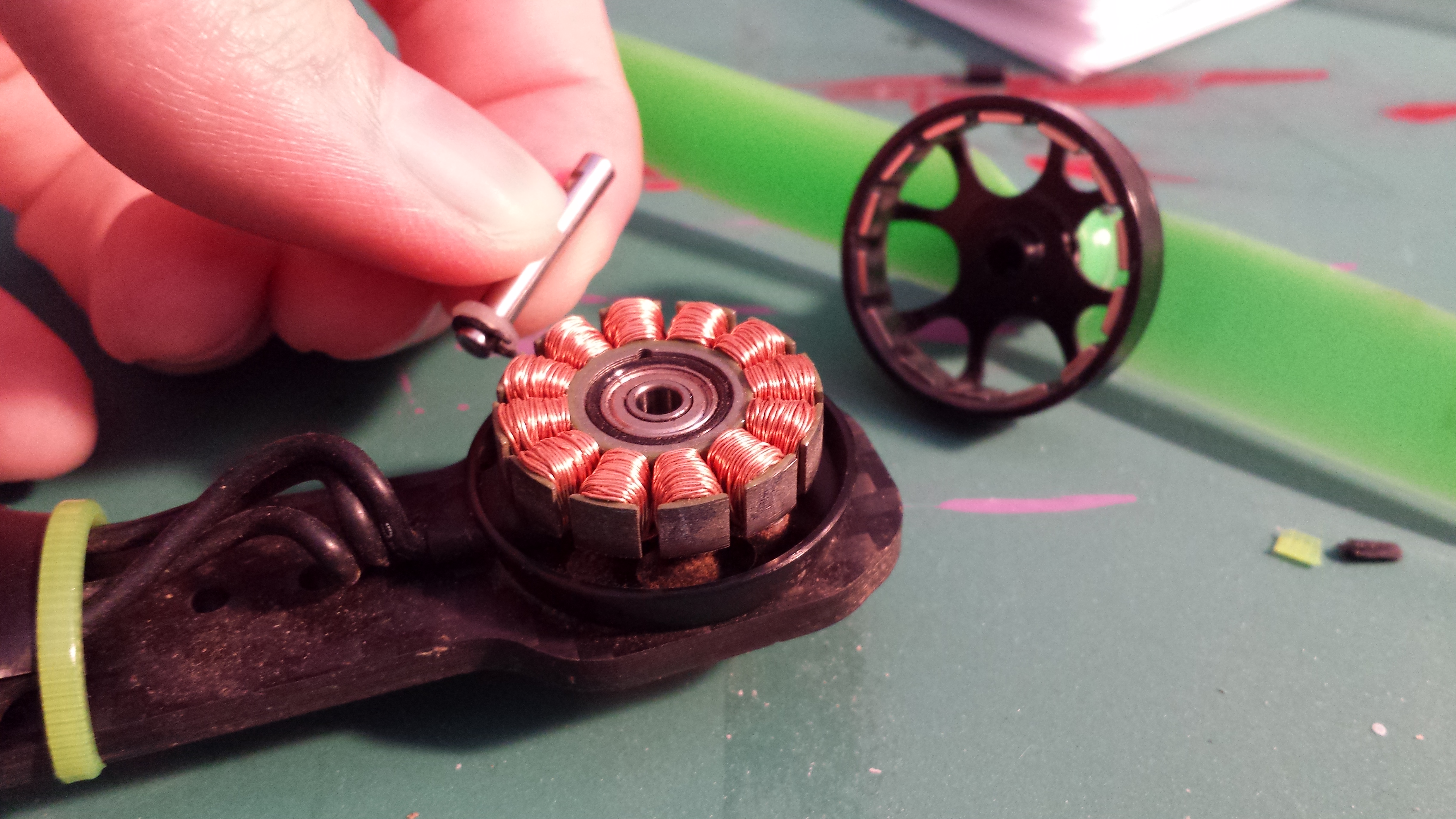

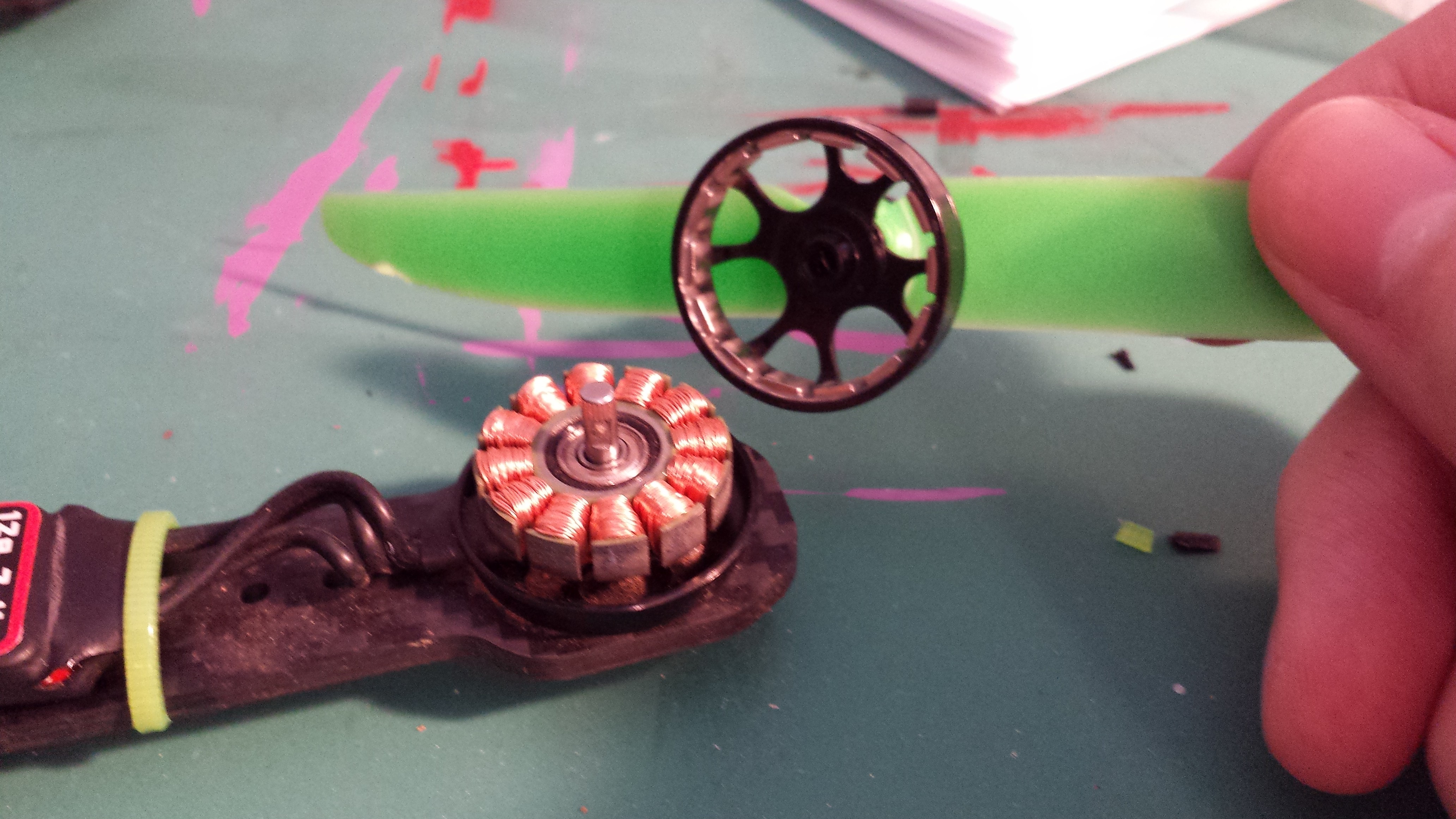

G+_Johnathan Turner (Refra Posted October 17, 2015 Share Posted October 17, 2015 So I was out flying today and my motor decided to split in half. The little c clip is still on the shaft, but it isn't holding onto the top half of the motor. Am I correct in thinking I could use a dab of glue on the end of the shaft to adhere it to the top half of the motor? Any other ideas? Link to comment Share on other sites More sharing options...
G+_Fr. Robert Ballecer, SJ Posted October 17, 2015 Share Posted October 17, 2015 There's a set screw at the top of the bell. -- Just tighten it up and you'll be good to go. Link to comment Share on other sites More sharing options...
