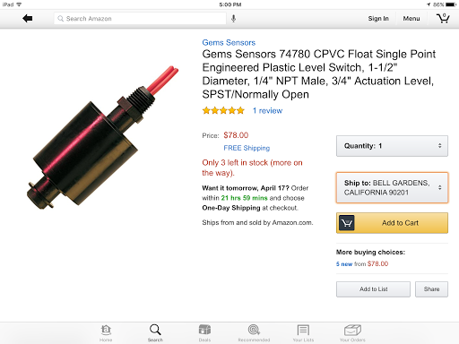

G+_Dan Baldwin Posted April 16, 2017 Share Posted April 16, 2017 KITA's: a little help needed. I built an automated alert system for our household chlorination system that would warn when the chlorine tank was low and needed to be refilled. I used a generic plastic float switch connected to a raspberry pi that would flash an LED and send an email to my phone. It worked beautifully until the chlorine/water solution ate the float! I replaced it with a stainless steel float; again, it worked great until the chlorine reacted to the stainless and not only ate the float but actually burned a hole in the plastic tank! So I need suggestions as to an alternative to a float system. The system is part of our household water supply which injects a small amount of chlorine to kill the bacterial sulphur and is filtered out through multiple filters. Thanks! Link to comment Share on other sites More sharing options...

G+_Dan Baldwin Posted April 16, 2017 Author Share Posted April 16, 2017 Damien Wessling thanks for the chart! It appears the CPVC composition is the way to go. A quick search on amazon came up with this, a little pricey though! It appears what I described as a plastic float was in fact listed as a styrofoam float, even though it had a plastic appearance. Link to comment Share on other sites More sharing options...
