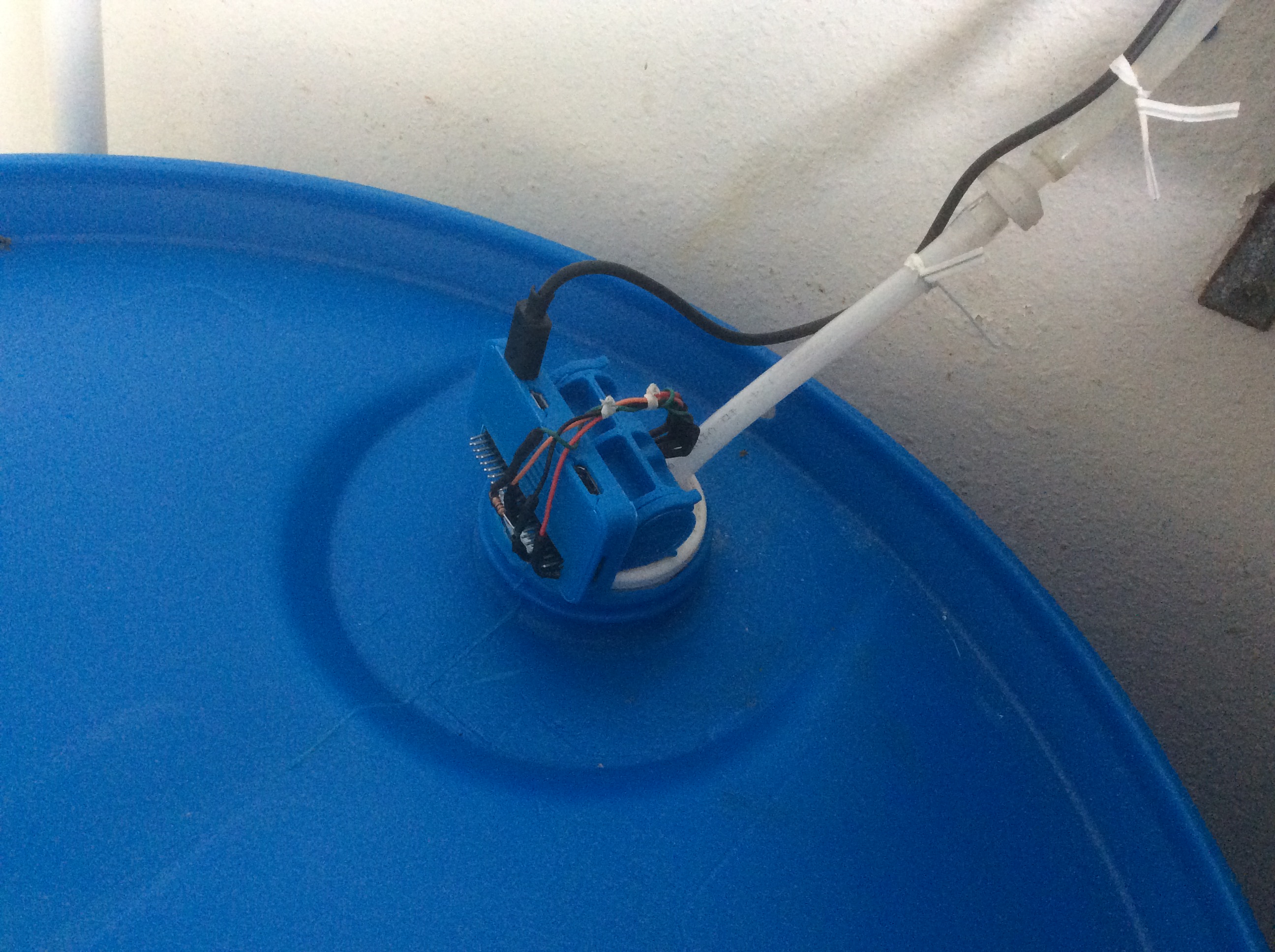

G+_Dan Baldwin Posted May 3, 2017 Share Posted May 3, 2017 Ultra sonic Hcsb sr04 sensor connected to a raspi zero w to monitor the level of chlorine/water solution and send an email to warn when level falls below 2/3 of tank volume, thus preventing the level from running empty. When above 2/3, it prints cm below the sensor every 30 seconds. Once below 2/3, it emails at 30 minute intervals to keep from blowing up my email! 3D printed cases using PLA from thingverse; kudos to the designers as they fit like a glove! Next up: to send output to a second pi being used as a home security device using MQTTool. Link to comment Share on other sites More sharing options...
G+_Peter Hanse Posted May 3, 2017 Share Posted May 3, 2017 That's cool use of PI. What is solution used for? I am looking at ways to automate and monitor my pool and this could be used for auto chemical add level monitor. Link to comment Share on other sites More sharing options...
G+_Dan Baldwin Posted May 3, 2017 Author Share Posted May 3, 2017 Peter Hanse I use this for a whole house chlorination system where it adds a metered amount of chlorine/water solution injected into the house supply side then gets held to in a holding tank to kill the sulfur bacteria, then filtered out using charcoal tank filters and whole house filtration system before being used in house. Link to comment Share on other sites More sharing options...

G+_Dan Baldwin Posted May 4, 2017 Author Share Posted May 4, 2017 Jason Perry I've purchased a arduino uno and several versions of the esp8266 to "self learn" (no formal education) although ive had success getting them working I do have a hard time wrapping my head around understanding them. It's frustrating to say the least to many languages trying to communicate between the various devices. My goal is sensors and actuators that all report to a central device with a control panel some purchased some put together. Cost of the new pi zero at 10$ seemed like a good choice. Link to comment Share on other sites More sharing options...
